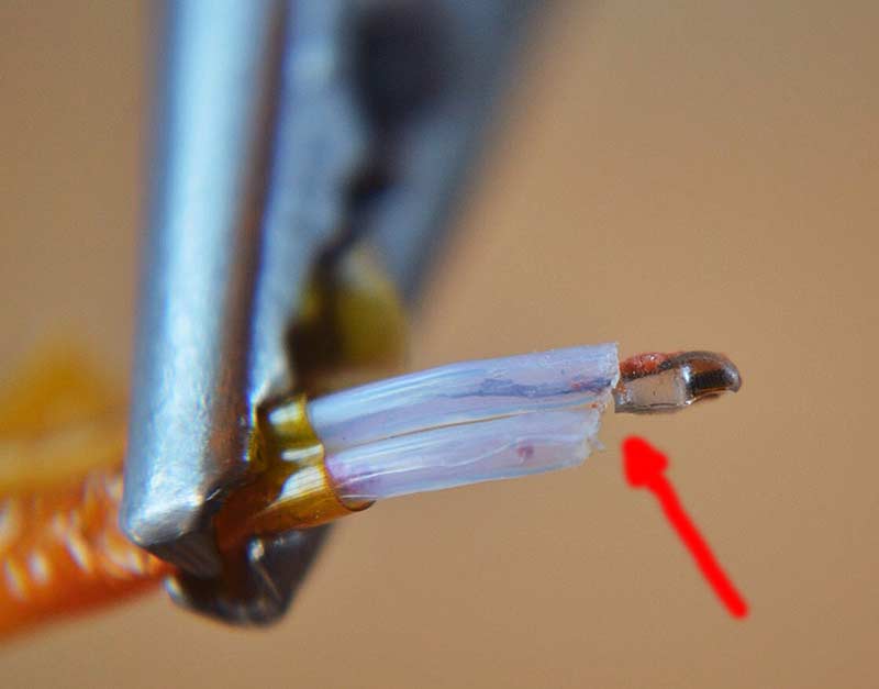

UPDATE: Took apart the hot end and removed the RTV from the thermistor to find that one of the leads had broken loose. Apparently the RTV was holding it in place until heat was applied and then it no longer made contact. Ordered up a few spares and will update again when I have one installed.

This is where mine broke...

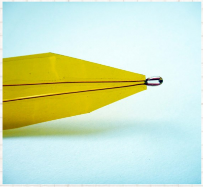

if your going to use that style, i sugest insted of the tubing, just spread the leads, and use kapton tape

bubbasnow wrote:if your going to use that style, i sugest insted of the tubing, just spread the leads, and use kapton tape
Good idea. I was just following the documentation since it was my first printer build. Figured it would be easy since I've assembled over 12 RC Helicopters... Problem is my big hands with little parts!

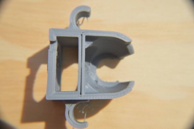

Just an update on the thermistor problem... got my new one from SeeMeCNC and installed it with the kapton tape method. Everything going smoothly and first prints look very promising. Other than the PID autotune with the new PEEK fan installed, PID autotune for the bed, the proper Z-height and horizontal radius set, the filament extruder steps per mm and the filament diameter inside slic3r, are there any other settings I should be looking at calibrating? I've used the ABS preset and bumped the heat up to 230 from 225 and have seen much better prints but I still notice a little separation between passes on some layers, specifically the PEEK Fan.
Still getting that little line between the walls of the PEEK Fan...
bubbasnow
Posts: 1061
Location: Dayton, WA
Re: Rostock V2 thermistor fail
Post by bubbasnow »
ensure you dont have any drafts and kick it up a little bit more
Posts: 5359
That little gap is a slicing issue. It does it to me as well.
