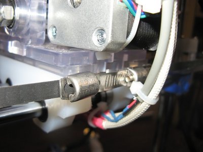

Here is a pic of the belt adjuster<br />works pretty good.
works pretty good.

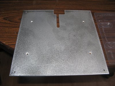

But here are some pics of the start of the MK1 heat bed mod and sprung table.
Got some insulation and tempered glass cut for the top, wish the glass was a little bigger, but oh well.
Here is the AL plate notched out for the thermistor and power connections

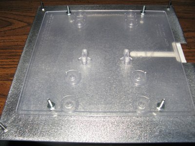

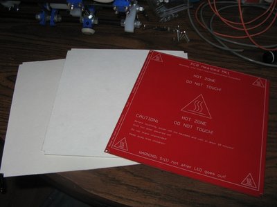

Here is the heat bed and insulation I cut out.

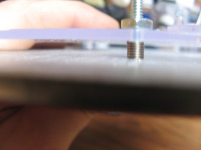

Here it is with the adjuster bolts and insulation and heatbed bolted together, have to trim out the insulation and trim the outside bolts
Here is the spring setup, I will release them a bit. But the whole shebang is only .475 thick with them released a bit.<br />I used 6/32x1 countersunk screws and the heads are epoxied into the AL plate.<br />The height is not an issue as I gained travel by changing out the bent all threads, still more than stock H1

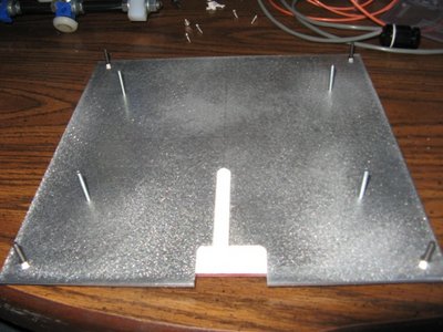

Hers is the bottom all bolted together, will probably print up some thumbwheel adjusters as a first project.

Wow, how thick is that? I am using some glass filled paper insulation, a couple layers. The AL. plate sits about .25 off the original bed, I might tape another layer or two under the AL. plate aove the stock table.
Happy Easter Everyone!!
Re: JT's H-1 build log and mods
Posted: Sun Apr 08, 2012 11:43 am
by mhackney
Happy Easter to you too!
What are you asking about "how thick is that?" The overall hot bed is .4" thick overall. But it is mounted on 1/8" standoffs that takes off another .125". When I remove the original table, I'll recover that.
I was looking at the glass filled paper. Did you get that at McMaster? I am thinking about using this: Wet-and-Stick Fiberglass Fabric. That way, it would conform to the nichrome and help hold it in place against the aluminum top plate and complete fill the 1/8" space with insulation. I wish they would publish the R values for these insulations.
