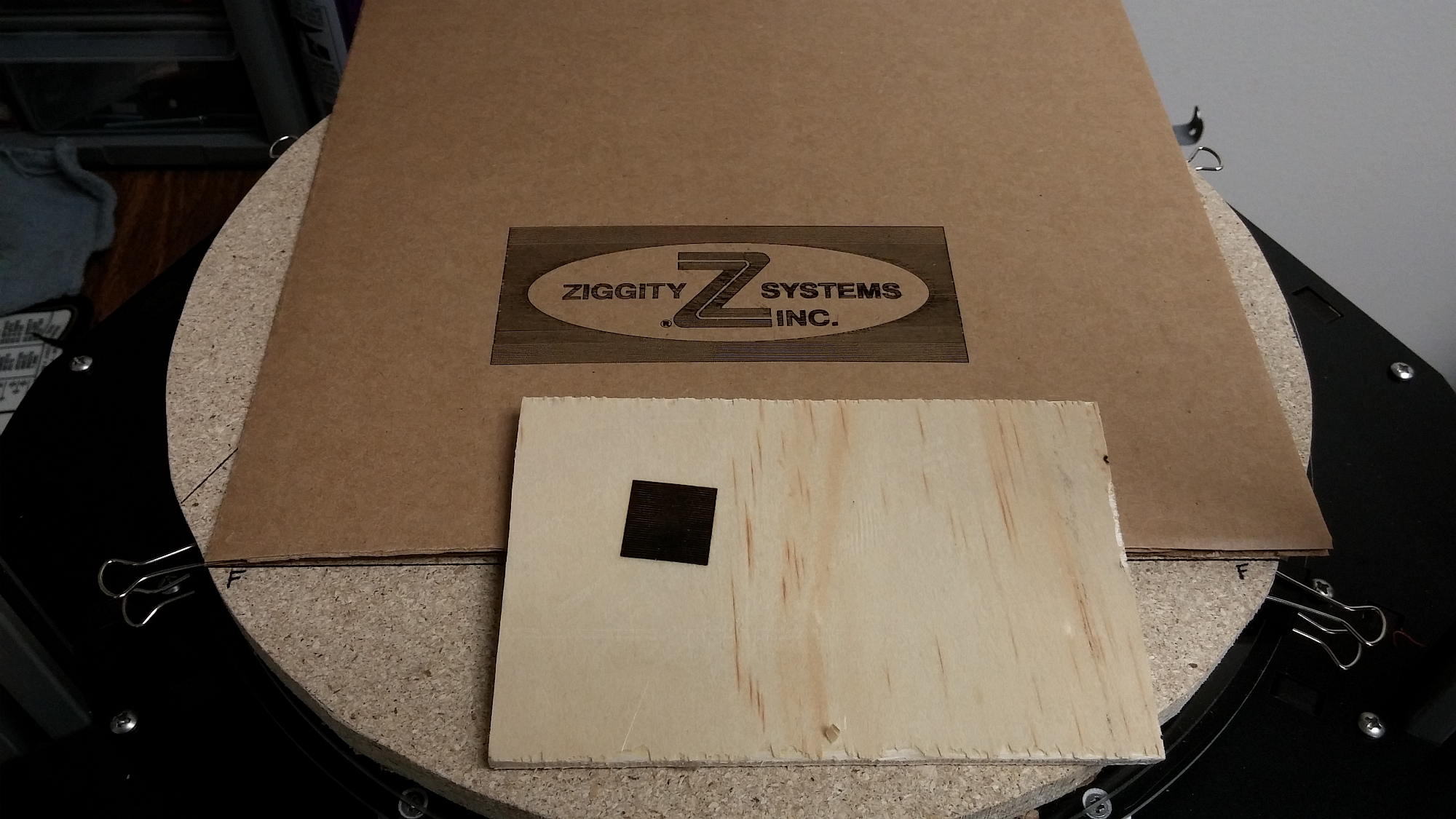

Soooo...I've been away from my laser for a while. Next up on my list was to figure out how to engrave a filled shape as opposed to only engraving the perimeter of a shape. Doesn't look like I can do it as easily as bubbasnow (linuxcnc) but I got a couple successful attempts. I'm basically just filling a shape with hatch lines via the Eggbot "hatch fill" extension for Inkscape. With it I can control the density of the hatch pattern. My first test was the small square on wood. It came out rather nicely since it was an easy shape. The second test was a logo. It didn't come out as well since it was more complex. I think the amount of nodes that one has on a shape affects the hatching in some way. Regardless, it filled it. Just not the way I liked it. More tests.

heathenx wrote:Soooo...I've been away from my laser for a while. Next up on my list was to figure out how to engrave a filled shape as opposed to only engraving the perimeter of a shape. Doesn't look like I can do it as easily as bubbasnow (linuxcnc) but I got a couple successful attempts. I'm basically just filling a shape with hatch lines via the Eggbot "hatch fill" extension for Inkscape. With it I can control the density of the hatch pattern. My first test was the small square on wood. It came out rather nicely since it was an easy shape. The second test was a logo. It didn't come out as well since it was more complex. I think the amount of nodes that one has on a shape affects the hatching in some way. Regardless, it filled it. Just not the way I liked it. More tests.
I recommend using a slicer if you want solid infill.

I wasn't able to control the rapid feeds with a slicer. In other words, I can't turn off the laser when it's doing a rapid feed and then turn it on again when it's ready to burn a path. Have you managed to do this? What slicer do you use for your laser? I was using Repetier/Slic3r.
Update: Alright, so I'm trying a slicer again. How do you prevent the EZStruder from running while the laser is running a job? I suppose I could leave it running and just pull out the filament.

heathenx wrote: Update: Alright, so I'm trying a slicer again. How do you prevent the EZStruder from running while the laser is running a job? I suppose I could leave it running and just pull out the filament.
The easiest way is to just unplug it from your controller while your controller is turned off. Another way is to use a regular expression to remove all EXXXXX statements from the gcode.
The Smoothieboard x5 uses two different gcodes to distinguish between laser on and laser off.
Here is how Smoothie laser control works : G0 and G1 are exactly the same command, they take positional parameters ( X10 Y5 Z3 for example ) and move the tool to that position.
The only difference is that when using G0 the laser stays off, and when using G1 the laser is on, only during movement.
If there's a slicer that uses G0 and G1 correctly, then that's ideal. Another way is to change each line that has an extrusion (EXXXXX) gcode to G1 and the rest to G0.

Ah, I see. Slic3r uses all G1's. Let me play around with the G0's for the rapids. I could be wrong (probably) but it looks like my other slicers use G0 and G1 properly. Thanks for the tip.

I tested the CraftWare slicer and it uses the correct G0/G1 Gcode. KISSlicer only uses G1.
The SmoothieBoard follows the G0-off/G1-on in the laser cutting profile. If you are using something else, you can automatically prepend "M104 200\n" before each G1 containing an E and "M104 0\n" before any G1 gcode line without an E. (Disable retractions and z-hop for simplicity)
