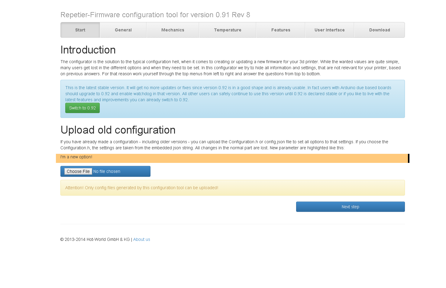

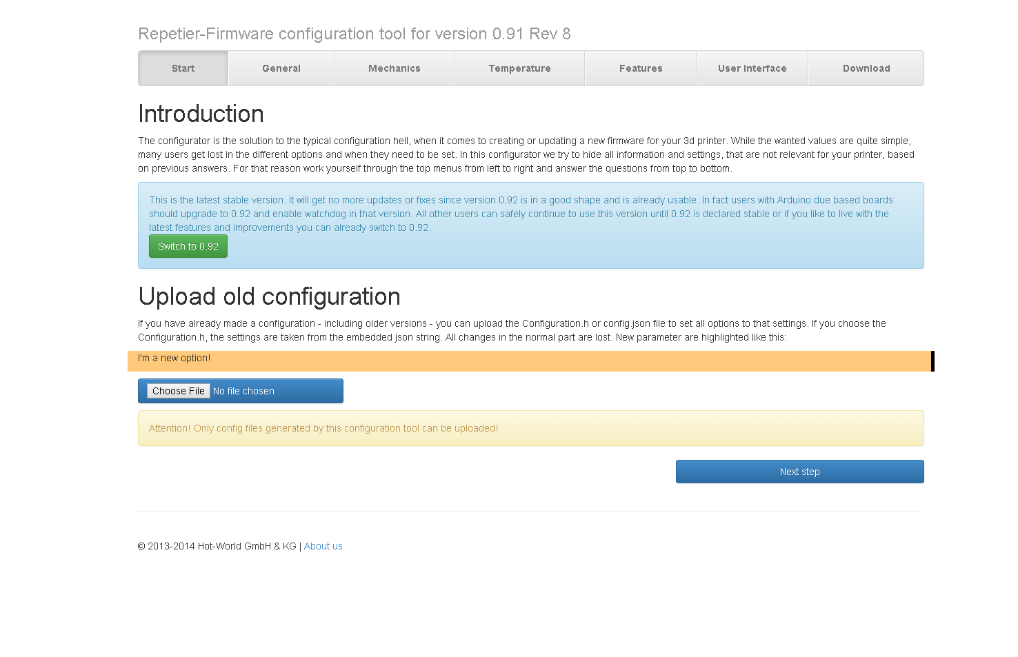

You mentioned you are using Repetier .92, could you post your configuration.h or a config.json? I have .91 and I created it with the config tool, but it won't accept my configuration file as a "file that it created" :/
Re: Introducing: Albertus Magnus
Here is my Configuration.h; I copied my settings into the web tool, it's pretty straightforward. Beware that I have changed a lot of things on my printer, so no warranty express or implied. I have also modified the software a bit so some of my changes reflect that.
start the config tool, on the first page you will see .92 linkEaglezsoar wrote:May I ask where you guys found .92 of the Repetier firmware?
I go to Repetier.com and all I see is .91 and older. THX!
It's in the GitHub repository.Eaglezsoar wrote:May I ask where you guys found .92 of the Repetier firmware?
https://github.com/repetier/Repetier-Fi ... ee/work092
