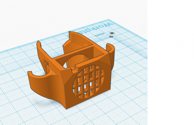

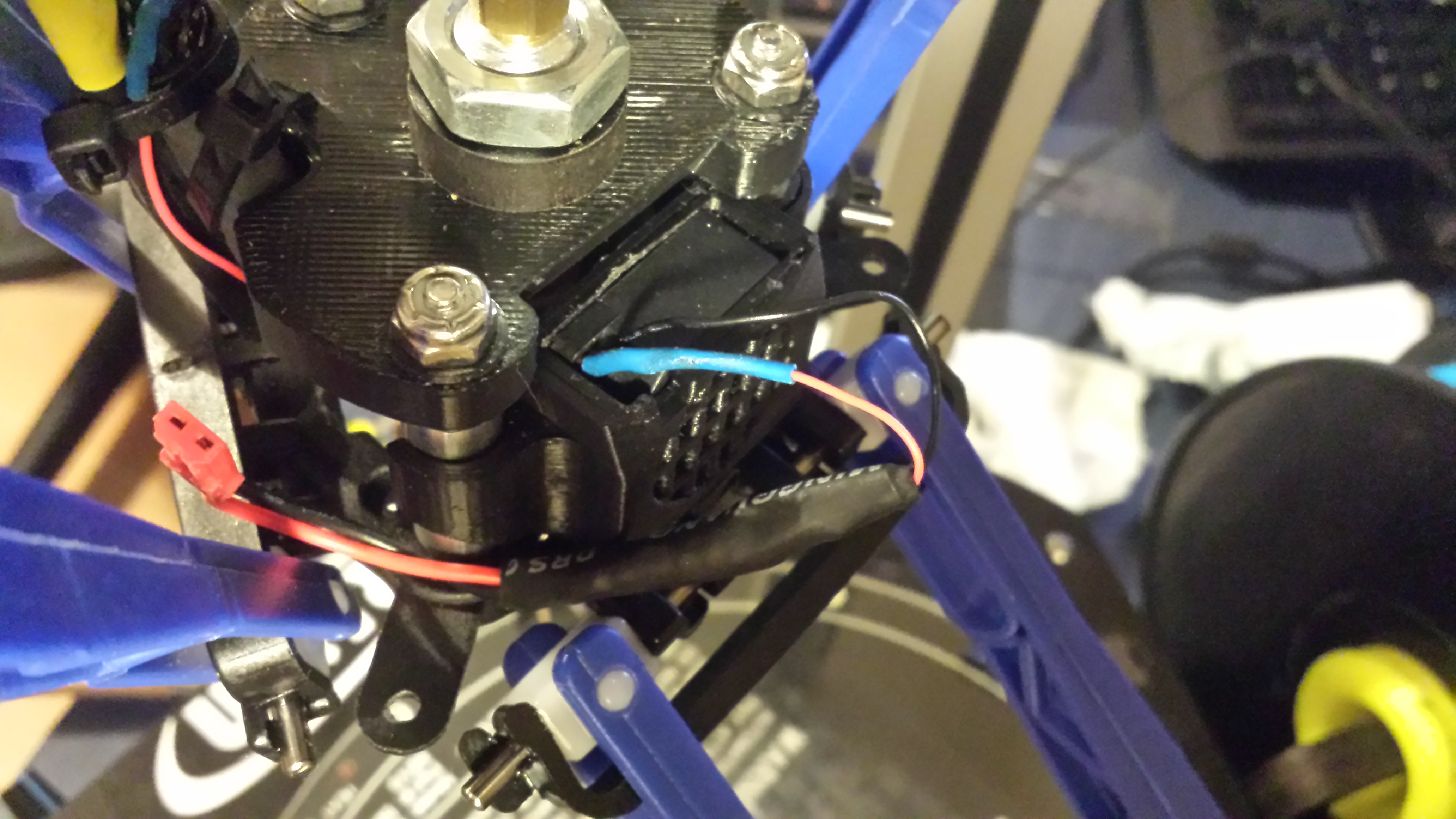

If you want to get up and running designing stuff then
https://www.tinkercad.com/
Overall it's ruined a bit by being cloud based but it's as easy as it's possible to be. An open topped box of set dimensions will take under 30 seconds if that. Download it as an STL and load it into repetier /slice/print... easy.
There are basic tutorials on the site.
Drag box into workspace... set its dimensions.. drag another box into the workspace .. make it slightly smaller but maintain its height dimension and increase it's height off the floor by a few mm, change it to a hole and align it X/Y using the ruler tool or by eye, select both objects and combine the two and there you go.. open topped box. Click download as SLT and your good to go.
It's limited but being creative you can create extremely complex objects, best of all it's ultra quick and very easy to just play with.. I find in most pro software you have to know what your aiming for right from the start. I don't im more a general idea and just see where it goes atm.
I find trying to edit existing objects a good place to start, I personally imported the SeeMeCNC peek fan into Tinkercad and added a fan grid to the back of it with no experience of 3D modelling in about 20 mins or so.. now it would take 5 if that.. found it pretty easy actually. Above Item in tinkercad one of the first things I ever done outside of some initial acclimatisation session before my printer arrived .. below the item printed out and in use on the Qrion... People can get snobby about tinkercad I suppose but at the end of the day it was quick and easy... the part does the job.. my printer doesn't care which software the item was designed in
So don't get disheartened the full on CAD stuff has a steep learning curve. Designing stuff that prints easily takes practice and experience, I'll bet most people with more experience than us had exactly the same issues to begin with.. even experienced moddlers have to get used to designing with "printability" in mind...
So start simple and small and build up, easy to get carried away in your head
. Personally I'm just learning Freecad to be a bit more respectable and when you do know what your doing complex mods are quicker
