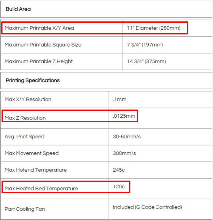

***I took another glance at the RMAX V2 Spec Sheet.***
And you know what? They ARE scammers.
Abso-lute-ly.
They gained an unfair market advantage by publishing a false spec sheet. Here, take a look below:
Those are off-the-charts specs for a consumer 3D printer. That sheet is what many industry outsiders like myself use to make purchasing decisions. That spec sheet at a $999 price point makes the RMAX 2V the no-brainer choice among the barrage of 3D printers out there. Only it is less than truthful. Until I’m convinced most users can print reliably to the 11” line, I say SeeMeeCNC was deliberately deceitful. And why is the 11” spec absolved from needing to be met by the manufacturer in your minds anyway? I designed a part that needs to nearly touch the 11” edge. I can’t print it, and from the looks of it, maybe no one who has posted on this thread can either. What if only a small fraction of the users could get their nozzles up to 245 ºC? Would that be alright too? What if only a small fraction of the users could get the bed to 120 ºC? Oh wait… I think that one may also be a lie. I’ll try to check tonight to confirm. Who knows, I may get the pleasant surprise that my printer bed can reach 120 ºC… after 6 hours, without the build glass on it, and me not even breathing near it. Yes yes, very practical. Hmm… let’s see, a .0125 layer height... Quite possibly the only FFF printer in the world that can achieve this awesome feat. Only it is not reliably verifiable. Who here has ever printed to a layer height of .0125 on their RMAX V2? Raise your hand please. Do we see a certain pattern here? I see a pattern of intentional deceit.
radicaldev wrote:It takes balls to do what they did
No doubt about it. I’d be too scared about class actions to try to pull this Spec Sheet stunt. It was deliberately and unnecessarily deceitful. No excuses. They could have competed honestly and fairly with the other up-and coming "experimental" 3D printing companies. They simply chose not to.

That doesn't say "Highest quality" or "Lowest layer height" like most printers advertise, that says "Max Z resolution" so thats not a lie. It very well can move the effector up .0125mm at what the firmware considers the z direction. And you could print at that if you had a small enough nozzle, as demonstrated by people on the Ultimaker Forums, and I think Generic Default made a really tiny nozzle to print M6 threads.
Max heated bed temp is the safety margin, the bed can safely reach that temp without catching fire. On most kits that can't reach that temp, its not the bed limiting it, its the power supply. Unfortunately, that one is a little more difficult to quantify, but I'm not disagreeing with anyone that SeeMe should include a much more capable PSU with their printer.
Comparing the Rostock MAX to the Ultimaker is honestly kinda unfair. Consider the age of their product, and the location. Ultimaker is based in the Netherlands, much closer to the heart of the RepRap project, and their Ultimaker has existed since 2011 (if Wikipedia is right on this one, which I sort of doubt in this case since the mentioned Darwin and 2011 to be around the same time period, when Mendel/Huxley was closer to that time period). Theres been a lot more people to pick up on that design and improve it considerably. While the Ultimaker "original" (as its called now) didn't undergo many significant name changes (besides loosing the protobox after a few revisions, and then adding the Original thing once the 2 came out) it underwent several significant design changes during its lifetime (at 5 years and still counting). Thats a lot of time for a design to develop and mature, especially considering location and size of the community. The MAX has been with us a year less, which is arguably not that long of a time period, but again considering location and community, which SeeMe is at a fairly significant disadvantage here, is quite a bit of time.
To add more factors in the mix, the Delta design is still a fairly "experimental" design for the RepRap community, while a cartesian design is pretty simple and has existed since the beginning (though parallel kinematics is a bit different). As many strides that we have made in advancing Deltas, they will be at a significant disadvantage until Smoothie based boards are more popular, due to their more complicated nature for the controller.
I would say $1000 for the kit is pretty reasonable, considering that even if you were to take the shortcomings in the max x-y positioning, this thing still blows the Ultimaker out of the water, not to mention that the pre Original+ Ultimakers didn't have heated beds, and they were MORE expensive. For what you pay for, its really pretty reasonable, because even after the Original+ kit came out, its still more expensive than a MAX kit.
I have nothing against either Ultimaker or SeeMe, I'm just using each as an example. I have both a MAX V2 and an Ultimaker and I love both.
The 11" thing I don't really have anything to say, maybe they were thinking it averages to around an 11" diameter (it can do a sort of rounded triangle shape), maybe they just rounded up. It seems to be the practical build range is something like 10-10.5" if you build your printer correctly. I can't get out to that range because of reasons that aren't in SeeMe's control. To name a few, this Kraken seems to make my printer a little more clumsy, and I didn't have a digital angle gauge to properly (and accurately) square the towers like KAS, but if I were to solve these issues I'm sure I could get out to the magic 10". Again, not the fault of SeeMe that I assembled my printer with birch ply and an old and rusty framing square.

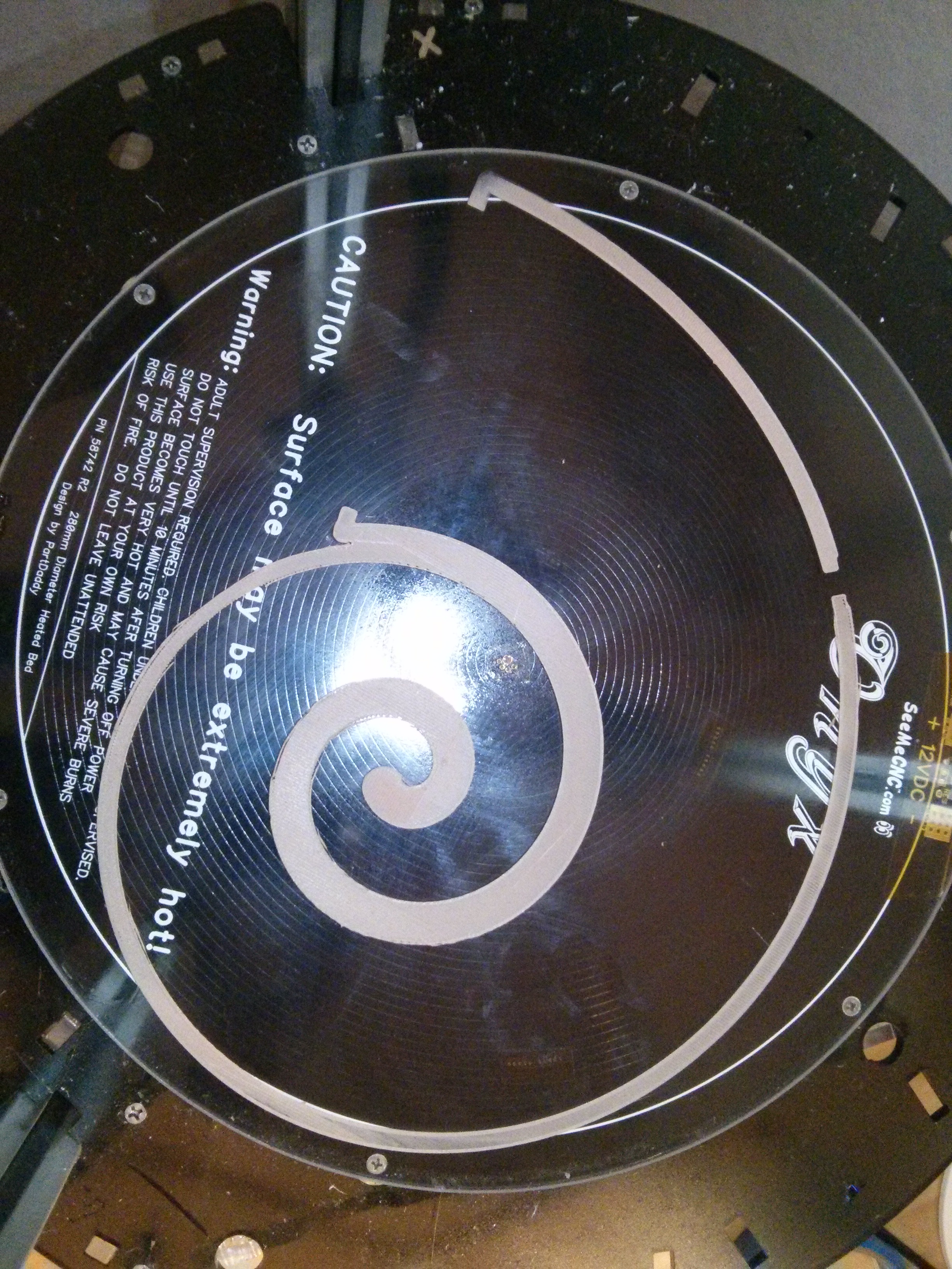

I just tried a 280.4mm x 10 mm strip 1 mm high in PLA. It printed it just fine on my stock machine. So yes it can print something the full 11 diameter. I just can't print a circle of that diameter unless I modify the machine slightly. So I don't think the spec is a lie.
Any chance you want to post your model you are trying to print so others could try?

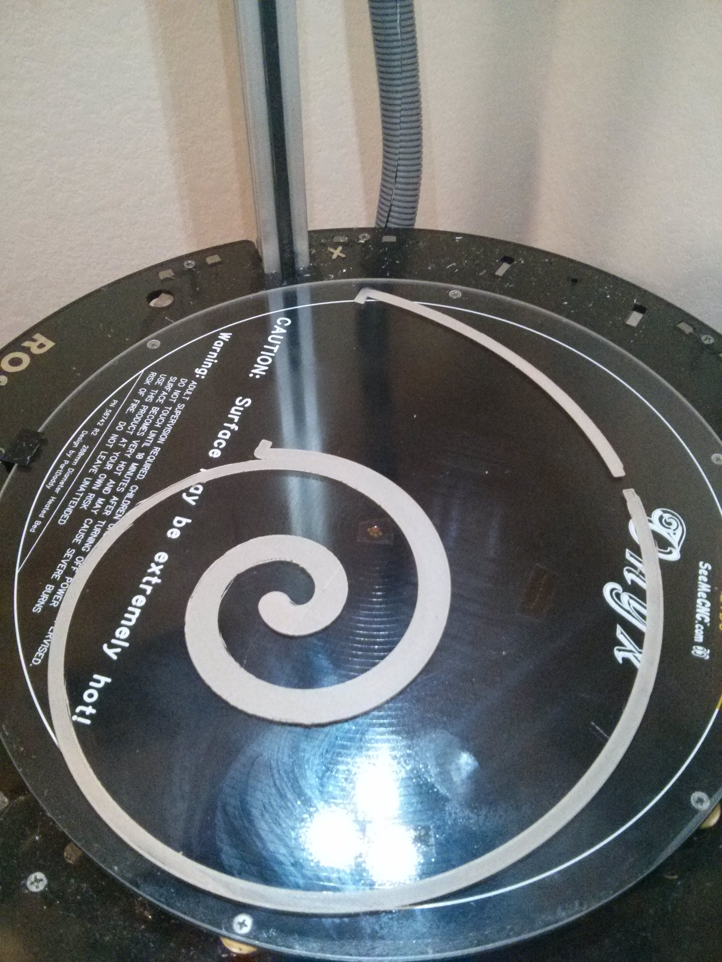

I did that like 1 year ago, using a V1. I have to increase the current for the step motors not to "fall" when printing very low. Cannot recall for sure, but I think I had to mount the hot end below as well.
Printed using my "old" V1 printer, never tried in my other 2 new, V2 Rostocks yet.
So, I think technically you can say that it can print even further than 11".
BTW, this is the final result of this print http://forum.seemecnc.com/viewtopic.php ... 898#p45301
Cheers!

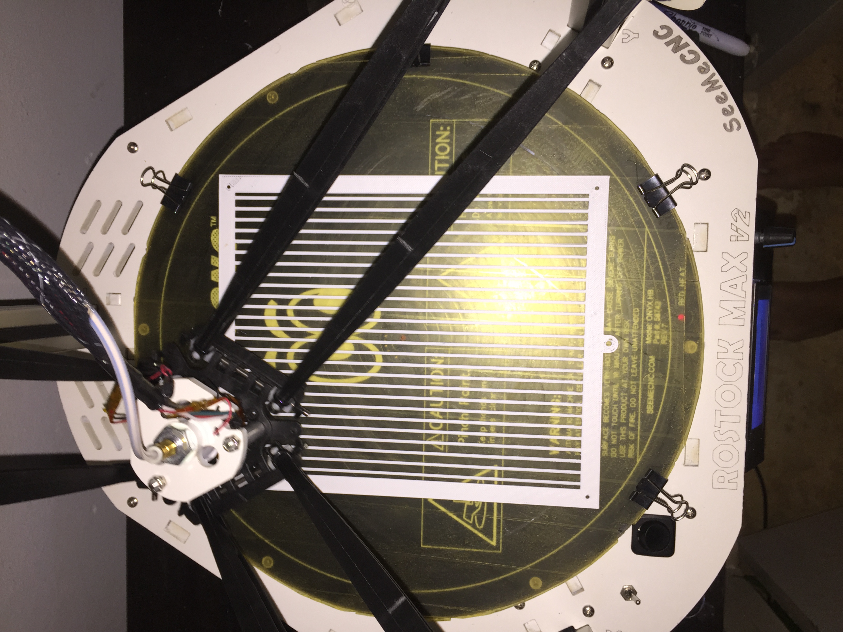

Oh my, I just lost a lengthy post just before pressing "send!!!" :x
Anyway here are the files. I'm too mad to write again. Guess we'll talk more tomorrow. Thanks everyone.
tapa fini.stl
(133.38 KiB) Downloaded 403 times

Whoa... That print taught me a lot about ABS... I could actually watch the warping going on real-time. Needless to say, that's a tough print for any FDM machine.
Posts: 2417
Location: Redmond WA
Re: Of Pink Elephants and Melamine Bonfires
Post by Polygonhell »
IMO it'd be close to impossible (I'm sure someone will prove me wrong now) to print that piece in ABS on an FDM machine without a heated chamber and I'm not sure even then. Acute outside corners like that are the absolute worst case for warping, if you had enough additional space you could add mickey mouse ears to the model or a massive skirt, both MIGHT let you get away with it. The sharp outside corner focusses the warping forces where as radiused corners tend to diffuse them somewhat. Having said that even a circle that size is challenging.
You could probably print it in PLA or PET, but even there it would be challenging. I've printed flat square pieces a little over 9 inches in PLA, but I was only getting about a 50% success rate. I gave up on printing the vertices for a Kossel in ABS because of the warping and they are probably only 6 inches long.
