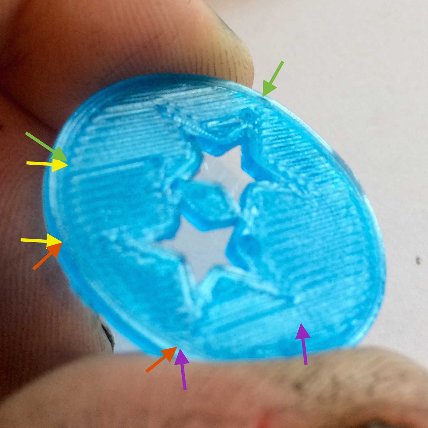

I've got a test part printing now to see how the surface finish ends up. I still need to do a lot more learning of course and maybe this is addressed somewhere now but printing 1 perimeter then going to print a perimeter somewhere else and the coming back to print the second perimeter, etc drives me crazy! I just want it to print all perimeters for each feature and be done with it. The movement involved for one at a time makes the ends of the perimeters very visible whereas printing them continuously there is very little movement and hence the ends are not blobbed or undefilled.
Ok, the test part just finished. Since your FFF has 4 top and bottom layers it ended up printing with no infill. However, the top surface a bit better but is "rough" like I've seen. You can see the difference in the different regions it fils on the top surface and the perimeters. It is tough getting a good photo but here's an attempt:
I tried to mark the start and ends of the different "regions". It is difficult to capture but you can see it best with the difference between the yellow region and the neighboring green region. This might seem inconsequential/trivial but it does look a lot worse in person and there are 6 distinct regions that are visibly different. I'll work at it a bit more and try to do a 1-1 comparison with KISS so you can see the difference. I suspect that it is due to the discontinuous way it fills in the top layer - similar to the single perimeter at a time. KISS tries to start and end all regions on a perimeter if possible - hard to describe but you can tell the difference if you watch KISS vs S3D gcode print. Perhaps there is a setting/s to be make it more continuous?

Usually when that happens with the perimeter, the openings are just too close together to print all the perimeters consecutively. It drives me nuts too. It was worse at one point but usually it doesn't do that.
Your test part looks to be over extruded from the fuzzy picture, hard to tell for sure.

Yes, I am decreasing the extrusion amount a bit and that is helping but interestingly, the first layer seems a bit under extruded compared to KISS at the same settings and turning down the amount for the top layer makes it much worse. I guess I can used a factory for the first layer only. I can tell this on parts that I do my special "engraving" stuff on to customize the reel. The engraving is .6mm wide and .6mm deal. When the flow and layer height are right on, I get nice crisp openings. If too much, they get filled in a it and if too little they are too wide and usually have gaps.

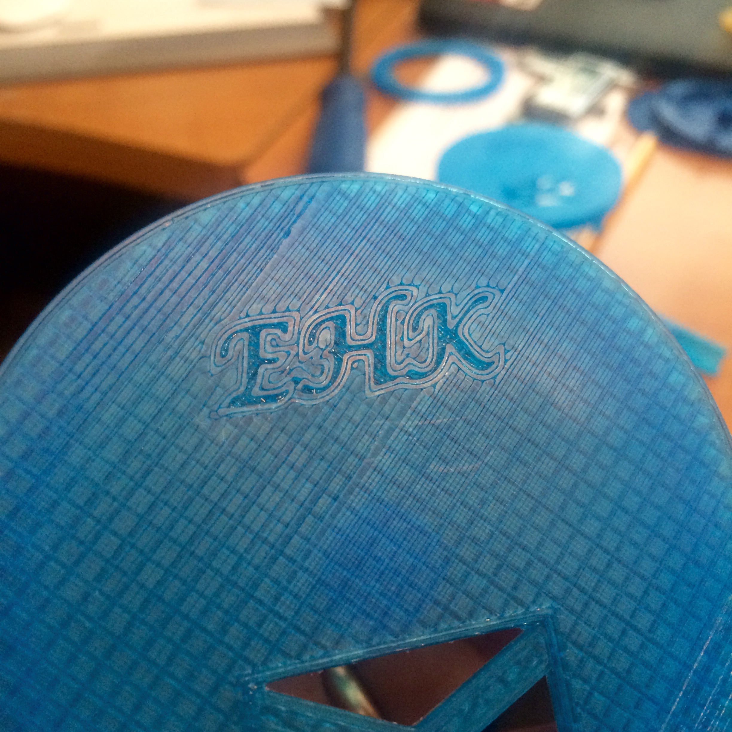

Here is an example of my "engraving" technique:
This is where first layer height and dead-on slicing parameters is critical. This first layer is just ever so slightly undefiled as can be seen by divots at the tops of the letters. A little tweak here with a special first layer factory should close those. This is quite a good embossing that rivals what I can do in KISS>
Finally, I am struggling with "perimeter blobs" like this:
I've already trimmed them off the smaller posts where they were much worse. Some were also snapped off the center post. I have been able to eliminate these in KISS and KISS also has an interesting feature where it starts the perimeter from the inside at a 45° angle and ends it the same way. This probably has a lot to do with how clean the perimeters are on KISS gcode. I have not started to attack this problem yet in S3D but it is next on the list. Any suggestions?

Bump your nozzle temp up a bit, or maybe your retraction - those blobs are excess nozzle pressure oozing out during a rapid move.
edit- another thing to note, if your infill extrusion width is over 100%, it could also be excess pressure due to that. Under the advanced tab, uncheck "only wipe extruder for outer-most perimeters", it helps a little bit on that. I found that infill extrusion width over 150% required really high temps to keep nozzle pressures low to prevent this problem.
Check your infill outline overlap on the Infill tab - increase that to decrease the divots in the letters.
