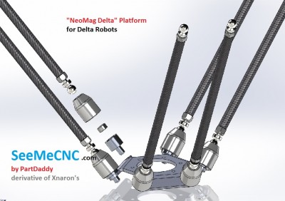

Posted: Fri Sep 06, 2013 10:31 am
by PartDaddy
I think someone mentioned this or something similar somewhere in the forum. I'm contributing this concept of how I would tackle the magnetic arms because I really liked Xnaron's work.
The ball stud is screwed into both ends of the arm rod. This allows a jam nut to secure the center to center distance of the ball studs very precisely. The rod doesn't have to be carbon fiber. Aluminum tube or even solid aluminum rod may be a better choice.
The neodymium magnets are on the platform and carriage. The magnet is adjustable in distance from the cup that receives the ball stud. There's a variety of ways you could achieve adjustable force of attraction between the ball stud and neomagnet. The attraction force adjustment is necessary to set holding force and friction between the ball stud and cup. The carriage (not shown) also has a similar magnet assembly for adjusting the magnet for controlling force/friction between the ball stud and cup. There doesn't have to be an elaborate adjustable magnet assembly. Like Xnaron, you can test, print, test, print and find a desired force and just draw printable parts to hold the magnet.
Material choice can make a big difference. Acetal is a good choice for making the cup. And a chrome ball for the stud. The drawing files are not very good and not scaled properly to be useful. I just wanted a drawing to show everyone and add to the discussion and improvements of, Magnetic Arm style Parallel Kinetic Mechanisms.
If I get the time, I will make a printable prototype version of this too and share the files on our git. Great work Xnaron!!
NewMag Delta Robot Platform Assembly
Posted: Fri Sep 06, 2013 11:37 am
by Eaglezsoar
PartDaddy, your idea is a great one. It's just so difficult for the average user to create such parts.
The Xnaron project has been posted for a long time now and I am surprised that someone has not
come up with a complete kit to offer for sale. I think a lot of it has to do with the time factor, no one
has enough time to create such kits and still "play" with the RMax.
The magnetic arms offer accuracy and the ability to add and remove effectors with ease, IMHO they
are the best of the best and represent the best mod you can do to a delta printer.
Posted: Fri Sep 06, 2013 11:59 am
by lordbinky
The ONLY thing I find as a slight issue with Partdaddy's take on the magnetic arms is the magnets are on the platform, the carriage carrying magnets is fine. One of the benefits of the magnetic arm setup is that the platform is easily swappable, and the magnets being a part of the platform either increase the cost per platform to have magnets on multiple platforms, or increased swap time by removeing the magnet/cup assembly and swapping that with the platform.
To restore that advantage in this design without going back to the original arrangement, I would like to see what people would think about methods to make swapping the magnet cup assembly faster to attach/detach from multiple platforms while staying as secure as a fixed setup.
Posted: Fri Sep 06, 2013 12:49 pm
by Eaglezsoar
lordbinky wrote:The ONLY thing I find as a slight issue with Partdaddy's take on the magnetic arms is the magnets are on the platform, the carriage carrying magnets is fine. One of the benefits of the magnetic arm setup is that the platform is easily swappable, and the magnets being a part of the platform either increase the cost per platform to have magnets on multiple platforms, or increased swap time by removeing the magnet/cup assembly and swapping that with the platform.
In the PartDaddy design it appears that the magnet is not permanent to the platform, in other words you can remove the magnets and place them on a different platform
without too much time or difficulty. I don't think you would have to buy new magnets for each platform that you have.
Posted: Fri Sep 06, 2013 2:10 pm
by lordbinky
AH! I see it now. The cup doesn't have to be affixed to the platform stud if it is metal. Thank you eagle. In case anyone else has that same issue I made a cheat sheet, blue is metal, green is the magnet, purple is the low friction material.
Posted: Fri Sep 06, 2013 6:02 pm
by Flateric
The disadvantage of having the magnets mounted rather than on the arm and the added hardware this also adds I discovered early on in my initial unsuccessful tests before Xnaron was successful with the use of more powerful magnets.
The magnets need to be of the cylindrical type to really be effective and keep the strongest magnetic attraction in an even consistent manner through the entire movement. I had initially tried ball shaped magnets that were very strong but had a extra strong sweet spot that introduced subtle but noticeable irregularities in movement in the final print. Waves is the best way to describe it.
I also had tried hemisphere magnets in steel cup to focus the strength of the magnet in one direction. This made the above problem even worse.
Being that the magnet is shaped like a cylinder it seem logical and easiest to attach the arm and magnet which also allowed for the least amount of hardware to make this connection happen and keep the cone of magnetic force aligned to the ball it was rotating on best aligned at all times. Also the cylindrical shape of the magnet allows a larger magnet and the additional strength of a larger (longer) magnet to be used without affecting the height from carriage to ball (when magnet is mounted on carriage or effector) to be increased. Which also would lower build height and increase the effectors weight and the costs if you had multiple swappable effectors. Since small chrome balls will always be cheaper than strong cylindrical magnets (especially when they a longer in length than the diameter of the ball which is kept small for weight considerations)
Even longer and stronger magnets may be used while keeping the stock arm length of 269mm by simply shortening the arm length to accommodate (leaving the firmware untouched, something that was more important than nowadays with version 0.90 of repetitive soon too be released which allows adjustment within the host and no exit and reef lashing)
And finally one of the biggest goals on top of all of the above concerns from the very start was to make the project as accessible and as cheaply constructed as possible for anyone without any special machine tools or skills anywhere. My current and favorite arms are currently just carbon crossbow bolts cut to length, with cylinder magnets at the ends and then small nylon cups that Rona and Home Depot sell as snap caps in their hardware nut and bolt aisle for 0.12 cents each. This assembly is all bound together with Kapton tape and then given a good but thin coating of silicon (plumbers goop is the brand I use)
The nylon cups are chosen because they are the easiest, fastest, and most consistent way of creating a none slip cups shaped surface that retains the balls with almost no friction. But the biggest feature is the consistent size they provide. Makes all of my arms exactly the same with no variation in length or friction to mess things up.
Just thought I would add more to the discussion and some of the thinking and testing that happened before the resulting successful magnetic arms.
