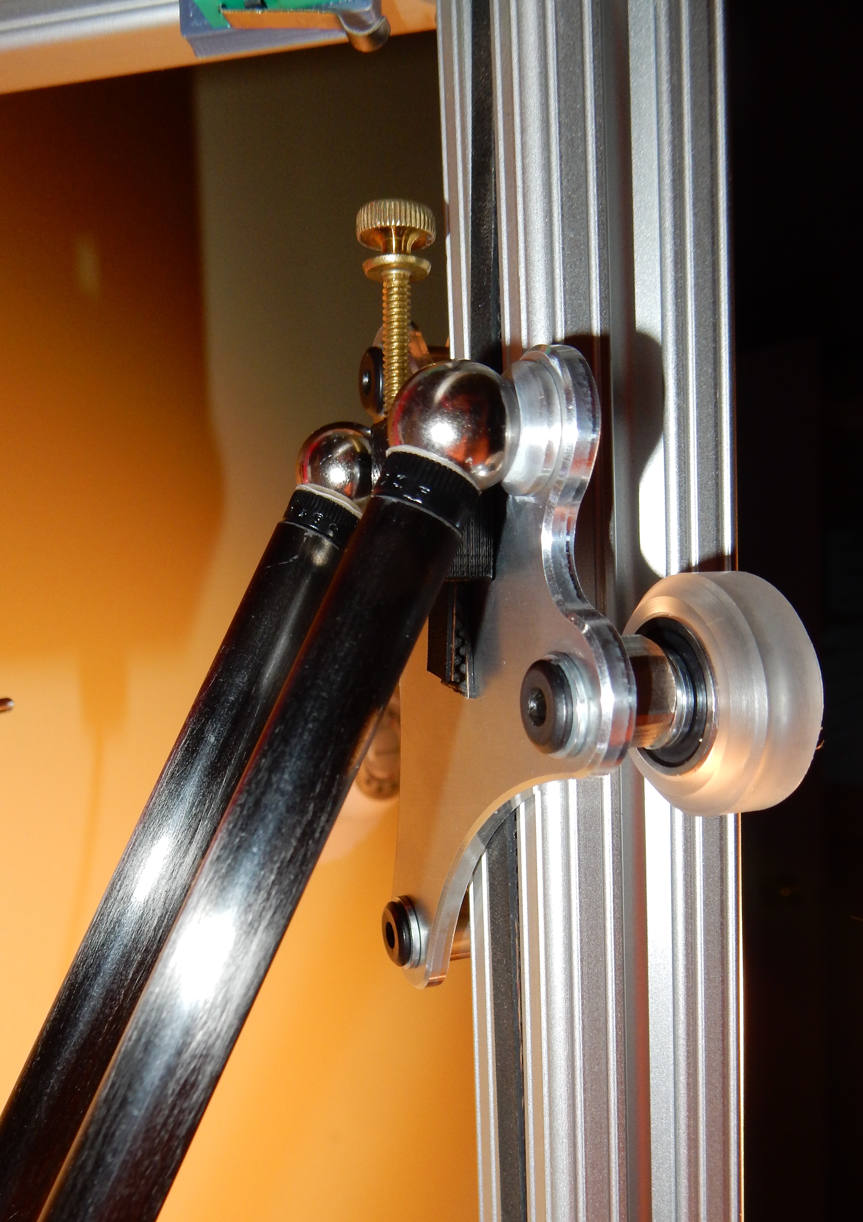

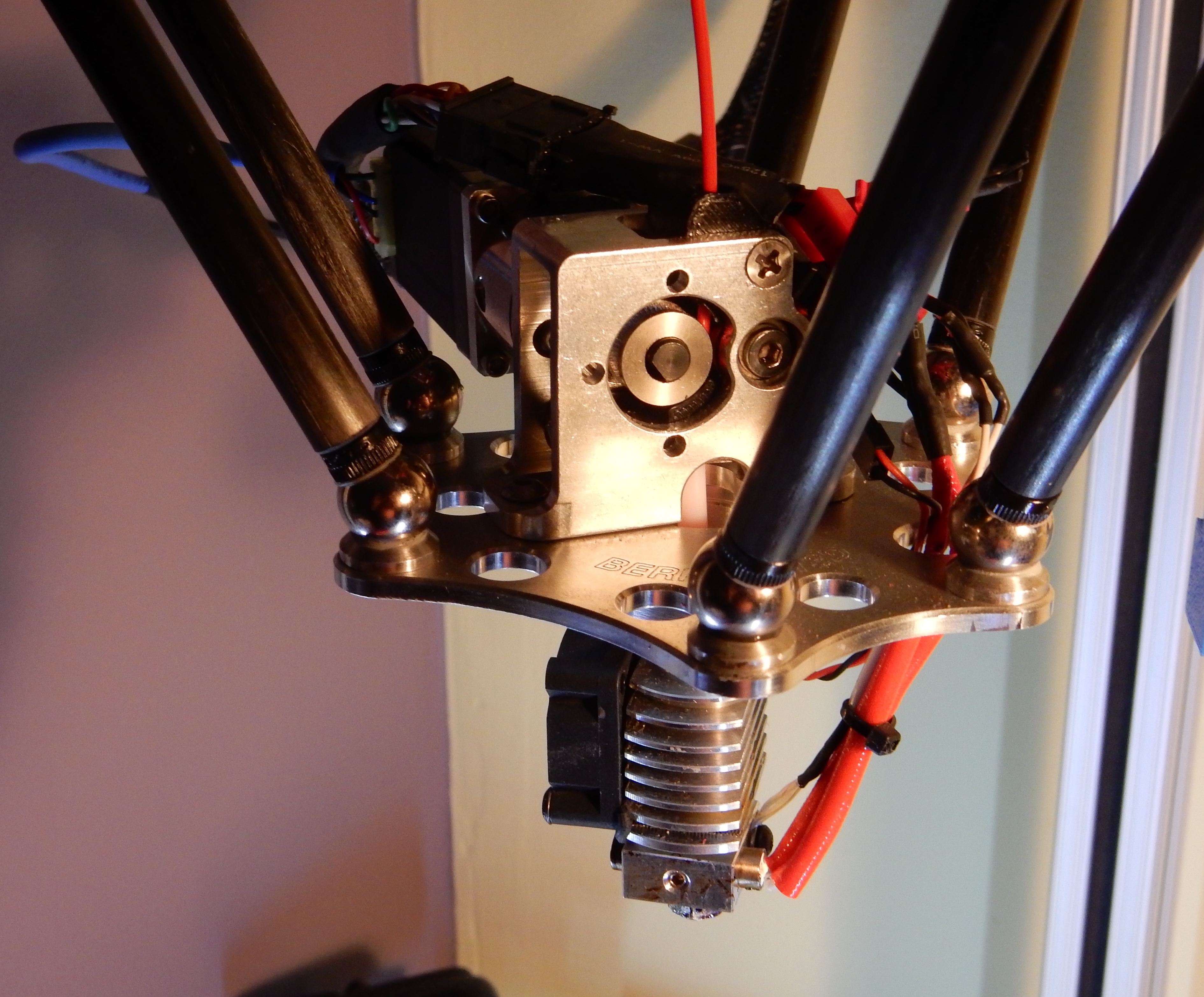

Just wanted to share my final built of Max Metal frame built. I have finally got it to the point where the prints come out as perfect as I can expect from a Delta printer.
The final build list:
- Max Metal frame from Brian at Trick Laser
- Some printed stl files designed by ccavanaugh
- Smoothieboard as a controller
- Heated bed with PEI coating
- 24v variable volt PSU for the heated bed.
- Prometheus v2 Hot end
- Repetier server running on a 8" WinTab
- Autocalibration for Smoothieware from Pilot626
- FSR probe system as a Z probe
- Stepper motors 0.9 on 20 tooth gear
- Geared Stepper motor for direct extrusion
- Effector, Drive Trucks and Magnetic Arms adapted from BerryBot and made by Werner Berry to work on Rostock Max 2 and like printers.
Although every component plays a part in getting a good predictable print, I saw the biggest improvement when I switched to the Werner's magnetic arm solution and a direct drive extruder. Here is a picture of a test I did with Yoda STL from Thingiverse printing at 80mm/s, ABS, sliced with S3D with 0.2 mm layer height.
Wanted to thank everyone I mentioned before, and the community. I learned a lot from this community and the wonderful folks who help share knowledge and their time and effort for people who engage in this great hobby.

by bvandiepenbos
plasma that is a beautiful build. Prints look amazing.
Werner makes really nice stuff.
Have the magnets ever came apart with weight of extruder on platform?
Do you feel comfortable running it unattended overnight?

Hi Brian,
I've been running this build for about a month and a half. Testing at different speeds and accelerations just to see if the Magnets will give up. So far no problems what so ever. Werner uses putty epoxy instead of JB-weld and all the parts sandblasted for additional bond strength, that seems to work very well.
I run the printer overnight yes.

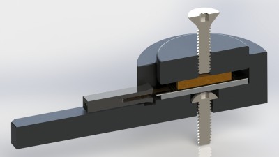

Posted: Fri Oct 09, 2015 5:53 pm
by forrie
Can you go into more detail on how you mounted the FSR's? It looks like you have the bed mounted at three points on each of the horizontal frame parts?
Does the truck move ok with that tablet wire jammed in the slot like that? What's that Hunter pole dohicky hanging off the extruder?
Posted: Fri Oct 09, 2015 6:36 pm
by plasma
forrie wrote:Can you go into more detail on how you mounted the FSR's? It looks like you have the bed mounted at three points on each of the horizontal frame parts?
Does the truck move ok with that tablet wire jammed in the slot like that? What's that Hunter pole dohicky hanging odd the extruder?
I'll take some pictures of the FSR mounts when I get home. Wire is not an issue there is a lot of room in the slot for the wire to sit in. I park my hot end at the end of the print on that "Hunter pole dohicky" so that when I print un attendant I know that the hot end is secure at the end of each print.

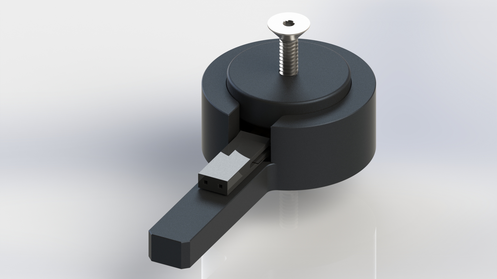

Hot Bed mount with FSR.
Posted: Sat Oct 10, 2015 2:18 am
by forrie
plasma wrote:Hot Bed mount with FSR.
Cool. The mounts don't look printed. What did you use?
Posted: Sat Oct 10, 2015 7:11 am
by plasma
I had some brass rod stock, so I lathed the parts as a barrel and a piston.
Posted: Sat Oct 10, 2015 11:51 am
by RMLynch
I machined mine as well. I used 6061 with very tight tolerances on the "piston" and "bore" and had them black anodized to prevent oxidation and add surface protection. I almost used bronze but wanted them to blend with the black of the machine.

Curious though... I can't find those machined parts on Werner's website. How/where did you get them for the Rostock MAX v2? I was emailing back and forth with him for a little while and he mentioned that he was working on these parts for the Rostock MAX v2 months ago but never heard from him again. Glad to see them finally available, although a little late for me as I went with Brian's all METAL Max Platform, Geared Stepper Motor hanging from a "Fly-n-Strude", Trick Trucks & 300mm Carbon Fiber Rods.

Posted: Sat Oct 10, 2015 6:48 pm
by forrie
plasma wrote:I had some brass rod stock, so I lathed the parts as a barrel and a piston.
Seems like the way to go. I've tried the printed ones, but they bind up ever so slightly. If you sand them or acetone vapour treat them to get them smooth they get a little wobbly.

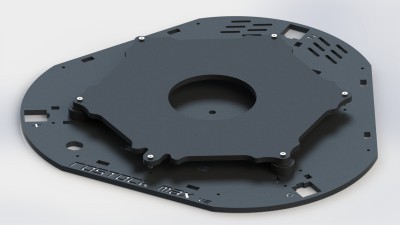

Posted: Mon Nov 23, 2015 10:49 pm
by DarrenAnton
ZakRabbit wrote:This seems to be the repository for the Metal Max kit, so with many thanks to Brian for posting his files earlier, I will add these for those who wish to use them as they may. I'm planning on machining it out of aluminum as I work in a CNC machine shop.
hey ZakRabbit are you selling them also? How much to make one for me out of aluminum?

Posted: Tue Nov 24, 2015 5:27 pm
by ZakRabbit
Unfortunately, I have yet to get on a machine long enough to cut any. Just for giggles I had an online place quote it, they came up with about $1100 for two pieces. I'm in the wrong business.
