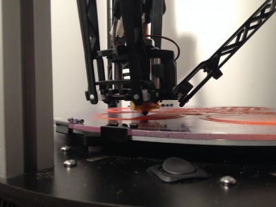

I was just the other day having this exact issue. In some of the "across tower" corners of the bed, prints weren't sticking. I fixed it, here's how:
Start by removing the "center" point as a pre-set button on rep-host (what is the center? It's defined by the movement of the three axes.)
I instead set the 5 buttons as follows:
1: under Z tower
2: under Y tower
3: under X tower
4: across from Z tower
5: across from Y tower
and then for the "sixth" I simply copy and paste the g-code for "across from X tower".
Then, by EYE (with the shiny clean glass bed to use the reflection of the nozzle to determine the height of the nozzle. Do not apply glue or hairspray first.) I make the points at the tower and across from the tower equal. I go around, adjusting each tower slightly. It's frustrating because each time you adjust one tower, it makes the others out of whack. Just keep going around until it seems like no matter what the points won't level. Now you have to adjust your radius. What you are essentially doing is defining the center point. The reason the "across" position is raised or lowered is simply because of an incorrect radius setting. The machine, mathematically, thinks it's farther out or closer in than it really is.
After getting each across value and below value as close to each other as possible (THEY WILL NOT ALL BE EXACTLY THE SAME! It does not have to be perfect, but they have to be in equilibrium - ideally, the variation will be within the thickness of a piece of printer paper - as in, you should be able to "feel" the nozzle at ALL points, including the center, with the paper under the nozzle. Some will be FIRM grips, and some won't be as firm. You wan't the firmness to be as spread around and even as possible, ie not a sloped bed.) you adjust the z height so it almost CLAMPS on a piece of printer paper (thicker than lined notebook paper). You should still be able to move it, but it should be hard.
I am printing across the full area of the bed acceptably. Sure, the base layer has thickness variation, but it adheres perfectly across the entire surface and the prints are stunning... so I think that is the best we can hope to achieve. Don't be expecting to print 10" diameter shims with an accuracy of better than +/- 0.05mm. This is terrific in my opinion.
On that note, I reckon the true FULLY cylindrical build volume possible is 260mm in diameter, or 10.2 inches. Beyond that and I think the towers start slightly interfering... It could go beyond 260 in between towers, but we all know how that goes... ;)
Also, if you look closely, you can see my new and improved, high-tech, patent-pending, ultra-closed-source, proprietary (because a lawyer told me so) cable-tie arm-tension system.
I don't want to release too many details yet because I plan on ripping you all off by selling existing technology as proprietary... but I'll give you a hint: it's 4 inch cable ties, 11 inch cable ties, and you have to make sure the nubs don't interfere with the effector and carriage (look at the picture closely).
Beyond that, it's all hush-hush hush. I don't want to reveal too much, but if you ask nicely I'll make a write-up/photo-series/video detailing the highly-unobtainable, proprietary design.

Anyways, what I found is I am getting the best adhesion ever from simply adjusting the Z0.0 height down by .10mm or .15mm below the height from the "paper test" artificially and also adding some zip ties to the middle of the twin arms to hold both ends tighter (Basically just threaded them through the arms and tightened a bit).
Additionally, I'm wondering why we're offloading these calculations to the RAMBO? Why would we not have the PC that is creating the g-code create it directly in delta-compatible code? Then we wouldn't need to have all these calculations running on the RAMBO in firmware and could probably do some more advanced calculations and optimizations based on some input numbers from the physical machine. The slicer would still produce normal g-code, we'd just have a second run of the g-code through a delta-computer that could optimize the movements and then the RAMBO would just output the XYZ commands directly as linear actuation of the cheapskates in XYZ delta space rather than in physical XYZ cartesian space.
