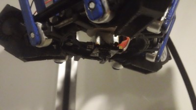

drunkenmugsy
Posts: 115
Location: Texas
Post by drunkenmugsy »
OK the old SeeMeCNC sideways output fan shrouds hang to low with this E3DV6 Lite mounted. What shrouds is everyone using?

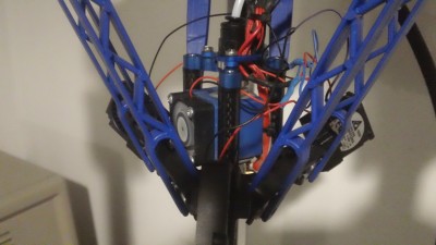

Tinker12
Posts: 39
Joined: Thu Apr 03, 2014 11:38 am
Post by Tinker12 »
Just installed this new mount on orion with e3dv5 and the new seemecnc base plate with 3 layer fans
modified the old layer fan style shrouds but trying out the ultra low profile from the previous link post.
using a custom length standoff for the mount of 45mm.
Tinker12
Posts: 39
Post by Tinker12 »
just a quick note, the 45mm custom length i used caused the old stock layer fan to hang to low, and the length could stand to be a few mm shorter but doing so would bring the extruder fan shroud up against the
base (tight fit) so i chose to stay with 45mm and mod the layer fan shrouds. will post my results with the super ultra low profile shroud.

Tinker12
Posts: 39
Post by Tinker12 »
printed out super ultra low profile shroud and tested on orion delta with new seemecnc extruder platform and e3dv5 works for me
with 45mm standoff length.
