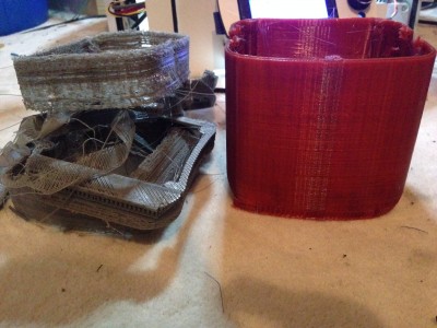

Thanks guys... I guess sometimes it's just the filament. I spent days having printing errors. For some reason the grey PLA jams after a few hours regards what I tried. The wine red PLA printed perfectly the first attempt. I purchased both the red and the grey from the same vendor on eBay.
Now all I need is some primer and an airbrushRe: E3D V4 All metal hotend
It could be a difference in extrusion temps for these 2 different PLAs. What temp are you printing? Perhaps the grey needs higher or lower.
mhackney wrote:It could be a difference in extrusion temps for these 2 different PLAs. What temp are you printing? Perhaps the grey needs higher or lower.
Dyes CAN affect printing temps. Don't be afraid turn it up a bit and see what happens. The nice thing I've noticed about the E3D is with the active cooling the small heat zone allows for you to turn the heat up without severely degrading retraction performance.

Well, I tried the air extrude and it worked fine for a wide range of temps. I can print smaller pieces just fine with the grey. The issue it that it fails several hours into the print. So what seems like the ideal temp during the air extrude test still jams the hotend.
Can you correlate anything like maybe the room temperature decreasing a few degrees or speeding up the print?
I have found that you do need to go 5°+ hotter with the E3D or you can get starving, etc. It has such a small heated volume and with the thermistor-heater cartridge feedback loop, temps may fluctuate quite a bit in the hot end - no measurements, this is just a hypothesis.

aerouta wrote:Well, I tried the air extrude and it worked fine for a wide range of temps. I can print smaller pieces just fine with the grey. The issue it that it fails several hours into the print. So what seems like the ideal temp during the air extrude test still jams the hotend.
I had a similar issue and noticed it was occurring at a fairly consistent height. Turns out the heated bed was impacting the printing environment and as the height increased and the temperature dropped, the hotend wasn't providing enough heat to cleanly extrude the material.

After an entire weekend of hearing "tat, tat, tat" and knowing that it means a failed print is imminent, I cringe just reading it. I'll snap a photo later this evening. Room temp stayed fairly constant. And the printing environments (heat bed included) were identical between the red and grey prints. mhackney- have you tried all the filaments you purchased from the vendor you bought that red pla from? I am pretty sure we order from the same vendor.
The heat bed may have somthing this do with this. Even though nothing was really noted by the hotend thermistor. I can try and test this.
It probably is the same vendor since that is the only source of that wine red I've found. I am printing his silver now and all of the others already and they all work fine. But, different pigments are used in each so temperatures can vary. The blue-green prints best 5°C higher than the wine for instance.
When the tat, tat, tat happens, you can help the extruder by manually pushing the filament from below to get it to start to feed again.
One thing I've noticed - I put a little flag (piece of masking tape with black Sharpie on one side) on the shaft of the EZStuder. When I hear this tat, tat, tat I look at that flag and I see that it actually REVERSES about 5-10°. I do not understand that at all. It would take a LOT of force to reverse a stepper like this, stalling happens but on all of my CNC equipment (2 mills, a router and a lathe) I have never seen a stepper reverse when it skips steps. Makes me wonder if there is something in the gcode (using KISS). I am going to peruse some code and see. What slicer are you using?

What you're seeing is is a classic "skipping" extruder.
What happens is that it's unable to feed filament into the hot end at the rate it's currently doing it and the filament and bowden combine to make a spring that at a certain point will make the stepper motor reverse direction for a short distance when it's in the middle of a forward step. You'll see the bowden tube bounce a tiny amount when this happens - that's the "spring" releasing its energy into the stepper motor. The lower the drive current, the more easily a stepper will skip.
The skipping is caused by a filament restriction of some kind - be it feeding too fast for the temperature, a partial or complete clog, or a thick spot in the filament increasing the friction in the bowden or hot end itself.
