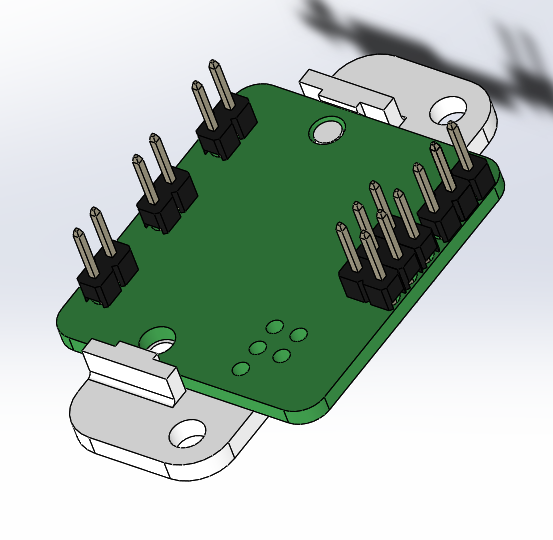

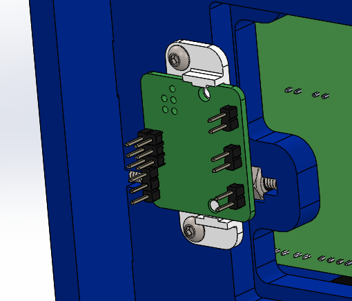

A bracket for the JohnSL FSR board is now available in the Git repository.  The rear plate has been updated with the mounting holes.  If you've already printed the rear plate, some adhesive or PSA will work well to stick the bracket in place to avoid reprint or drilling.  The board should snap in place, but a thru hole has been added for a screw if needed.
