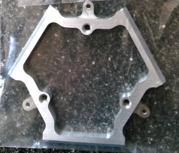

Is that your LCD ring attached between the effector and the jhead mount? That effector looks like the tricklaser one so how does it shine the light through the metal?
Posted: Sat Apr 30, 2016 12:56 pm
by Nylocke
If you check out the platform its mostly empty space
Screen Shot 2016-04-30 at 11.55.50 AM.png (213.93 KiB) Viewed 41855 times
So it just shines through the areas where there is no aluminum
Posted: Sat Apr 30, 2016 1:10 pm
by KAS
Nylocke is correct. No LEDs are covered up, they just happen to fit perfectly within the frame.
[img]http://i482.photobucket.com/albums/rr18 ... 130806.jpg[/img]

Nice! that is a neat way to mount the light ring... I did not realize the LED's would fit like that.
One of the reasons I designed the area between arm mounting screws as wide as possible was so heat sink cooling fan can fit down between, allowing any mounting height of hot end. Even the E3D 30mm fan and shroud fits down in there.
I also wanted platform as light as possible but still rigid.
~~~~ CAUTION ~~~~~ :o
Be careful not to short out the light ring by clamping it right against metal platform or groove mount, you might want to use nylon washers between metal and light ring. The newest revision of light ring has extra connection pads intended for powering ring through stand offs, so watch out for that if mounting to metal platform!
KAS, you might have a older revision of light ring, that does not have the added pads, so maybe you won't have any issue.
