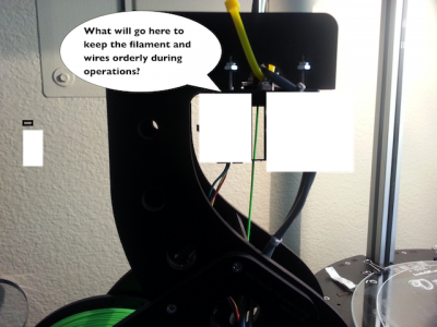

It occurred to me that there might be a part missing - an adapter which keeps the filament in an orderly fashion while it is coming off of the spool. Perhaps a flat mount on the spool holder with a brass fitting for the old bowden?
What are you going to do there?
Also, does the firmware have to change?

I'm talking about what keeps the filament tube and wires orderly. The filament comes off of the reel, goes into directly into a tube down to EZstruder which is mounted on the arms.
See photo - marked out areas where Steve's Extruder would likely be removed... (I would prefer keeping that little guy intact for the purposes of austerity and the benefit of mankind).

John,
There are a couple of build logs that show the ezstruder in use already. Mine and another. The filament goes right off the spool and up into the feed side of the extruder. Nothing else is needed.

I'm thinking about a hot end going directly on the bottom of this...and then figuring out something to control the feed end.(Thanks for answering though!)

JohnStack wrote:I'm thinking about a hot end going directly on the bottom of this...and then figuring out something to control the feed end.(Thanks for answering though!)
Why not just set the spool up top then?

Good idea. Next week's project - make spool holder for the roof. The bonus is a small reduction in overall lateral movement / wear / adjustments.
