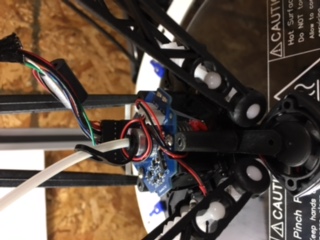

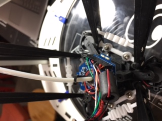

I installed ferrite cores I removed from a USB printer cable however I did notice that the cable was also shielded. The first go around I only ran the 2-wires, black and red, straight through the core, verses wrapping them around the core, and the results of printing the calibration ring was immediate failure after running the calibration G-code form Octoprint several times as suggested. So I took the wiring apart and for posterity sake I looped it around the core on each end. Second go around with the wires looped around the cores and results were the same - still not printing properly, between the X/Z towers the print is non existent it is so close to the glass. So my tests failed, if anyone has other suggestions, I tried to eliminate any interference however in the top of my machine even with all the cable management I did there are a lot of wires that could cause a problem.
What can I enter at the terminal window that will display the probing results? I watch it in the terminal window while it is probing but I am not sure I am seeing a result. I just know when I print the test ring or a 220mm triangle I made the printing issue persists.

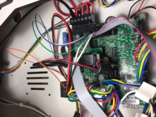

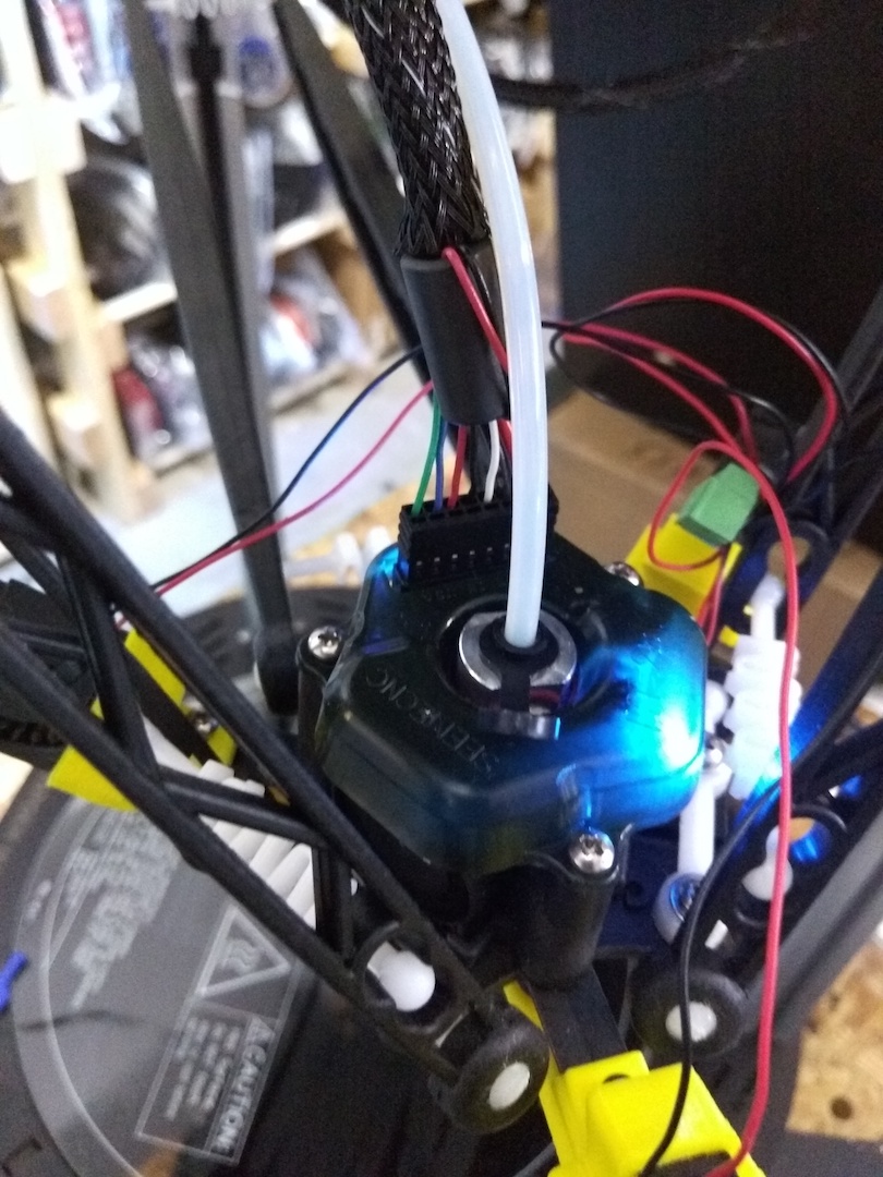

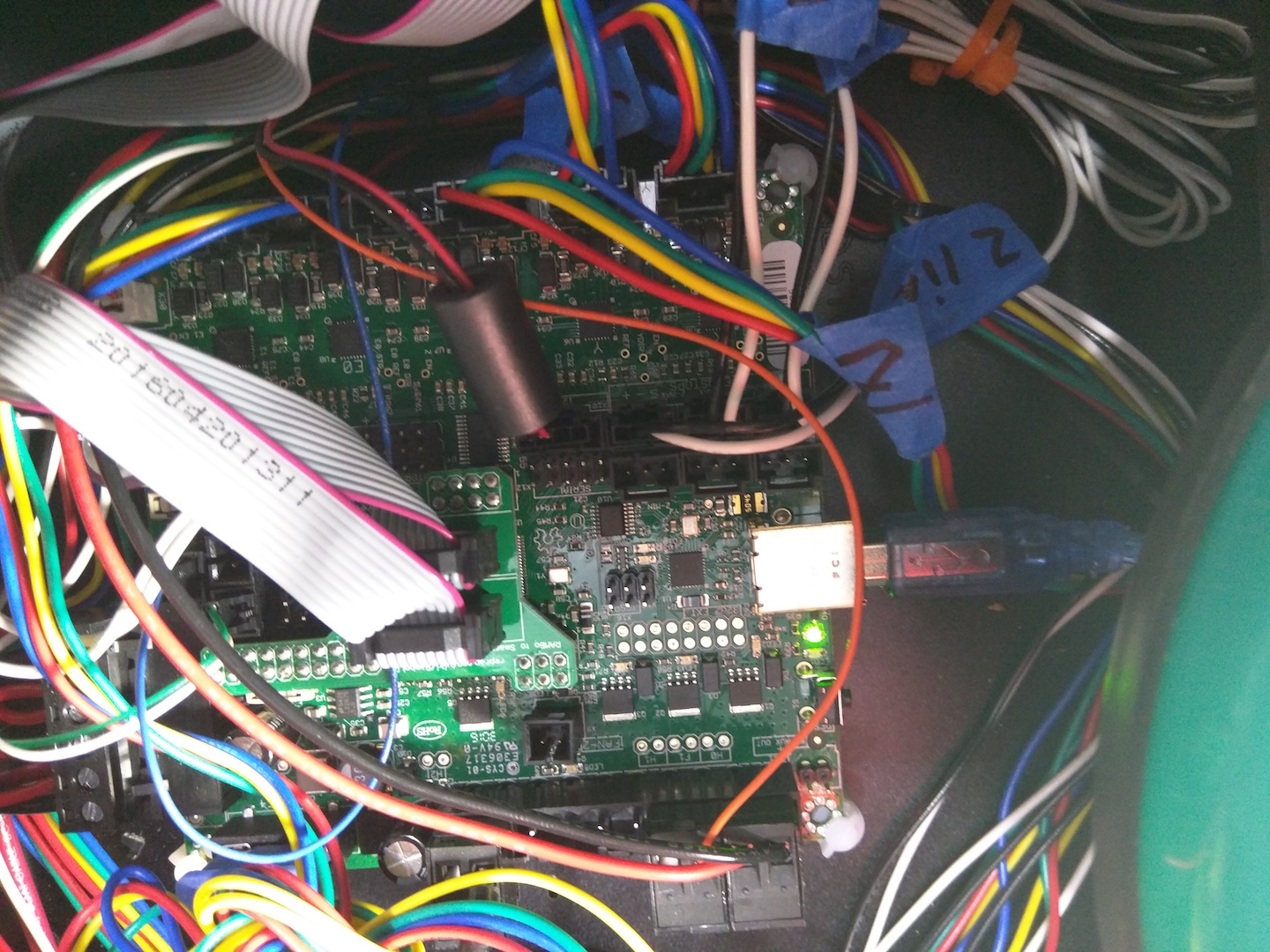

Stopped by my local RadioShack and found that they sell three sizes of Ferrite Beads. I bought all three sizes, each size has two per pack. When I got home I used the Small 3.5mm ID for the Rambo Board. The largest which has 3/8 ID was used at the Hot End. So far things are looking better at the edges. Still more test to do. If things change I'll let you fine people know!!
3/8" ID at Hot End
3/8" ID at Hot End
3.5mm ID at Rambo Board

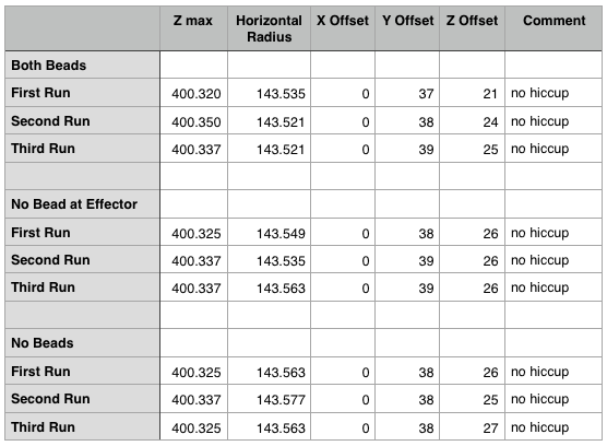

Re: P003A HE280 [Solved?] Auto Leveling Issue/Bed Leveling Issue/Calibration
Well, this is not going to be good news...
I did a series of tests to validate if the beads were the silver bullet, they are not. This one was an easy test. Basically, I did 3 calibration runs with the beads on, three with no bead at the effector and three with no beads at all. If interference was leading to bogus data - hypothetically on the Z and/or Y tower offsets, one would expect the tower offset data, at a minimum, to be different between these sets of runs. But that's not the case:
As you can see, the offsets, Z Max and calculated delta radius are extremely consistent. This conclusively rules out interference as the contributor to this problem.
I should note, these were all done stone cold, even the fan in the power supply was off. I ran them back to back and observed and listened carefully. The "no hiccups" comment means that all runs went very smoothly.
Next I need to print with this latest calibration to verify it is still laying down a good first layer.

mhackney wrote:Well, this is not going to be good news...
That's not bad news. That's not even "not good news." It's just more observational results. More data is always good.
I do wonder though, can I ship you a set of ferrite beads and have you reproduce the same settings used on our machine and the other machine both of which did show improvements? This would just mean wrapping the two I2C wires around the ferrite bead at both ends, cutting the wires flat at the HE280 plug and running the probing routine 2X.

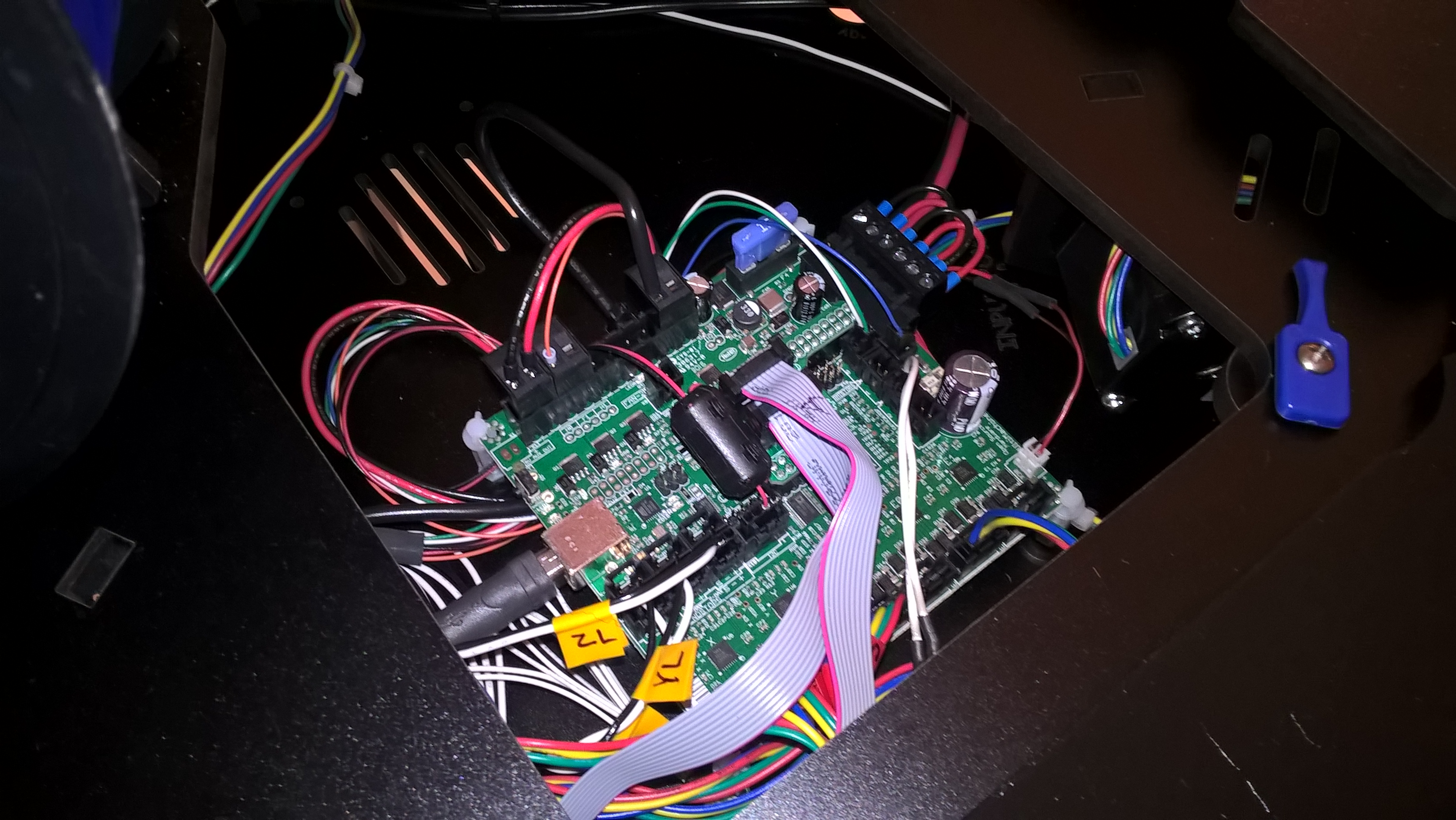

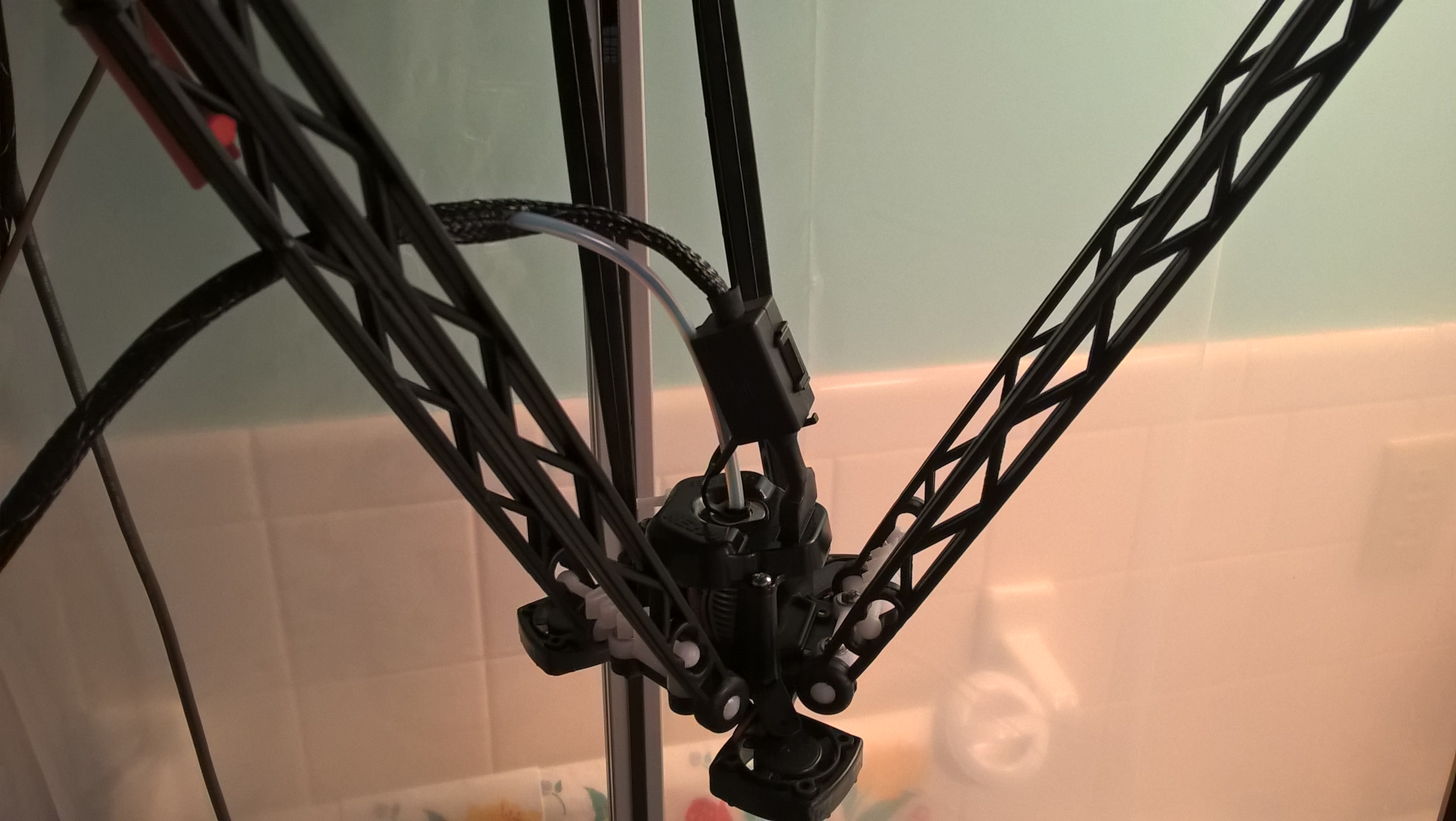

cloneit3d wrote: Support just got back to me and they shipped in a machine with the issue some of us are seeing and they expect to have a solution in place by the end of this week. I am suspending further testing to see what the solution is. They said they will report the solution to the forum. Can't wait to have my printer up and running.
Can you get some pictures of your ferrite bead installation and of the top wiring on the machine?
I will also be adding their solution to the OP here once it's released. Our hope in sharing the solution was that it could get more machines printing until an official solution could be found.
Here are the requested pictures- please note I tried running the wires straight through first and then the loop around, both with no improvement of the first layer of the test circle.
The idea was not that communication was lost but that noise was introduced and interpreted as data.
My data includes results without the beads - its the last 3 rows. You simply need to look at your eeprom values. Matter Control, Repetier host and a plugin installed in OctoPrint all let you do that.
Your offset numbers are not going to be consistent with mine or anyone else. They are a result of the total distance from bed to triggered home switch. You can (and should) adjust these as I describe in my build thread to be less than 4 steps each.

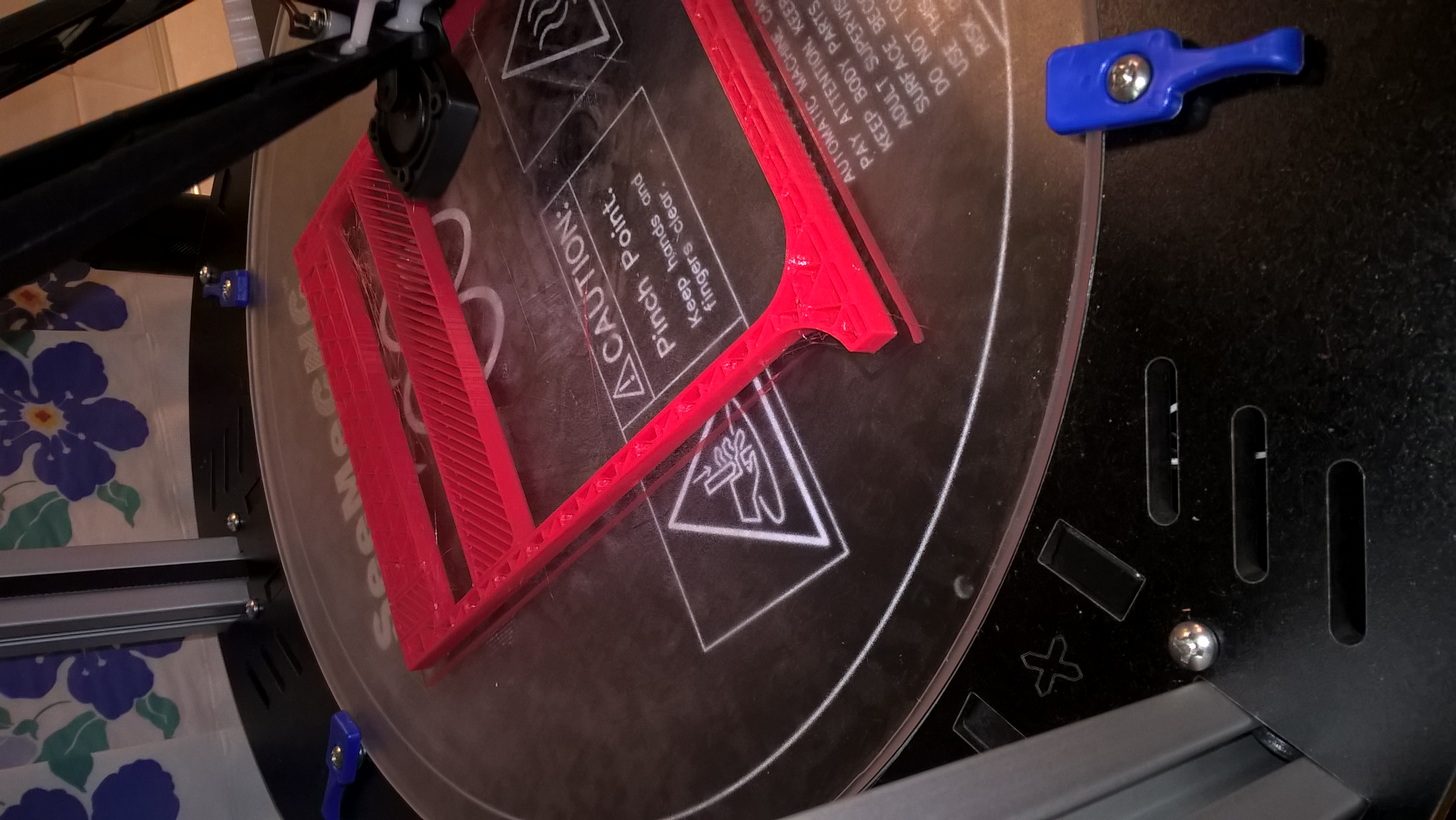

Here is a large print to test if things are any better. I still have the problem at the x tower being a tad thin. Based on Cloneit3d, looks like things are moving at the company level. Will not do any more testing as it sounds like there may be a fix close at hand...
Thin at the X Tower
Thin at the X Tower

cloneit3d wrote: Here are the requested pictures- please note I tried running the wires straight through first and then the loop around, both with no improvement of the first layer of the test circle.
There is a significant difference in your wiring and my/testA wiring. The plastic cap is off your HE280 and there is a lot more slack and touching between the wires and hot end. At the top of the printer your accelerometer wires route towards and around other wires and the board itself vs moving immediately away from the board.

Steve, I trust that JJ has shared with you the emails I've sent him over the last 3 weeks describing the testing I've done in detail, methodically, changing one thing at a time and testing. My point has always been, whatever is leading to this "issue" - for all 18 of the users that I have personally verified have the same symptom of thinness ONLY near the X tower base and thickness opposite it between the Y and Z towers - is that it is absolutely reproducible and amazingly consistent. I have rotated the effector 120°, moved carriages from one tower to another, swapped the X & Z steppers (and end stops), scrutinized the bed and its mounting, checked plumb and tilt and all other mechanical attributes I can, introduced mechanical errors to see if I could inject a similar problem or increase the magnitude of this one. The fact that I can make all these changes and afterwards a series of test probes give almost identical values for Z max, delta radius and X/Y/Z tower offsets (within +/-2 steps) really tells me 1) there is no appreciable backlash or other mechanical slop in endstops, carriages, etc and 2) there is no communication issue with the accelerometer to RAMBo interface with the hotend and bed off. I've performed many hours of methodical observation and testing and I'm completely stumped.
At this point, I understand and have profiled the offending bed tilt to the point where I can run the calibration and simply edit the tower offsets to compensate for the "tilt" and I get a perfect .2mm thick first layer on the ENTIRE print bed. And, the number of steps I need to adjust the offsets is also consistent from run to run. The V3 is absolutely capable of a high level of performance but something is leading to a consistent bed tilt error after calibration. The only thing I have not really investigated is the firmware calibration code.
