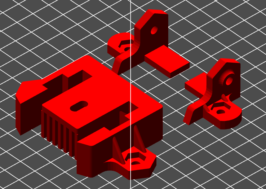

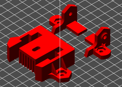

If anyone is interested, here's v27 of the Belt Tensioners. I basically added a bit of extra support material for the smaller bearing brackets, in hopes it will help prevent any warping/breaking under stress of the adjustment screws. Oh, and I'm a bit O.C., so there ya go. ;)
rostock max v2 belt tensioner v27.stl
Rostock Max 2 - Belt Tensioners by Esbowman - V27
(159.26 KiB) Downloaded 547 times
Here's a screenshot of the changes to the smaller bearing brackets. You can see a bit of added material to the front of the small brackets.
V27 Belt Tensioners from inside Repetier. Note the extra supports on the smaller brackets.
