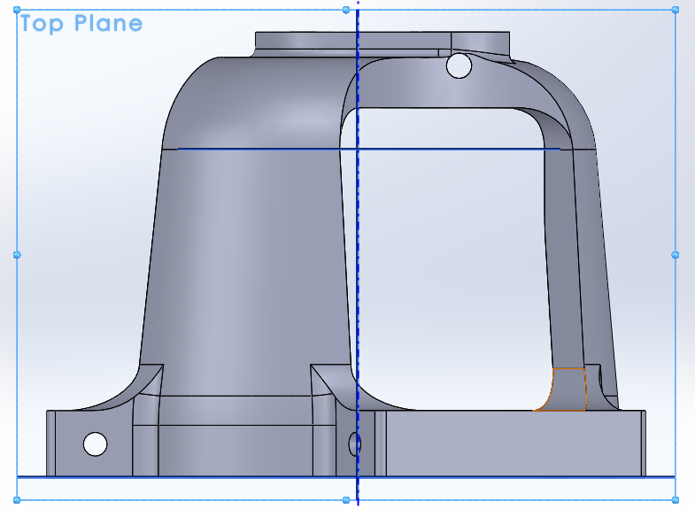

So here is my first attempt. Problem i foresee already is not directing the air enough or at a steep enough angle to keep it from blowing large volumes on the heater block, but hey you gotta start somewhere. Now that you guys have a general idea as to what I am doing, feel free to chime in with your ideas.
I am going to beef up the bottom lip of the fan port to make sure it wont crack when fan is installed(meant to be a tight fit only .003in of clearance), and move the port opening so I can have the volute face at a steeper angle towards the nozzle to keep as much air flow away from the heater block as possible.
Another problem being I cannot extend past the bottom of the platform without having to generate more support than i would like, I am toying with the idea of making the volute/duct as a seperate piece that would press fit onto/into a lip on the I.D. to direct airflow. Any ideas as far as shape/ direction/ size? Anyone tried those fancy rings people print to blow around the nozzle?
[img]http://drive.google.com/uc?export=view& ... k9aWXJ0LWM[/img]

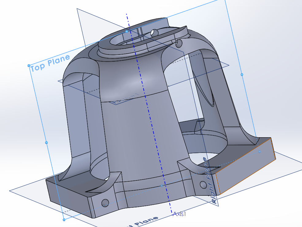

[img]http://s25.postimg.org/n2q9k0gx7/No_support_test.jpg[/img][img]http://s25.postimg.org/u4jlsgv57/No_support_test_side.jpg[/img][img]http://s25.postimg.org/alf0j3wdn/No_support_test_under.jpg[/img]
[img]http://s25.postimg.org/ss6i4bn3j/No_sup ... _assem.jpg[/img]
I had something more like this in mind..... 30deg draft to straight wall.... if you look close i still have room to make it a little bigger.
BUT, slicing the model a couple times tells me that without a very low fill rate like 5% or so, I am not seeing big differences in print time. Maybe that's just my settings though. As far as mounting a regular fan I think that the new vertical O.D. wall will make things alot easier. If you want I can post this as a step or iges for you guys.

Thanks for uploading that model of the hotend, I still need to upgrade to 2014 to use it thou. I just tried, but I think I missed the window, need to contact Solidworks about that.
I got some upgrades to trick out the entire hot end setup. It's going to be awesome. If I do it right. That's the trick.
Adding radii at the transition at the top helps reduce the need for support material under the top section also. You can see the 5 degree angle on the right side.

So Just got done stealing all your good ideas. 5 degree rubbed ever so slightly for me in the assembly so I backed it off to 3.5, and it clears just barely(will be fun trying to get it together. I also put the cable management port back because...... well just because. Going to make this one with a very basic layer fan just to see if it works and how well. Probably make one without it too just in case i don't like it.BONE wrote:Yea, I had the upgrade disc laying around, but I think I had to do it by the end of October. Now I have to call and ask them for a new code and so on. Hope it's not a pain.

I clearanced where the fins of the hotend pass by when installing. You can see that in the more first screenshot, look on the inside to the right. I also shorten the distance of the slot to move the installation hole close to the center. I made the walls going up 6mm thick to try and stiffen it up some more. Does it really? Maybe.
I treat all my parts like racecar parts. Do I really need material there and where can I add it make it stronger, stiffer, etc...

Ahhh... yea I never noticed the relief you put in, that is where I had mine rubbing. I'm printing v1.0 now to see what I like and what I wanna change. I might go back to 5 deg and add a relief like yours but I'm not sure because I get a smidge more room for the cable management port. Should be done in about an hour so I'll have time to assemble and take pics before I go home.BONE wrote:I clearanced where the fins of the hotend pass by when installing. You can see that in the more first screenshot, look on the inside to the right. I also shorten the distance of the slot to move the installation hole close to the center. I made the walls going up 6mm thick to try and stiffen it up some more. Does it really? Maybe.

I basically got rid of the cable ports and going to bring the wires out on of the openings. I see one open for the hotend fan, one for the layer fan and the other for wire and cable management.
I just had a flash of genius also, I'll see if it works out.

I'm actually pretty happy with how it came out. A little rough around the edges but I printed this one with speed over quality in mind-75mm/s print 44mm/s shell and infill. VERY little support to remove compared to the previous one(but that was the point wasn't it?). Fan fit in fairly easily and the vent is actually sturdier then i thought it would be...... Now to let the hot end cool so i can test fit.
[img]http://s25.postimg.org/hzda7y3e3/20141114_150606.jpg[/img][img]http://s25.postimg.org/jbuz9u0tn/20141114_150655.jpg[/img]
- M³ Platform.STL
- My spin on the Monolithic E3d Mount for Rostock Max V2
- (310.53 KiB) Downloaded 553 times

Hey Mike,
That looks pretty good. I'm going to try and post mine again tonight. Can you save your hotend as a 2013 SW file and upload it here? I would like to use it this weekend.

[img]http://s25.postimg.org/yr374ft0r/20141114_155449.jpg[/img]
So it does need a bit of work. As is the layer fan blows directly on the heater block
. The hot end fan did fit but just barely. I'm going to extend it by a couple mm to get the bottom of the platform closer to the end of the fan. Btw we are missing the easiest cable management solution..... I stole your idea to use a pin to hold the collar in place so when everything is installed there is that perfectly nice unused space left begging to have wire run through it. Well looks like V2.0 will be printed on monday.

Nope I can't save for 2013, but i did post a link to my google drive earliuer with an iges file you can import.BONE wrote:Hey Mike,
