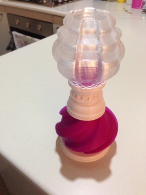

this is the current output from the bandit!
Victorian Lamp
Victorian Lamp
It is a rather nice lamp with battery tea light...

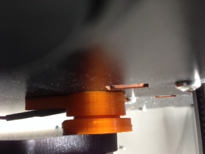

by crocky

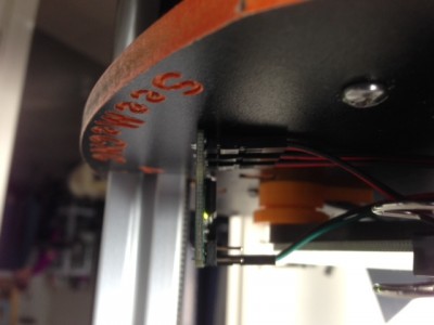

FSR's for Calibration, the way to go!
Buy the FSR kit from Ultibots they make the implementation of these things a breeze.
I used my own mount and piston design, you can copy mine if you like or go ahead and design your own. Wire the FSR's to the board using the provided harness wiring. I used the thin pads and I stuck them onto the centre of each FSR. Make sure that the pistons are a sliding fit in the FSR mounts but have no sideways movement. The FSR consist of three mounts so the other three holes will have to be bolted to the plate only and not to the top of the Rostock.
fsrpiston.stl
FSR Piston
(196.79 KiB) Downloaded 578 times
fsrmount.stl
FSR Mount
(128.62 KiB) Downloaded 532 times

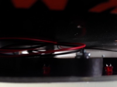

"Other" three hole mounting detail
The wiring from the board pins marked +/-, -/+, S goes to the Rambo board Z-min endstop position +, -, S. No wires are changed, just use it as is. The important wire is the one that goes to S pin.
The following changes are made to the firmware in the configuration file and then written to the printer.
Edit: Must be something with being downunder, pic's are upside down!!!
FSR Mounting - X-Tower
FSR Control Board
FSR Control Board
Configuration.h
#define FEATURE_Z_PROBE true
#define Z_PROBE_PIN 10
#define Z_PROBE_PULLUP true
#define Z_PROBE_ON_HIGH false
#define Z_PROBE_HEIGHT 0
See if the probe works, send a G30 to it and see if it moves down and is triggered.

Re: crocky's Rostock Max V2 Build
Posted: Mon Sep 07, 2015 10:29 am
by geneb
Crocky, are you screwing down the FSR mount using a #4 flat head and the original Onyx t-nut that's installed in the base?
tnx.
Posted: Mon Sep 07, 2015 5:29 pm
by crocky
Close, I am using the tapered screws that were provided in the kit for the three FSR mounts.
I then cut about 1/8" off the remaining screws and used countersunk heads for the FSR Pistons with normal nuts. I then used some 1/8" by 1/2" screws and spring washers and nuts for the other three holes in the plate that are not connected to the Rostock now.

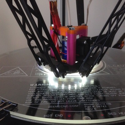

Posted: Wed Dec 02, 2015 7:04 am
by crocky
I have been a bit quiet lately on the 3D printer front while I had some radiation therapy done, hopefully that will be it for a while.
I have fitted the new trucks and ball rods to my Rostock and have got it all nicely levelled with the OpenDACT and I am just doing a six hour print job to test it all out.
I changed the display for a different colour too, not quite the colour I wanted but I have an orange one here and when I feel confident enough I'll do some desoldering and replace it.
The other bit that I changed was the mount for the E3D to the one that was manufactured by a user on here called travelphotog, he has done a terrific job!
All the new bits
All the new bits

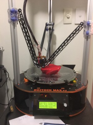

After a bit of a break while the doctors did their thing I was finally cleared of the skin cancer today.... Took a fair while and this time last year I had just completed the radiation and the dermatologist had done a cut and removal of some stuff around my neck.
Back to printing now :)
I have kept up with most of the updates and I think the Max 2 is now almost completely a Max 3. Just completed the HE280 and the auto leveling modifications and fitted a magnetic build plate and did the auto leveling and it is now half way through a 22hr print job... Very nice feeling again... I have configured the Raspberry Pi 3 with OctoPrint and will get it installed and powered off the Rambo over the weekend...

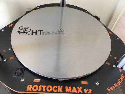

Posted: Thu Dec 01, 2016 7:36 am
by crocky

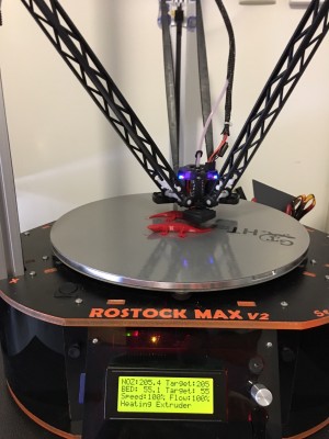

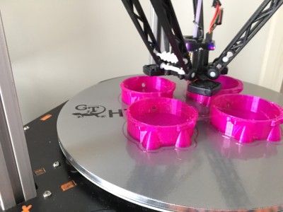

Just installed a GeckoTek build plate (with magnets to affix the HT build surface) and doing a test print of four planter/pen storage items. No glue stick or hair spray needed. GeckoTek3D.com to get more info and I am not affiliated with the company, I just like their product. The build plate is about 6 or 7 mm thick and it does take some time to heat up so if you are after speed, well... maybe 24volts!. It is fine for me at this stage though.
GeckoTek Plate
GeckoTek Plate

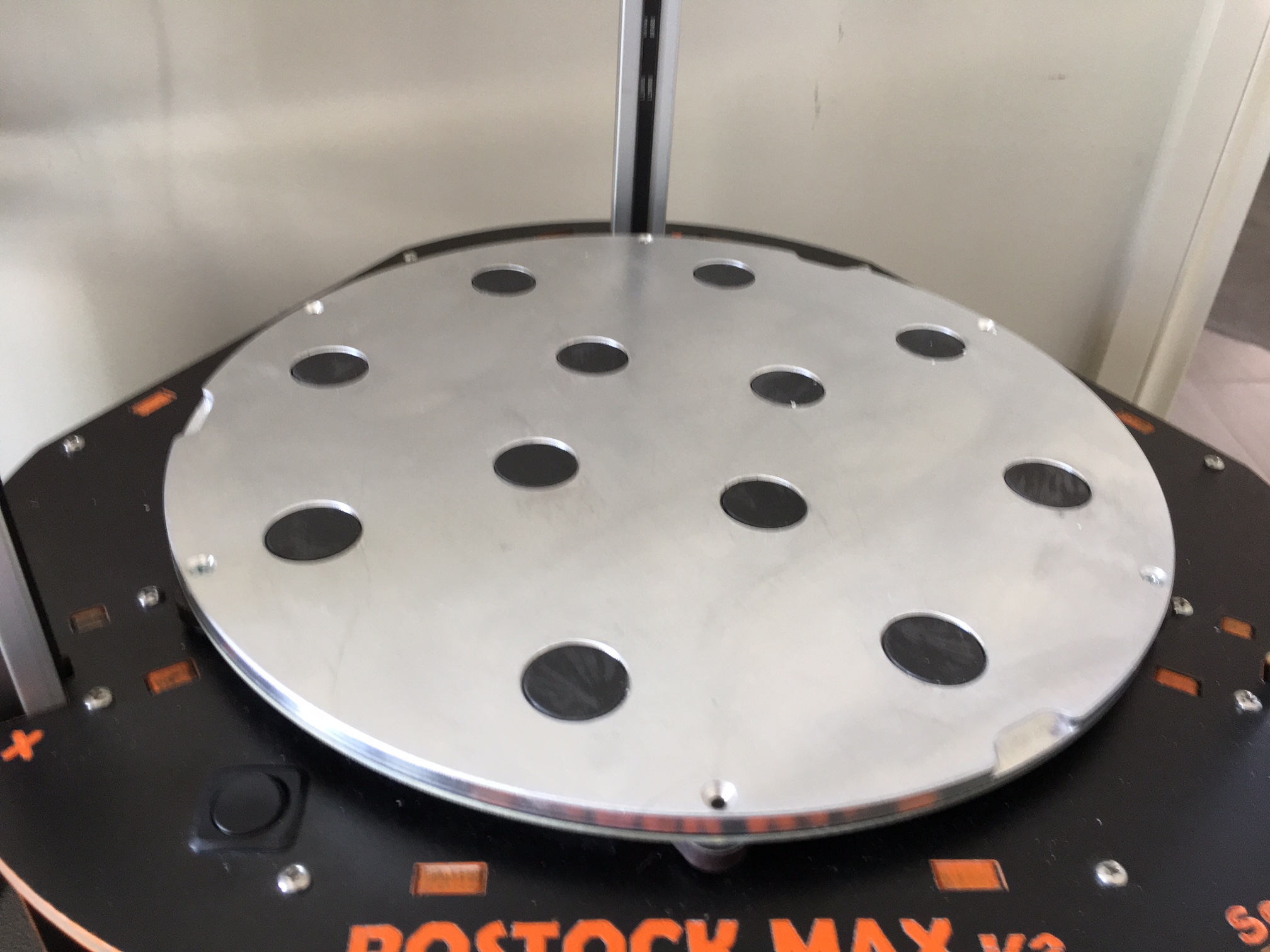

A couple of things that you need to be aware of, the nice red led's still work but there are no holes in the build plate so you can't see them. Same goes with the build surface, no holes. As I am a rather disabled chap with the use of only the left arm and left leg the addition of the build plate that is attached to the surface with magnets has just made my printing life so much easier. The prints just "pop" off with a slight twist after the HT surface cools and it is removed from the magnets.
Posted: Thu Dec 01, 2016 4:58 pm
by crocky
I have been in contact with GeckoTek and they are willing to do some mods and give me one to test... in Australia :) but I don't know that he knew where I was from.
Anyway the end story is they did not have any Rostocks to do trial fittings on so make sure you send details of the number of holes that you would require and I'm sure they will do them for you. I am VERY happy with mine.......

Posted: Thu Dec 01, 2016 10:13 pm
by crocky
More info re the GeckoTek3D plates...
GeckoTek 1
GeckoTek 1
GeckoTek 2
GeckoTek 2
I have only screwed it on to the 3 screw holes adjacent to the towers... there are 6 screws provided if you really feel the need to have them all installed.

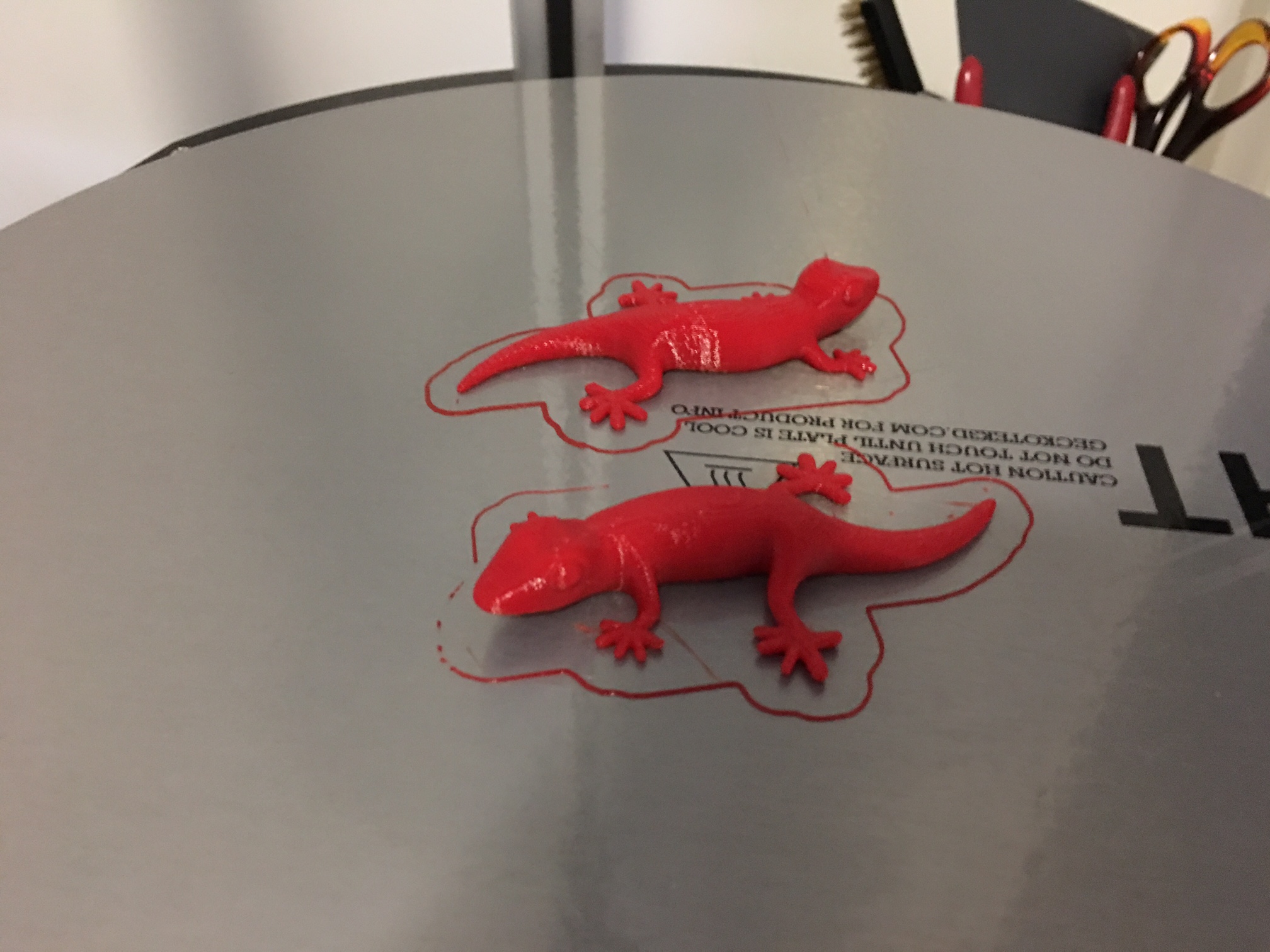

Posted: Tue Dec 13, 2016 9:09 pm
by crocky
Some more gecko's.....
They're Multiplying.....
Better piccy :)
Better piccy :)
After using it for a couple of weeks I'm very happy with it :)
