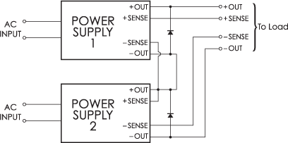

I just picked up a 600w 25a supply, and a D1D40. I am curious if we can't add additional resistance into the circuit and not need the SSRs? I assume we just end up heating the resistor? I am no electrician!
Also, what are you using for the bed PID settings?

No not really. The SSR is actually MOSFET that is switched on and off rapidly by the incoming signal (think 20,000 times per second) it therefor mimics the Rambo current pulse to the hot end but with a much higher power capacity. You could think of this as an amplifier and in fact a common use for MOSFET's is to amplify power to devices. Stepper and Servo drives for instance.
Adding additional resistance to the bed circuit in fact lowers the power output of the circuit and while the Rambo could handle the lowered power with no problem, the bed would likely not even get warm.
Btw - you don't mention but I assume that your 600watt power supply is 24VDC. raising the circuit voltage to 24 from 12 will increase the wattage of the bead heater from 120watts to 480watt. If the power supply is still 12VDC the bed output will remain at 120Watts and you will see little if any improvement in the heating of the bed.
As long as the bed resistance is `1ohm and power supply voltage is 12VDC using a 1,000,000watt power supply won't heat the bead any faster.

In theory, you don't need the SSR at all. It's a precaution as the Rambo boards are only barely rated for 24V, and some people prefer it as with a second (much cheaper) relay, you can set it to fall-back on the 12V supply if you accidentally hit an over-current limit on the 24V supply. (you can use a form 2 C DPDT ice cube relay, with the coil wired to the 24V supply, to switch the signal from the rambo to to the SSR when voltage is present, and to the bed when it isn't, it costs about 10$ if you buy both the relay and the proper wiring base, or 5$ if you omit the base and just connect to the pins). Just stick a larger automotive fuse it. As far as adding resistance to decrease your power draw, well, if you want to double, rather than quadruple the power going into the bed, and thus keep the amperage the same, you need something with a fairly high power dissipation per ohm. You can get those. But a 1 ohm 300W power resistor costs in the neighborhood of 30$. I don't know what sticking a resistor like that in would do (I am not an electrical guy. I do however, get along quite well with the electrical faculty, so I could ask later) But at some point, it's worth it for the added flexibility to just bite the bullet and go for the relay, as mike has had success with a 20$ relay. There have been days where I ate that much worth of cheap pizza (5$'s a pizza, 1 pizza approximately every 4 hours.)
P.S. Nite, if you added a 1 Ohm resistor, you can get 288Ws, about double what you have with 12V. Also, the Rambo is capable of dealing with the amperage, if only barely. and since he mentioned the amperage, it's easy to see it's 24Vs. and if you're switching 20K times a second, even with the 10M switch life that SSRs are rated for, without a load, you hit the lifespan limit pretty quick. If you take Crydom's loaded lifespan estimate, you have about 5 seconds of switching before you have exceeded the rated loaded lifespan of most relays. 8.5 minutes for the unloaded life-span limit. (these are worst case, thermally, mind you.) not to mention that it would require you to flip the power more than once per rambo clock cycle. Maybe drop a zero off there? Maybe two?

thanks for the info, my brain is starting to get wrapped around these concepts. my next question is: wouldn't it be cheaper to add a second 30a 12v power supply in series with the one we have? can you verify what the output amps would be, I assume you would have 24v/30a? I have an identical supply lying around I could test with. You could still use the ssr to regulate the second power supply, but also connect the two outputs on the other end of the ssr. I also assume the reverse biased diode mentioned below would have to be downstream of the ssr on one and downstream of the Rambo on the other? I think this would also help with the problem of a failing ssr, if it fails "on" you would only get 12v trying to heat the onyx, which will have a hard time over heating it and causing a fire..
The Google meister tells me "the output connections for each power supply should have a reverse biased diode wired across them (see drawing). This will assure that, if one supply comes up to voltage before the other(s), it won’t apply a reverse polarity voltage to the other(s) through the load and possibly damage it (them) or cause it (them) to lock up. Each diode’s PIV and current rating should exceed that of the entire series string. Note that when remote sensing is being used, the voltage drop in the output wire connecting the supplies is compensated by extending one supply’s sense lead to the output terminal of the other supply."

I believe it's workable, as RC enthuasists have modified server supplies to do this. I believe there is a DC ground you'll have to remove in the second one, but it should be workable, in theory at the very least, and likely in practice.

what about using one of these for a reverse current diode?... https://www.jameco.com/Jameco/Products/ ... 558444.pdf
Xenocrates wrote:I believe there is a DC ground you'll have to remove in the second one, but it should be workable
not following on the DC ground, can you explain?

there should be a connection to the case of the unit, or the ground plug on the IEC socket, from the DC side of the unit. This needs to be removed for it to work. I'm not entirely familiar with the process, but I have found a thread on an RC forum which seems to discuss it (not for your unit though I think) http://www.helifreak.com/showthread.php?t=335915
