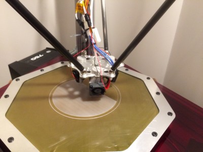

Other than this and the calibrations I need to complete, its working quite well! The printer is much more solid, my accelerations are at 7000mm/s/s where a rostock runs less than 2000 IIRC for printing. It will corner much faster - I need to determine if this causes any adverse effects once I get it calibrated properly.

A couple pics:
[img]http://i.imgur.com/dUzZbtq.jpg[/img]
[img]http://i.imgur.com/70GN0W3.jpg[/img]

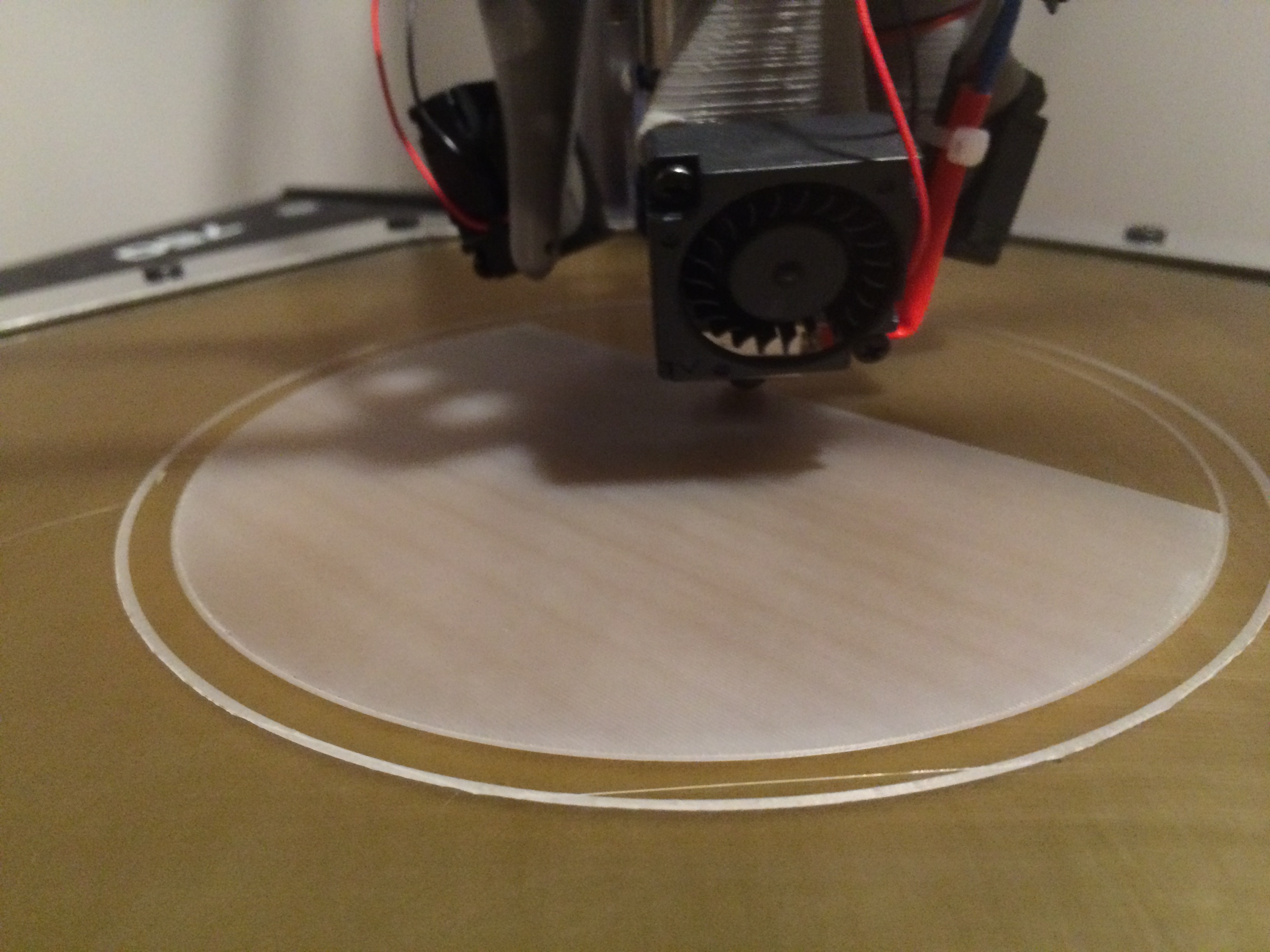

Print currently in progress:
[img]http://i.imgur.com/JvKqIHb.jpg[/img]
As you can see - temporary breeze shields are in place
