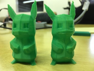

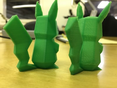

Some sample parts using the new BerdAir Max - much better cooling. These parts were printed with 0% infill and two outer shells on my Graber I3. I kept the temperature settings the same and used the same GCODE for each print; the only change was switching to the Max pump. I'm driving the larger pump directly off of a super cheap RAMPS board with the original mosfet for speed control. The mosfet barely gets warm to the touch even after hours of printing.
The new kit is available at http://www.themakerhive.com/shop/viewit ... oductid=28
BerdAir Max on the left, original BerdAir on the right

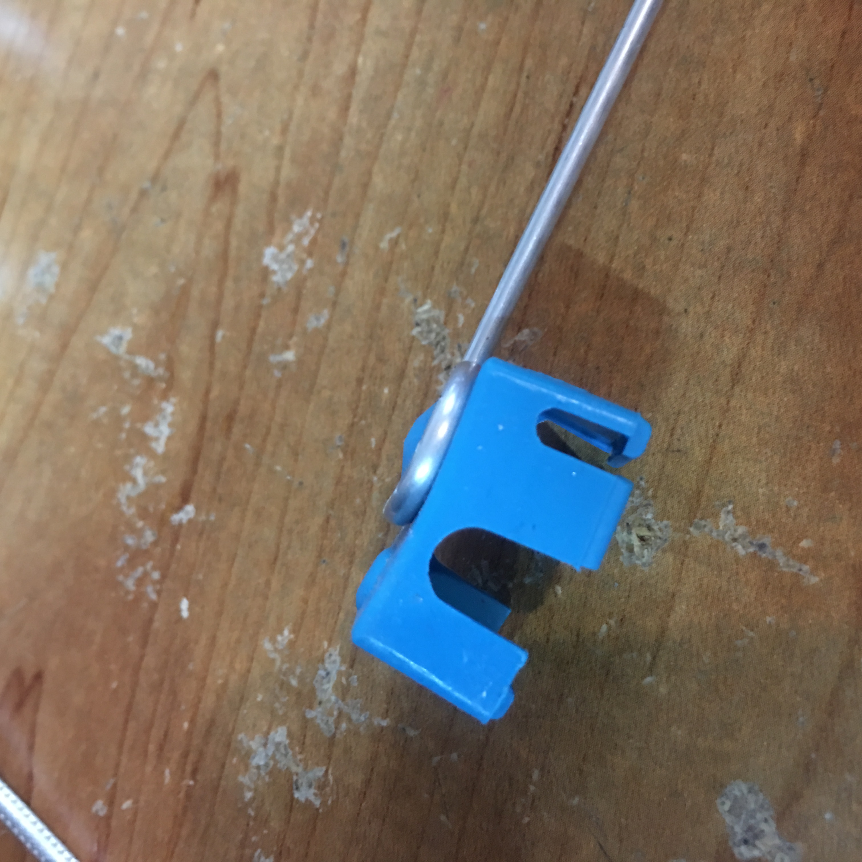

Posted: Sat Jan 07, 2017 1:25 pm
by mhackney
Yes, the E3D sock is quite useful and I've modified my air tubes to fit over a couple of printers with them. It is nominally 12mm diameter and about 3mm tall. Here is a photo of a slightly expanded BerdAir tube wrapped around it.
I don't think you need to change your design, as it is the aluminum tube nicely snugs and is held on the sock.

by Xenocrates
funnily enough, the spare tube I have fits over them without issue, while the one that I actually use currently is a little tight. If there's any adjustment needed, it's on the sub-millimeter scale overall. Perhaps I just suck at bending tubing.

by Jassper
Ah - OK. If the ring is a bit tight, hold the ring in your left hand and grasp the ring between your thumb and for-finger. Then carefully pull the ring open a bit with your right hand, pulling on the straight part. Very little movement is needed, be careful not to pull to hard as the holes make the tubing weak and my bend or break.
I will order a sock and make sure the ring fits for the future!
