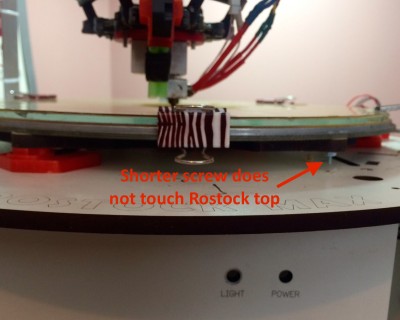

After reading several posts about the FSRs, I just want to confirm they are mounted like I think they are...
When you say "floating", do you meant that the other 3 screws are not connecting the heated bed to the Rostock? I assumed for the longest time that the other 3 screws remained in place, but the plastic spacers where the FSRs were mounted were removed to accommodate them. Now, I'm reading that you could simply lift up your heated bed, glass, and whatever else you have clipped to the heated bed without ever actually loosening any screws. Is this correct?
Re: Mhackney's Rostock Max
Posted: Wed Aug 05, 2015 12:09 am
by ZakRabbit
While theoretically possible, yes, you could install 3 of the silicone spacers to the lower side of your glass, but I don't believe anyone's been willing to subject them to the heat of the heated bed. As I understand it, all six of the original plastic spacers are removed, three of them are replaced with a two-piece design where the lower piece is cup shaped and is attached to the frame. It has a flat bottom to lay the FSR in and a slot to allow the "pigtail" to pass through. The upper piece is attached to the bottom of the snowflake and the diameter is very slightly smaller in diameter than the cup in which the FSR is in. The diameters are matched such that they will slide easily while allowing as little lateral movement as possible, called a "slip-fit."
Posted: Wed Aug 05, 2015 12:18 am
by DGBK
ZakRabbit wrote:While theoretically possible, yes, you could install 3 of the silicone spacers to the lower side of your glass, but I don't believe anyone's been willing to subject them to the heat of the heated bed. As I understand it, all six of the original plastic spacers are removed, three of them are replaced with a two-piece design where the lower piece is cup shaped and is attached to the frame. It has a flat bottom to lay the FSR in and a slot to allow the "pigtail" to pass through. The upper piece is attached to the bottom of the snowflake and the diameter is very slightly smaller in diameter than the cup in which the FSR is in. The diameters are matched such that they will slide easily while allowing as little lateral movement as possible, called a "slip-fit."
This is the description I was looking for. I pictured the setup with 3 of the original 6 screws still going through the entire plate opposite of the x, y, and z locations and the x, y, and z locations having the puck and cup setup. Because the machine is originally built with 6 screws and the document goes into great detail about tightening in a particular order, I never thought only three points of contact with nothing to hold the build plate down would be sufficient. I also never saw a picture that showed empty screw holes on the other pieces.
Thanks a lot.

Just to clarify... (and ZakRabbit has it right)
Three points define a plane (we all know that) so you use 3 FSRs positioned at 120° on a round bed. Since the Rostock and Orions have 6 holes in the heated bed and snowflake, you only use 3 of them (every other one). These three holes are screwed to the little plunger/puck. The other 3 should be used to sandwich the heated bed and snowflake together with shorter screws that do not hit the top of the rostock "table". These keep everything stable and prevent warping. This photo shows one of the three shorter screws and one of the three FSR mounts.
Now, with the 3 pucks attached, these will fit into some sort of holder where the FSR is located. Since FSRs measure force, the entire build plate must be free to move in the Z direction. You don't want it to move in the X or Y. The cups are designed to act like miniature cylinders for the plungers. They are tall enough to prevent the plate from accidentally popping off. The plated does indeed float and is free to move easily in the Z direction. If you have any binding on any of the plungers, it will require more force to overcome and trigger the FSR, resulting in a bad and probably not reproducible measurement.
I designed these printed parts to make all of this easy and work smoothly. First you'll notice that the puck is trilobal, not a cylinder. This creates 3 points of contacts with the holder so it is much easier to fit to get a good sliding fit. The other subtlety is that most slicers will begin printing the holder on one of the long edges (the tray for the FSR leads), this keeps the curved inside surface of the pocket nice and smooth without pimples that could hang up the plunger and would be a PIA to remove.

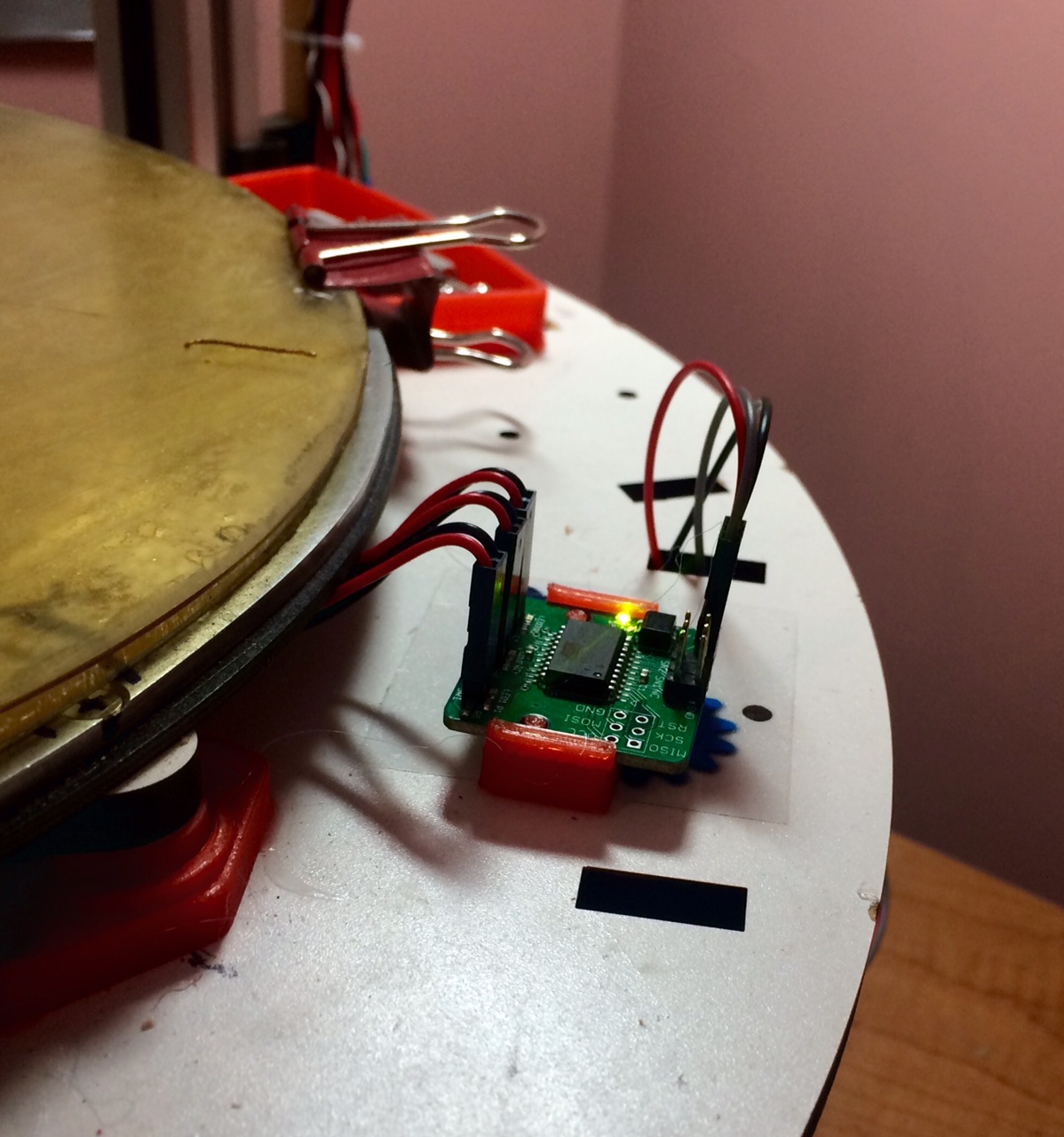

Finally, do lubricate the 3 lobes of the plunger very lightly. I use a wax based product I manufacture called Otter Butter. But a little vaseline works great too, just don't use a lot or it will attract dust.
I have my little board mounted where I can see it. When I start a print session I tap the build plate 3 times, once above each FSR, and watch that the LEDs trigger. I've not had a single binding issue. I also transport my Rostock and have never had the build plate pop off. I'm driving 150 miles to give a presentation at the Fly Fishing Museum in Manchester, VT on Saturday and have no worries that everything will travel well.
I think I posted my STL for a little holder for the FSR board. If not, let me know and I'll post it here.
