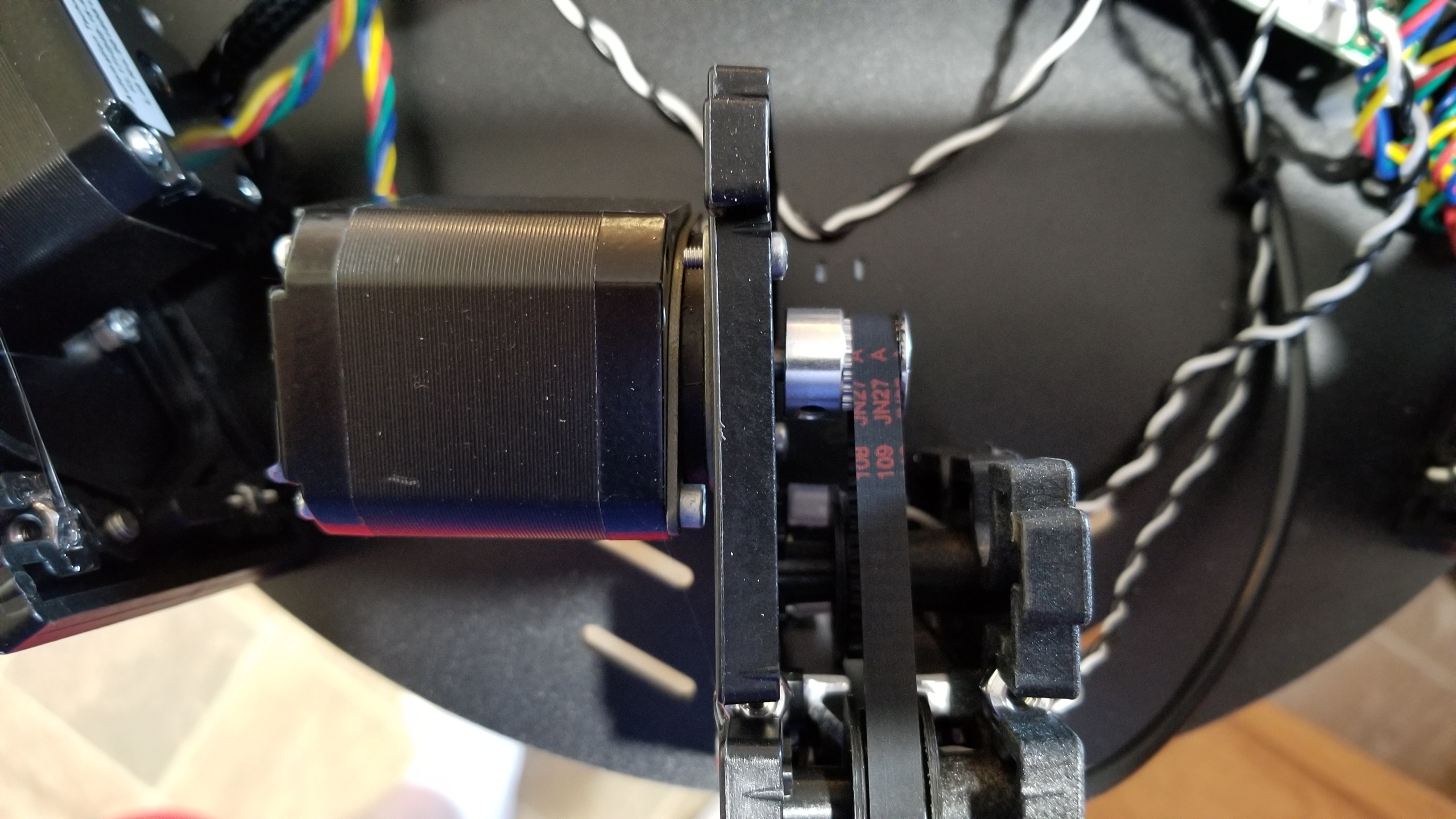

I am surprised no one has said anything about the pressure from the belt cocking the motor and pulley.
My printer has some version of these and I notice today that in tension, they actually cause the motor to sit crooked. I am chasing a shifted layers issue and happened to notice this. one axis is much worse that the others. I am removing these so the pulley sits straight with the belt. These might be okay, but I would at least get some where the plate has 4 mounting holes. This way it is only going to cock as much as the rubber compresses. It is still going to cock though. There is no way around it if you think about it. When the belt is in tension, it is going to pull the rubber down on one side. If the rubber compresses at all, then its cocked.
I bought this printer used, so i did not put these in and I am not sure where they came from. So far, all the repairs I have had to do to my printer have involved undoing the previous owners "improvements".
I hope it is not too much louder, but I need it to be reliable. There is no doubt this is causing more wear on the belts. I am not sure if it is the cause of my skipped layers, but it is definitely putting things out of alignment (at least the version I have).
If there is a way to dampen the motors without allowing it to compress to one side, then that would be a better option.
