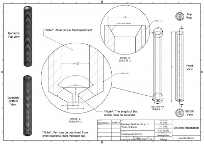

I think a nozzle with a barrel long enough to completely replace the heat break would be the ticket. There is at least one E3D-alike that does this. I don't get jams in my E3D v6, but that's only because I'm using 3mm retract lengths. Without that annoying heat break problem, I could use 5mm+.radicaldev wrote:I wonder if some Hornady One-Shot would be a suitable lube for that area...

The Prometheus hot end has a one piece nozzle+heat break that goes all the way up to bowden tube in the upper cool area of the heat sink. I believe that is why that hot end works so well.626Pilot wrote:I think a nozzle with a barrel long enough to completely replace the heat break would be the ticket. There is at least one E3D-alike that does this. I don't get jams in my E3D v6, but that's only because I'm using 3mm retract lengths. Without that annoying heat break problem, I could use 5mm+.radicaldev wrote:I wonder if some Hornady One-Shot would be a suitable lube for that area...
http://www.hornady.com/store/One-Shot-Spray-Case-Lube
The nozzle is polished on the inside also.
That is why I am selling them in the USA http://www.tricklaser.com/Prometheus-Me ... HOTEND.htm
We will have more in stock in a week or so.

Have you thought about selling replacement nozzles for the E3D that accomplish the same thing? You'd have a built-in customer base that would be greatful to spend a little money on a new nozzle instead of a lot of money on an entire hot end.bvandiepenbos wrote: That is why I am selling them in the USA http://www.tricklaser.com/Prometheus-Me ... HOTEND.htm
