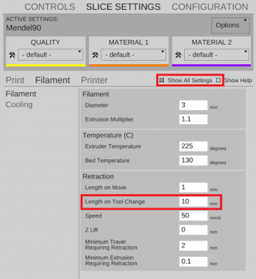

I'm using MC 1.5.0, build 1.5.0.6404 on Linux. (The latest.) I have Extruder Count set to 2, and I have an object loaded with one mesh on one extruder and another mesh on the other. The slicer seems to understand that there are two extruders. However, unlike the screenshot, there is only one MATERIAL dropdown. I can't tell it which material to use in the second extruder!
This is the example on MC's site:
On my screen, instead of two dropdowns for material, there is only one.
How do you dual-extrude in MatterControl?

Re: How do you dual-extrude in MatterControl?
That's because of "Share Temperature" option that's under Printer tab of Settings screen. Don't ask why, I don't know
That fixed it. Thank you.
