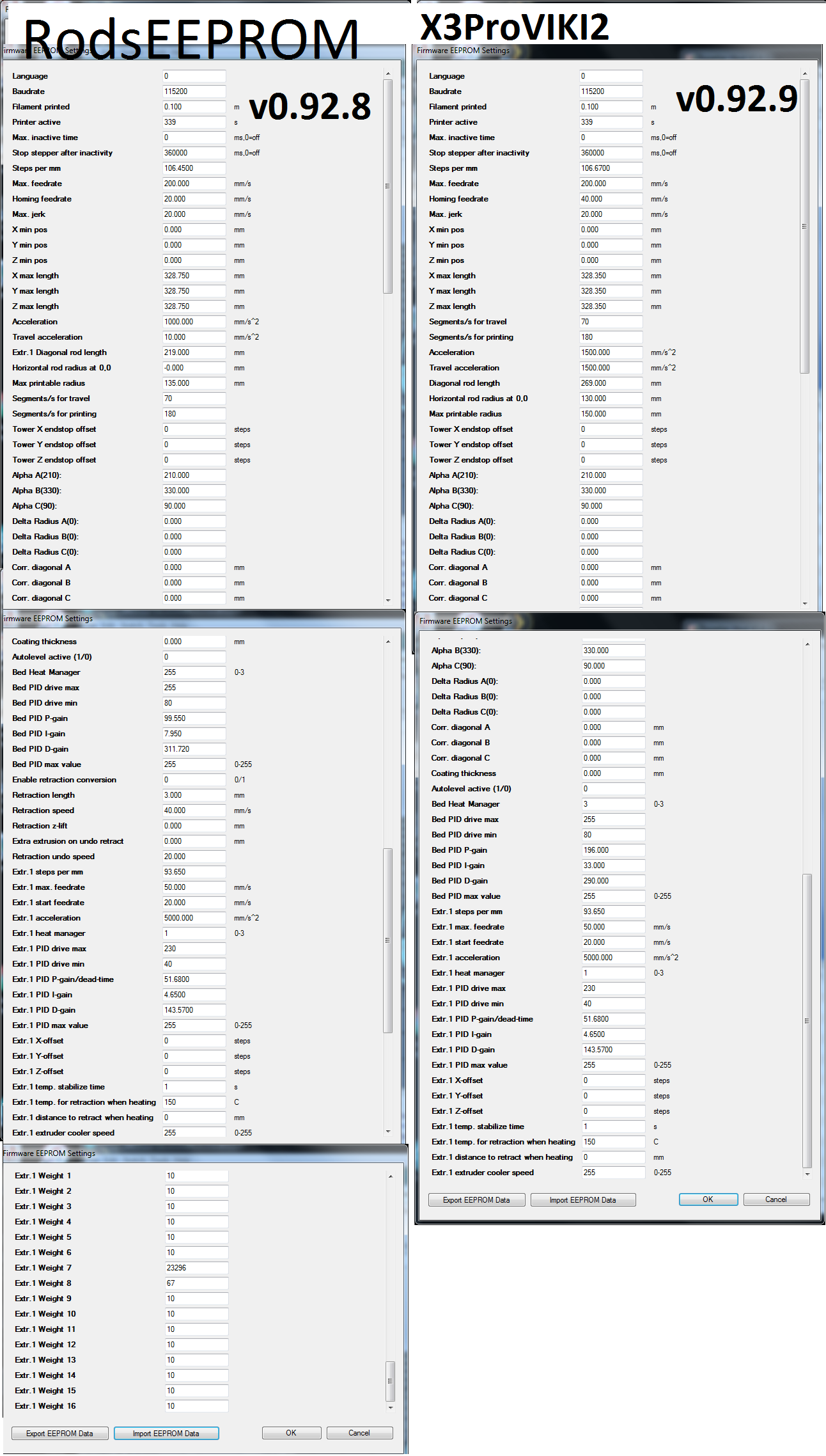

I have a Rostock Max V1. I replaced the Rambo with an Azteeg X3pro, and the LCD display with the Viki2 display. I use Repetier version .92.
I'm trying to calibrate the printer but I can't because "Horizontal Radius" is not present in EEPROM. Making changes to "Printer_Radius" in firmware appears to have no effect in calibration despite turning turning EEPROM support on and off and going through the calibration again and again.
I have a "horizontal Rod Radius at 0.0" in EEPROM but changes to this don't persist through firmware updates. Can someone please help me figure out a way to calibrate without being able to change " Horizontal radius"
Thanks, Rodney

I don't believe that the Smoothie and clones use EEPROM for this type of setting. I think you'd have to make this sort of change in the confix.txt file on the SD card.

Have you tried changing the value in EEPROM and now worrying about reflashing? Generally people flash the firmware once and just change the value in EEPROM thereafter. Also the point of EEPROM is to prevent a reflash from reseting calibrated values. If you want to reset them then upload the EEPROM_Clear program in the IDE (file->examples->EEPROM->eeprom_clear or something like that)

Jim this is the X3 Pro, not the X5 mini. The X3 series still uses the ATMEGA 2560, same thing as the RAMBo and RAMPS.

I have never seen "horizontal radius" in EEPROM or anywhere else, and have never been able to calibrate my 3D printer, even with the original Rambo installed. Another thing I have never been able to do is Print with EEPROM mode set to 1, z-height is all screwey,head crashes happen, homing issues occur,
For Once I'd just like to be able calibrate and print like everything should as documented, by have literally tried to fix things to calibrate and successfully print.

Where are you getting your firmware from? Can you post the config.h file thats apart of it?
Re: Horizontal Radius missing in EEPROM
Posted: Wed Apr 27, 2016 8:49 pm
by Cobaltrod
I can post the config.h. I'm not sure where this version of of FW came from. I think it was originally from a link in the Rostock max v1 assembly guide, then maybe imported in the Repetier FW config tool, updated to my config with Azteeg x3 pro and viki2 But over the years I have tried many Repetier FW versions, and like I said, I've never been able to never find or set horizontal radius or been able to calibrate my printer. Id love to find a solution. I'll add my config.h and EEPROM config. Thanks for the help.~ Rodney
Posted: Wed Apr 27, 2016 8:58 pm
by Cobaltrod
Okay, Here's my config.h
Posted: Wed Apr 27, 2016 9:12 pm
by Cobaltrod
And Here's my EEPROM Settings...
Posted: Wed Apr 27, 2016 9:14 pm
by Nylocke
Your problem is right up at the top, EEPROM_MODE should be any value between 1 and 255. 0 disables EEPROM. I would just set it to 1. All the EEPROM_MODE means is if its > 0 then it is enabled, and it stores the value in EEPROM. Then if you reupload the firmware with a different EEPROM_MODE value (say instead of 1 you do 2) it will see that the number has changed and it will rewrite the current EEPROM values with the new flashed values. If it is the same number it will just keep the old settings.

I made a basic config with this tool http://www.repetier.com/firmware/v092/
Be careful when uploading this, I'm not entirely sure about your configuration, it seems that you have a Diamond or something funky set up. Try uploading it and seeing if things start to behave a little better. You can change the config.h file with the configuration tool (the one linked above in the website) by choosing the configuration.h file. It will load everything I set up. The Viki should work and if the configuration.h file you linked is correct the motors should move the correct direction and home correctly. Just keep your finger on the power switch and position the effector at mid point in case.
X3ProViki.zip
(432.93 KiB) Downloaded 372 times
Posted: Fri Apr 29, 2016 6:54 am
by Cobaltrod

I'm willing to bet it's the "Horizontal rod radius" field. If you've got the new arms & carriages, set it to the default value I show in the 4th Ed. user guide and go from there.
Posted: Fri Apr 29, 2016 10:36 am
by Nylocke
It is the Horizontal Rod radius at 0.0. Looks like its good.

I was saying "Horizontal Rod Radius at 0.0" since that is what "Horizontal Radius" is called in the EEPROM settings. But yeah the original config has some problem (also a lot of weird extra settings I've never seen in any version of Repetier Firmware). The one I sent you is what should be showing up.

I think you have to send the "Clear EEPROM" sketch from Arduino THEN reflash firmware to get it to work.
It is in the example sketches
This drove me nuts until I figured out what was going on.
And has tripped me up a few times since, if I forget this step.

I was able to use .92.9 FW generated. I followed the calibration steps in the appendix of the 4th Ed Users manual as instructed and changed "Horizontal Rod Radius at 0.0" when the calibration steps specified changing "Horizontal Radius". the Initial value there was 130, and I did two .5 increments to reach calibration at 131. Finally calibrated and printing better than ever. Thanks for the help. ~ Rod
