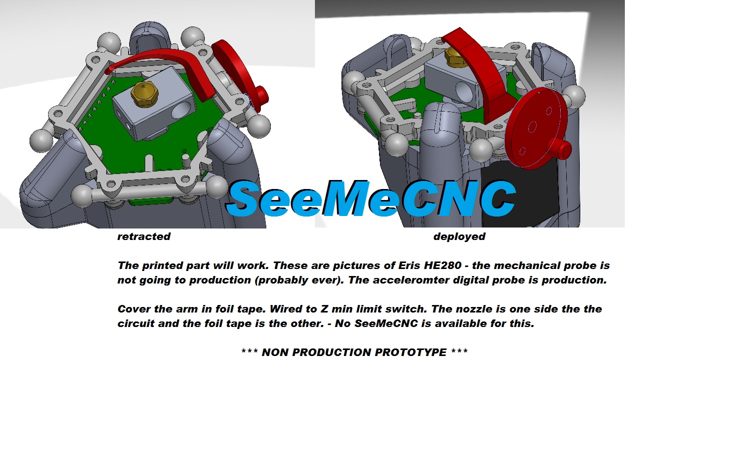

My first question relates to the orientation of the Ball Joint Platform. This isn’t symmetrical as one of the three sides has a larger tab with a molded in channel. What's this for and is there any preference as to which way it should face? Here's the side that's different.
[img]http://gsak.net/stats/screenshots/2016- ... -33-55.png[/img]

As to the asymmetry of the ball joint platform My photo doesn't show it very well. Here's the one from the manual. The side outlined in red is much larger than the other two sides and has a channel in it. I just wondered what this was for and if there was a recommended orientation?
[img]http://gsak.net/stats/screenshots/2016- ... 6-53-1.png[/img]

This was for a mechanical flip-down arm probe. The tiny arm was going to be molded plastic with copper foil tape stuck to it. This worked, but was not durable enough. So the little channel is not used for anything. You'll also see this channel in the platform on the Eris. I designed the Eris without adjustment screws. The probe is how you level, horz radius, and z height the printer.
86032 Probe Arm.SLDPRT
NON PRODUCTION PART
(298.88 KiB) Downloaded 362 times
86032 Probe Arm.STL
STL model of SeeMeCNC mechanical probe arm
(89.54 KiB) Downloaded 455 times
SeeMeCNC PartDaddy's non-production mechanical probe

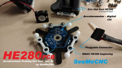

The acceleromter probe is ***AWESOME***. And very close to being done. I'm sitting at my desk right now working on the final injection molded parts for the Eris fan ducting.
SeeMeCNC HE280 Accelerometer Hot End Board
