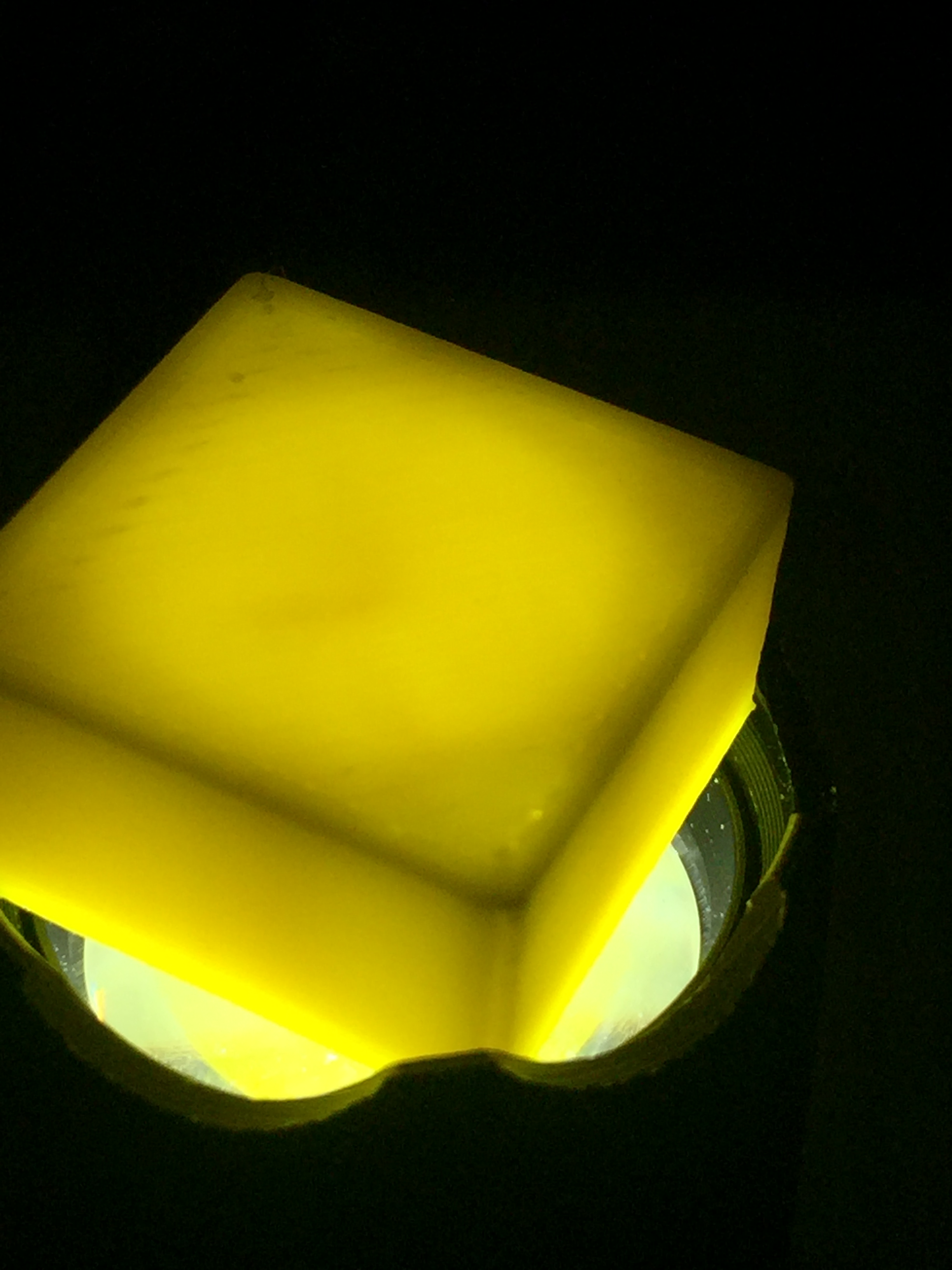

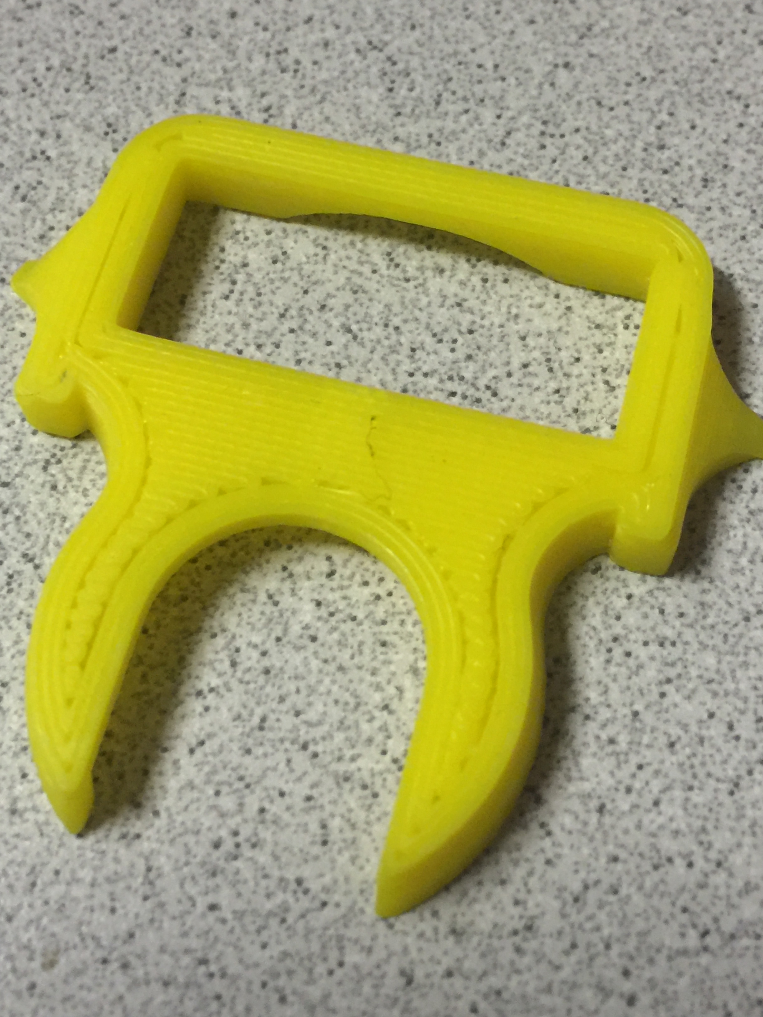

So I have a new Rostock Max V2 build. Its been alive for a couple of days. Just started printing with ABS (Hatchbox yellow) My previous printing experience has been with PLA. When I first started printing the PEEK fan shroud I noticed an interesting thing:
The infill does not seem to be hitting the perimeter and the perimeters also seemed a bit separated. So doing my due diligence I verified the extruder steps and the z height. I looked in the interweb and that seemed to tell me that I was not extruding enough plastic. So for this filament I (ultimately) upped the extruder multiplier to 1.1 and I upped the temp to 235. With all these changes I made the issue better but not completely gone:
I have kind of hit my limit on hot end temperature, at a setpoint of 135 my temperature normally is higher by a few degrees. I don't have the PEEK fan installed so I am wary of going past 140. The internet oracle told me 1.1 is the upper limit for extruder multiplier. And just for completeness, the 'infill to perimeter overlap" (sic) is at .1 (I did not change from default).
Finally to the point, is this normal for ABS? Is there more I can do? My fan shroud actually printed pretty well and is usable, does that need to be installed to get better results?
Also, just for completeness, the dimensions on my test cube are 20.1 x 20.2 x 10.1 So just a tad over size.

I would check your extrusion width settings, as that seems like the biggest thing. Try reducing that somewhat, and it should help. Also, install the PEEK fan at once. It may not help with your results, but there can be damage done to the PTFE liner of the hotend. While this is cheap to fix, it is a pain in the butt. Mess around with the infill to perimeter overlap as well, as that is the setting most closely related to your primary complaint (I think extrusion width is the root problem though). You should also measure the filament diameter (If you have already and entered that, if 1.1 is the extrusion multiplier cap, you can shrink that number to make it think it's moving less plastic than it is)
Also, so you know, Hatchbox ABS is not exactly great stuff. I've had OK results with the black, and terrible with the red. It can be very variable (other than the red, it seems like, as no one I know has it printing well)

This started happening for me when I upgraded MatterControl to v1.5
It seems to happen only when using the Matter Slicer engine, not with the Cura slicer engine.
To avoid this, I set the General > Infill > Infill Overlap to 0.06
The Cura engine does not produce these gaps, but on my computer the layer preview does not display properly.

knabo, check your infill overlap. My prints were looking similar, raised the overlap, fixed. No change to extrusion.
