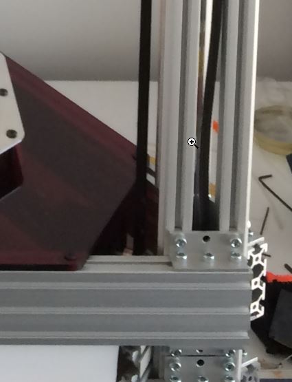

The direction of the arms is skew to the position of the front towers...?

I can't see what you mean. I did adjust the bed to be more try to the towers, if that's what you mean? I'm sure the geometry isn't perfect either. Or possibly the photo is icing a weird angle.DeltaCon wrote:Holy sh!t!

The attachment is a snippet of a picture from your Imgur pages. I can see clearly that the sides of the tower are square to the front and not rotated 60 degrees to point to the center of the printbed. However I took a closer look at your Z tower and now noticed that you are using linear rails and there are no cheapskates running up and down the extrusions. But even then I think it is a hell of a calibration job to get the rotation of the linear rail tuned, isn't it? But clearly done with great succes!bot wrote:I can't see what you mean. I did adjust the bed to be more try to the towers, if that's what you mean? I'm sure the geometry isn't perfect either. Or possibly the photo is icing a weird angle.DeltaCon wrote:The direction of the arms is skew to the position of the front towers...?

Ah, I see what you mean. I used these http://us.misumi-ec.com/vona2/detail/11 ... 733%3A%3Ag three of each for a tower, and so in the middle on the front face is another normal extrusion that the rail is bolted to. It works okay, but it's not an absolutely ideal solution. I have other ideas for if I make another one, basically tying the three separate columns together. I have an album of the printer build here: https://imgur.com/a/2A1fF the first pic shows the angle extrusion. The middle one, with the rail attached, is shorter than the other two -- something I wouldn't repeat a second time.
