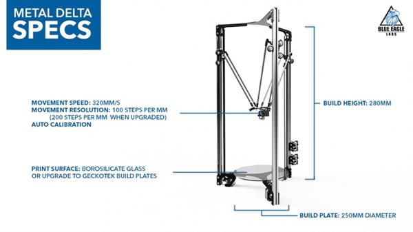

I don't mean to advertise other brands, but I just bumped into this picture. I have taken a look at the website and forum and it is really not as professional and elaborate is what I am used to here
But the idea of the out of steelsheet manufactured top and bottom pieces looks very slick and simple, and promises a lot of stability. The motors are very nicely integrated too. Does anyone have experience with constructions like this? What are your thoughts?

I'd disagree that it inherently "promises a lot of stability." There are a lot of kinds of "steel," some of which are quite ductile.
Stability also requires interaction between material and shape. The Rostock top and bottom sections are essentially built-up torque boxes. That looks like a very thin-section sheet, which may only have good resistance against forces that tend to directly pull the top and bottom of the towers apart.

@IMBoring25
Yes I understand what you are saying. I can only assume that they would use a steel alloy that is suited for the job. I don't think that the sheet looks very thin. I can't find it this instance, but one of the other pictures I saw made me estimate a thickness of 3 mm and I don't think that will bend a lot on the forces of a 3d printer (given the use of the right alloy). In fact most cartesians are built with very much thinner sheets. Also the real stiffness comes from the 90 degrees bended edges and not from the thickness of the sheet. The only con I can think of is that the fitting of the extrusions is less accurate than machined ones.
Besides all that it is not especially about THIS picture, but about the idea of the steel sections that in my opinion would make assembly a lot easier and probably stiffer. TrickLaser has a nice solution for that, but this one is probably also worth discussing.

It is in fact 3MM hot rolled steel, which is laser cut and bent to shape. My major issue with it is that the center of those spars don't have the bends which as you noted, give it rigidity. I'm less concerned by printing loads warping it than I am by transportation and picking the thing up. Beyond that, their dual extrusion hotend is very interesting, as it seems to have the filament paths merge in the heatsink. I don't think it's a great design. They also have things like Geckotek, which if I recall correctly, is largely a disappointment, and the MKS Base, which is a closed source smoothie rip-off (As Arthur Wolf stated, they are taking community work and open source code and turning a profit on it without contributing, and it seems like there's very little information besides a pair of posters who seem to be the Ebay sellers or similar.)DeltaCon wrote:@IMBoring25
So over all, it seems like a solid base design (Or at least mostly. I don't like that there's not really any enclosed space for mechanics or wiring), with some extra cost options that are dubious value adds. I would have liked to see cross bracing at the towers as well, so that it would be easier to enclose the printer and make it more stable though.

I think that the arms look pretty easy to bend meaning misalignment of the towers... If it was 1/2 the cost of a max metal it might be worth it

I was referring to the "arms" of the frame
And the "cost" to the cost of Tricklaser's frame which is around $300... Let us know your impressions

Your picture has 2040? extrusions instead of the first pictures 2020 extrusions? Can the frame be adjusted to accommodate a larger extrusion?

ugh... I mean the arms on the top and bottom plate...
but, I agree if you use 2060 extrusions they themselves are going to add a lot to the rigidity of the frame... does it come with those? In the op's photo it shows 2020 extrusions.... in yours it shows 2060s.... which comes with it?

Qdeathstar wrote: does it come with those? In the op's photo it shows 2020 extrusions.... in yours it shows 2060s.... which comes with it?
They are different printers. The Polygon is 2060
