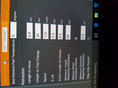

by Eaglezsoar
What are your retraction settings?
Re: Print error I can't seem to fix.
Posted: Wed Sep 07, 2016 5:37 pm
by Gundy1024
Here is what I have for ABS retraction setting. Also, while I was looking for these I noticed that for some reason my nozzle size was set to .5mm when I have a .4mm nozzle installed. Not sure how this happened unless it did it during the latest update of matter control. Trying another test print real quick to see what happens.
Retraction settings
Retraction settings
Sorry about the side ways view, not sure why it won't post it right.
