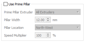

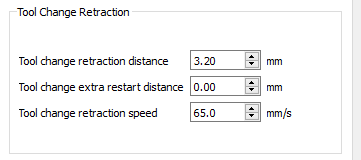

So a couple of technical questions...you mentioned the Y being custom machined from a HPV PEEK blend, what makes that special? And does the extruder constrain the filament all the way up to the drive gear? If so then flexible materials should be too difficult as long as the bowden is short, like with a flying extruder setup, right? And is the custom switching code useable in other slicers? I'm specifically thinking Simplify since they have some features I use regularly and does have support for custom code on tool change triggers.
Re: The Prometheus System - Intuitive Multi-Filament 3D Printing!
Posted: Mon Sep 05, 2016 11:18 pm
by RP Iron Man
@Glacian22
The Y is actually 3D printed from Nylon Alloy 910. The "Filament Guide" is the part that connects the Y to the hot end and is custom machined from KETRON HPV - Bearing Grade PEEK. There are a number of reasons for choosing this material. Our early prototypes used machined PTFE, but due to accelerated wear on this component, the part had to be replaced after every 4-5 hours of printing! In addition, PTFE is very difficult to machine accurately. KETRON HPV PEEK plastic is an interesting composite material that consists of a blend of graphite, carbon, PTFE and PEEK plastic. It was the only material that could meet our requirements for wear resistance, low friction, machinability, and thermal stability.
As for the extruder: Yes, it does constrain the filament up to the drive gear so flexibles should work with a short bowden tube. Just keep in mind that there is also a (short) unconstrained portion where the two filament paths from the extruders meet in the Y connector. For this reason, I would think that semi-flex would be a better option.
As for the Slicer. I do not have Simplify 3D so I have only tested with CURA. However, there is no reason why it shouldn't work with Simplify 3D! The only requirement is that the slicer needs to be able to support a prime tower and have user configurable tool change G-code :) Depending on your setup you could also use a dump zone instead of the prime tower.
I hope this answers all of your questions!
Posted: Tue Sep 06, 2016 9:09 am
by KAS
S3D supports both the prime tower and adjustable tool change retractions.
