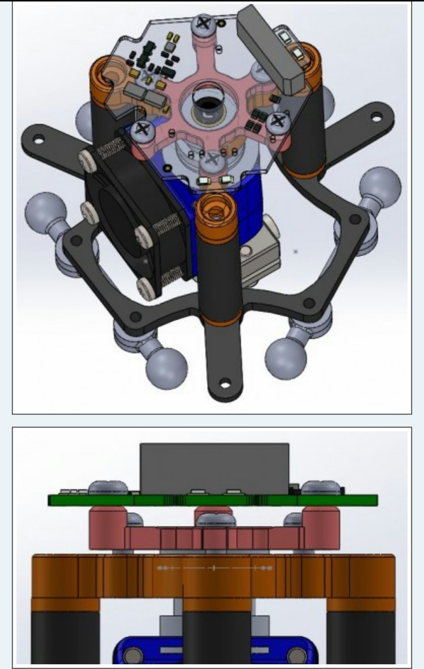

I was considering making the board hole much wider (+/- Ø16mm), so it could pass through the V6 j-head.
But I don't know if that would damage a circuit or somehting.

Should be able to mount board above the standard groove mount with stand-offs, then simply pass the bowden tube thru hole in center of board.

the lock ring mount holes do not line up with holes on board, the probe board has 3 holes that match spacing of standoff holes on platform (50mm dia. circle, 3 holes equally spaced.) So that would be the mounting points. The platform standoff spacing has been the same since V1. So that means probe board mount holes are backward compatible with any mount/platform.
edit,
I was wrong the three mounting holes in probe board are not the same as standoffs. with a pocket scale they look to be about 7mm in farther.
I picked up parts this morning, fitting things up now.
Looks like I will need to draw & print an adapter to mount probe pcb above groove mount.

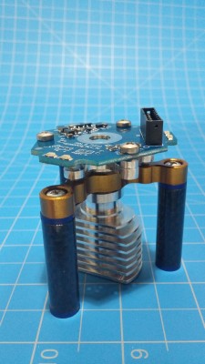

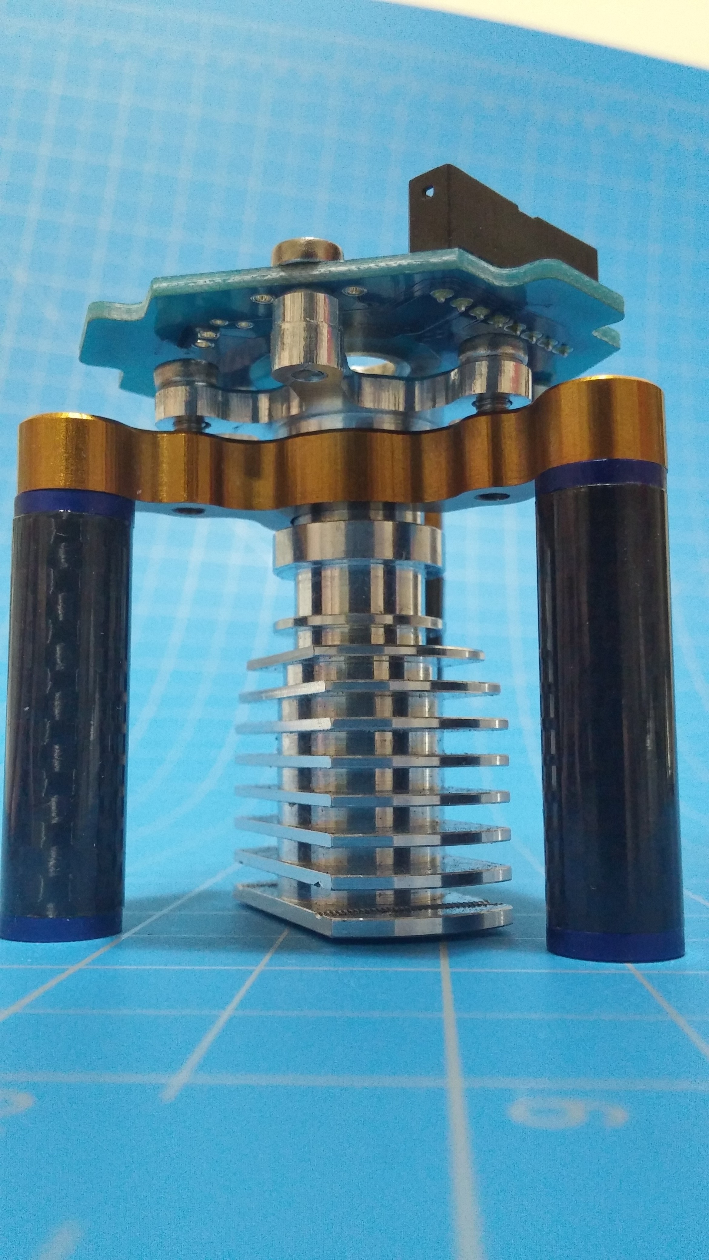

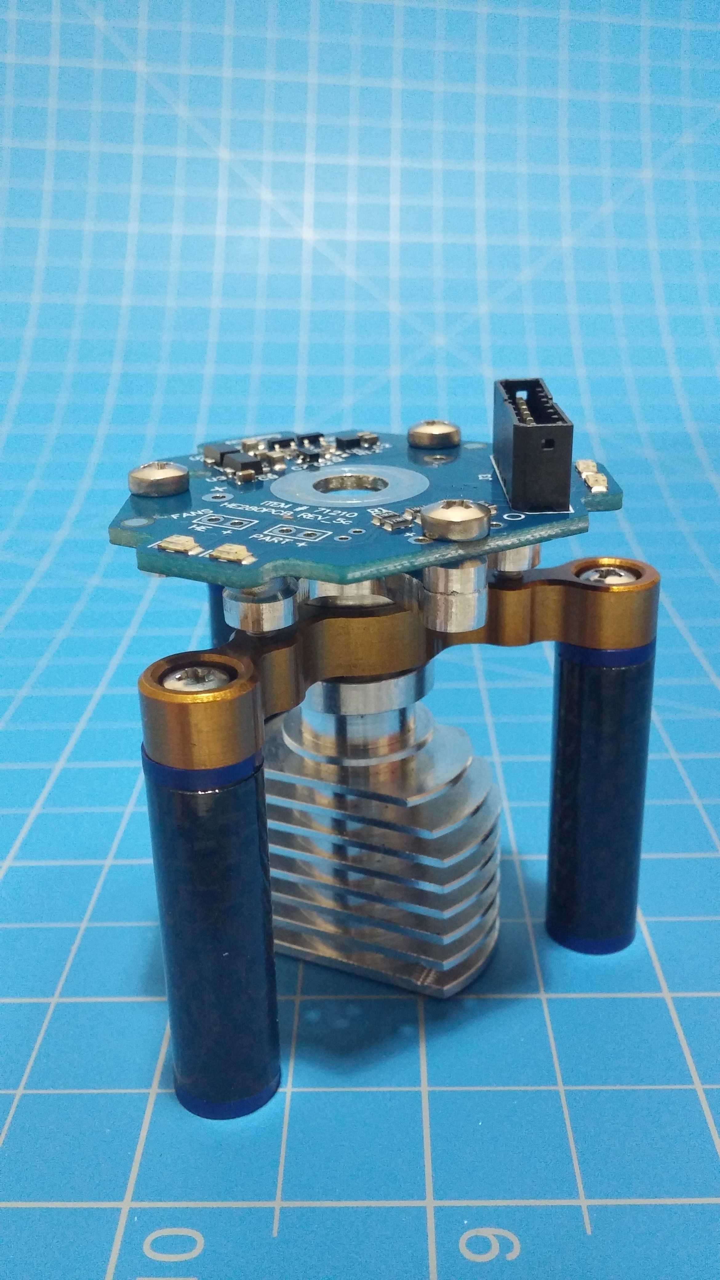

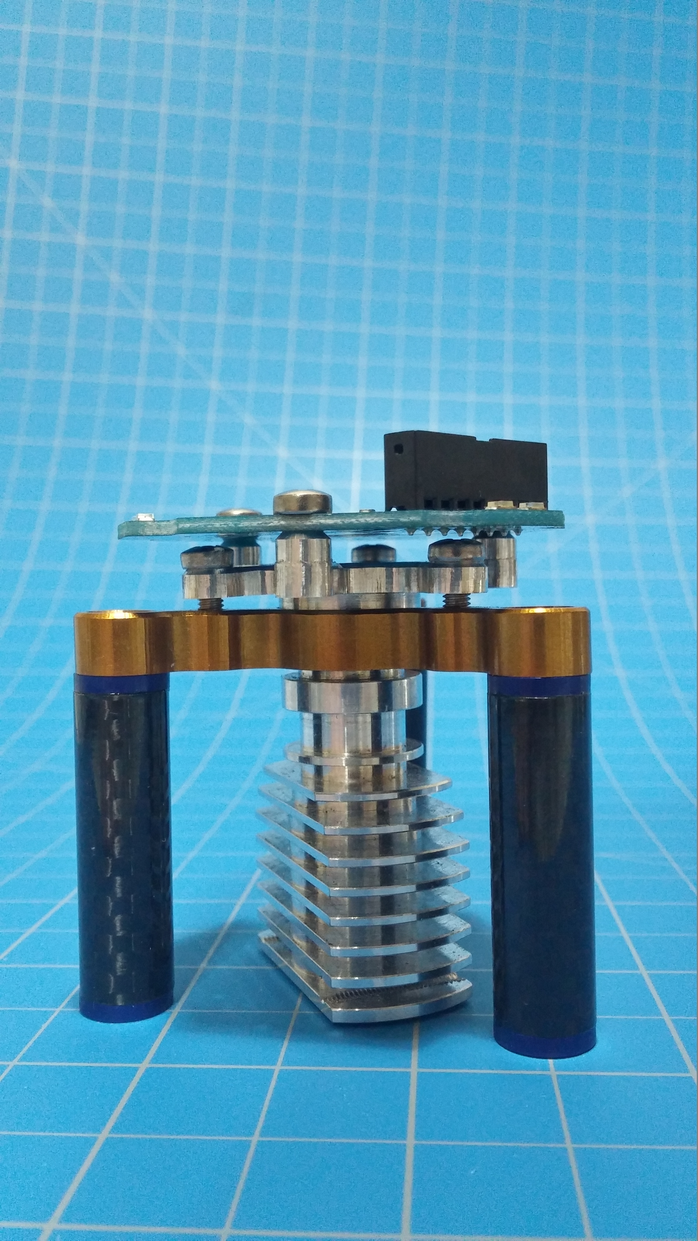

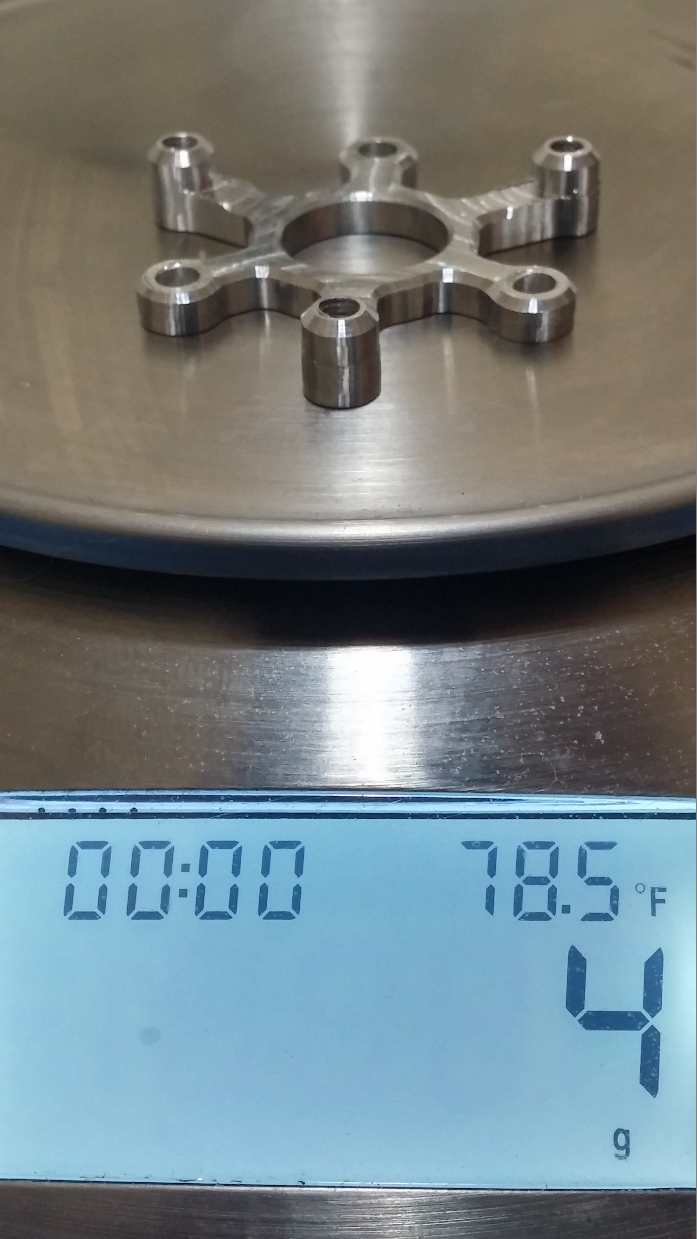

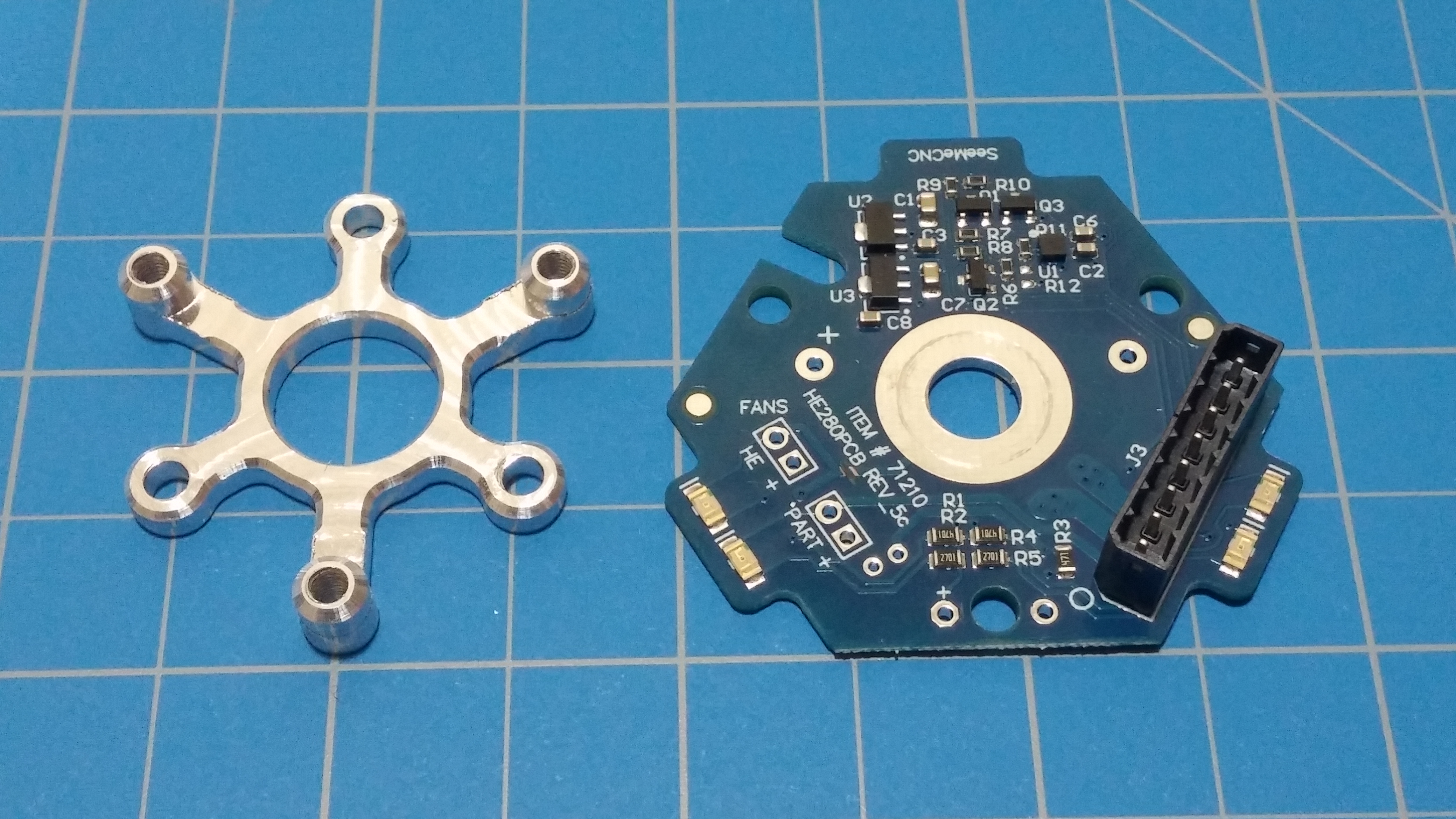

Hey guys, I will be making a new style lock ring for the probe board that will allow it to mount up and be fully backwards compatible with our mounts. I have been very distracted with a huge project on another printer for a full metal conversion kit on the FT5 so i have not been around much, for that I am very sorry. Steve and the guys at SeemeCNC hinted a V3 might find a way to our doorstep so we could work on some new mods and make sure we could keep our mounts working with the new calibration board. I think I found the IGES files for the board the other day and when I have a chance I will look at it more. The spacer idea works great from all reports, but we want to make sure and offer a solution that firmly holds the board in place moving forward. As soon as I have a chance I will post some pics and we will work with folks who want the new adapter with our existing mounts much like we did when our effector plates came out. We want to make sure our products work as well as they can for all our customers as SeemeCNC continues to drive the art of 3D printers ever higher.

New calibration adaptor prototype will mill in the AM. Full metal adaptor replaces our standard lock ring. Should have them out for testing shortly and on the site in short order.

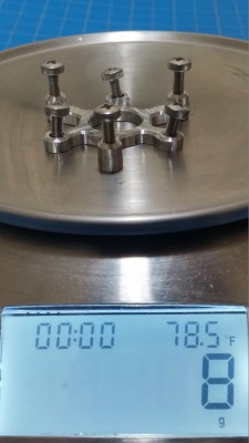

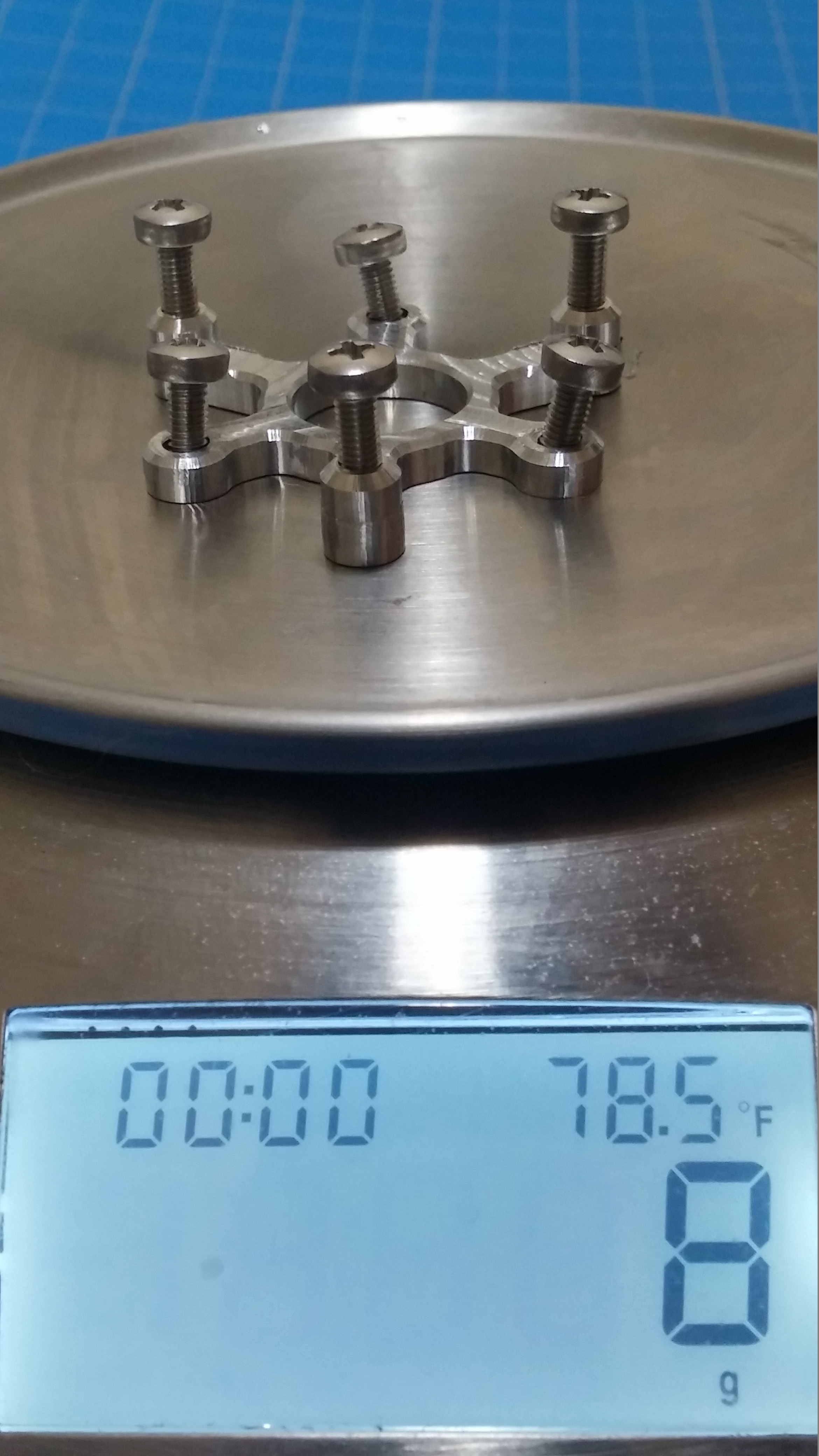

Here is the first prototype mount for the HE280 calibration board for the 713maker mounts. 4 grams alone and only 8 grams with screws. It replaces the standard lock ring and will be a standard option with all kits shortly. We are sending out a few test adaptors shortly and should have them on the site by Monday of this next week. We might still make a few changes to the design, but we have a great start already. For those who have already bought our kits, the rings will be listed in our store for around $5-$8 and we can offer first class mail shipping to save on such a small part.
