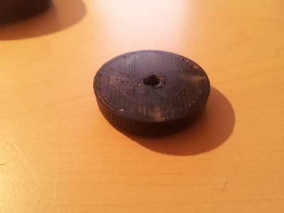

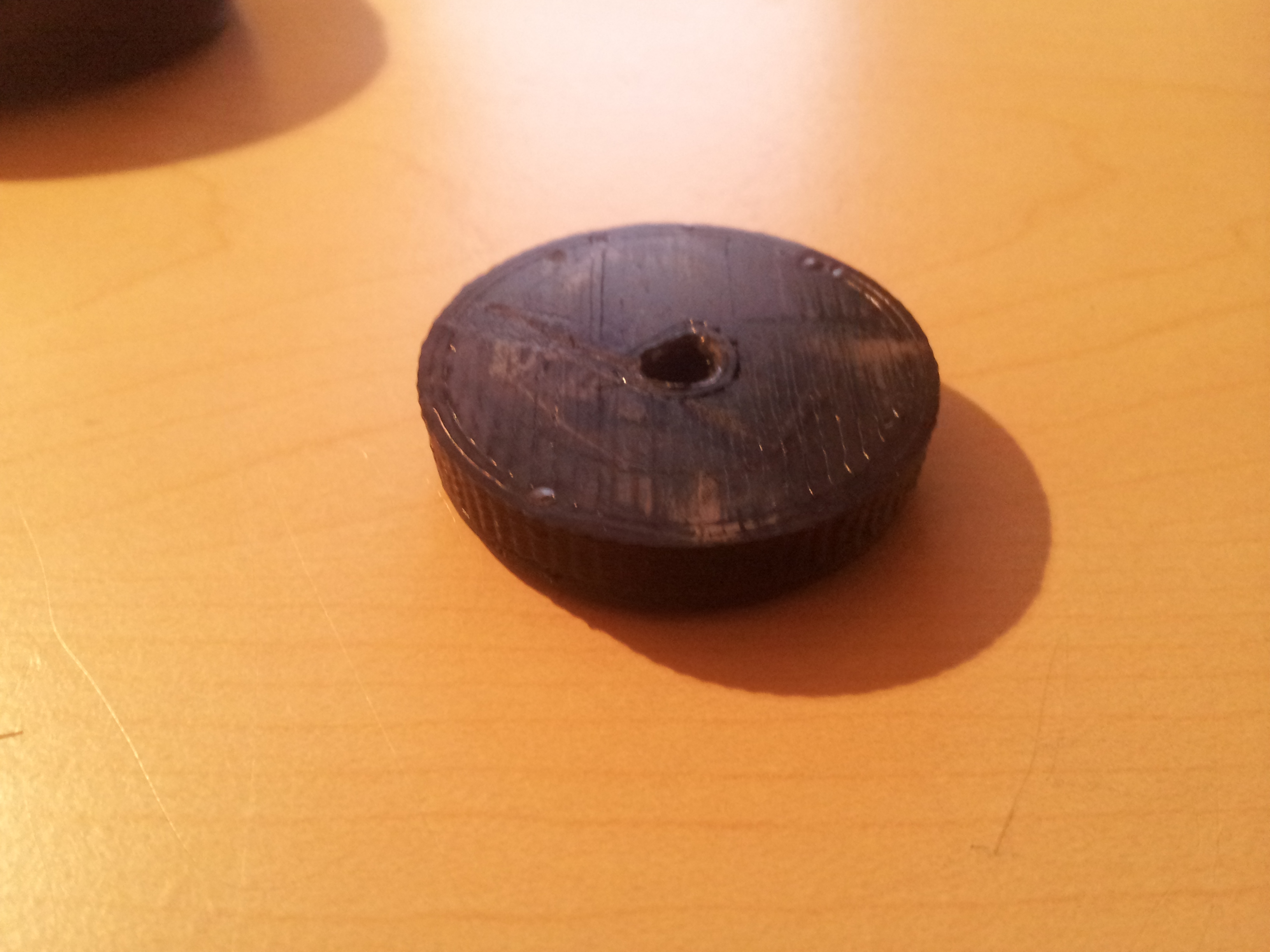

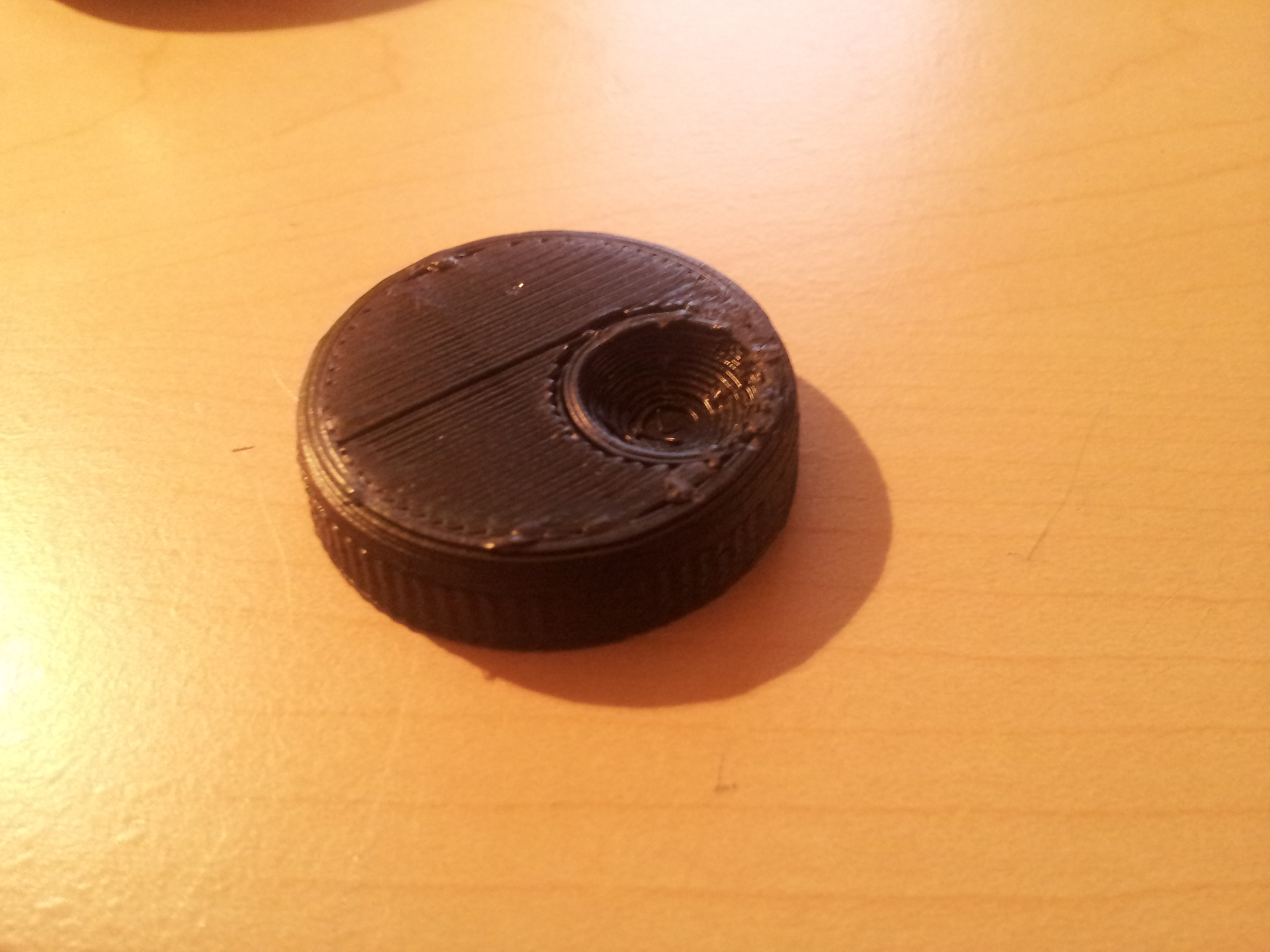

ps. these are pics of my first completed print (as in the first to not back up in the middle of the print)

Yes!! I'm super excited for what is to come, but i still can't find polygonhell's part. If anyone could send me the .stl for it or something that would be great! I'v tried tweaking many settings, but I still can't push it out at more than 20-30 mm/s speeds without the filament coming out the side of the extruder! Otherwise, things are good, there is warping in my buildplate tho, i think ill get a piece of glass cut for that.
bhesson
bhesson
Re: New Rostock Max User (Has a problem)
I got Polygonhell's extruder cap from here. I had to file the inner hole a bit until it lined up smoothly with the little hole above the rollers in the extruder. No filament jams in the extruder since that day 2 weeks ago.
