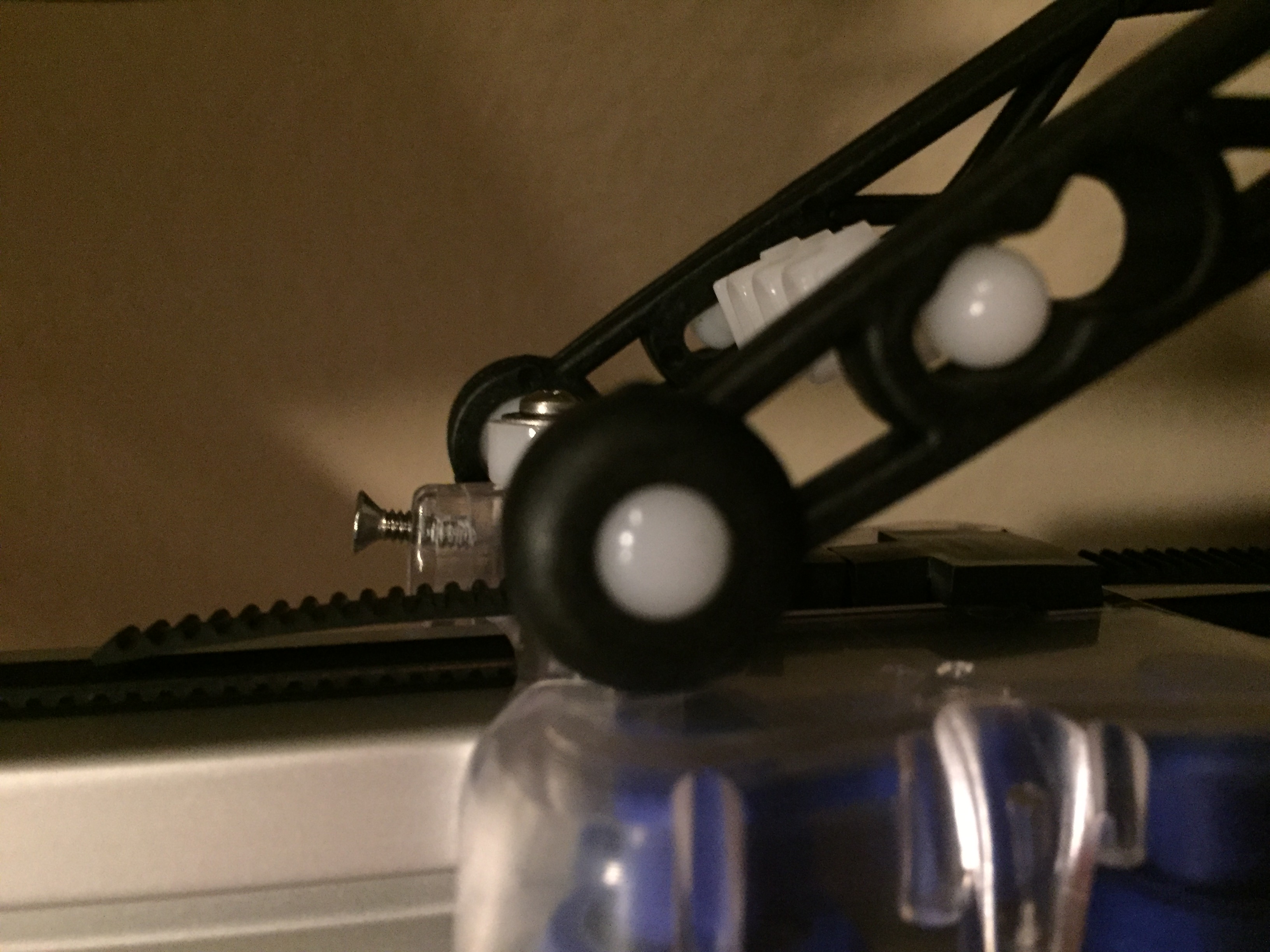

Hey everyone. I am a first time printer builder who just finished the V3 printer. Unfortunately I seem to be having an issue with the flat head screws on the carriages engaging the limit switches. I initially noticed the the screws were tilted back away from the carriages and suspected that might the issue but I have since fixed them and they still do not engage the actual switch.
This is the initial placement I had and below is my fix to try to solve the issue.
I know that the switch is not blocked as I can engage it with a screw driver. Has anyone else had this problem and found a good solution? If I don't plan on using the maximum height of the print with this end up causing my a problem?

Can you take a picture of how the screws line up with the levers on the switches at the top?

I am not sure exactly of how to take that picture, there is almost no room and zero light that actually see whats happening but I will make some attempts.

I ended up getting some longer screws for mine and screwing them in further to make sure they were vertical.
Re: Limit Switches not engaging
The screw should be 3/4" long - if it's not, bug SeeMeCNC about it.
Some of the early kits may have gone out using the pre-packed carriages for the v2, and those screws were only 3/8" or so.

also make sure to remove the silver switch arms.
Kevinvandeusen wrote:also make sure to remove the silver switch arms.
THIS. A million times, THIS.
I wasn't aware of that until AFTER my build was nearly done. I was highly annoyed when I found out I had to partially disassemble the machine to get at those stupid levers. I made sure to update the docs with an uppercase warning when I discovered this.

geneb wrote:The screw should be 3/4" long - if it's not, bug SeeMeCNC about it.Some of the early kits may have gone out using the pre-packed carriages for the v2, and those screws were only 3/8" or so.
I did find the note to remove the silver tabs so that wasn't a problem I had to deal with. I managed to find a left over set of 3/4" flat head screws and those solved the problem perfectly.
I found that two of my limit switch screws would not enter the channel leading to the limit switchs. Rather than try to realign the screws or ream out the holes, I ground a bit off the screw heads. Now there is free movement through channel.
