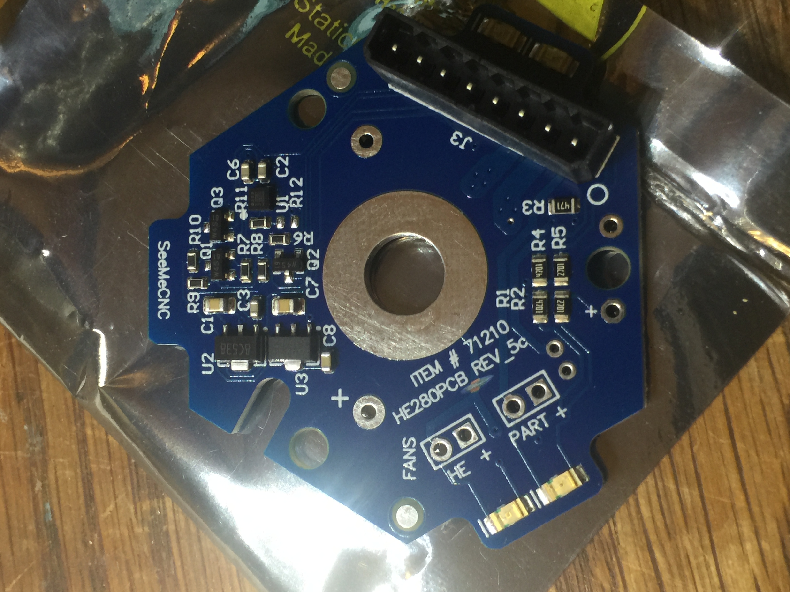

One issue i did run into was that it seems like the spacing between the mounting hole and the led pins is too close. This represents a dead short, definately need a nylon washer... maybe on the next revision spread the holes apart a bit.
