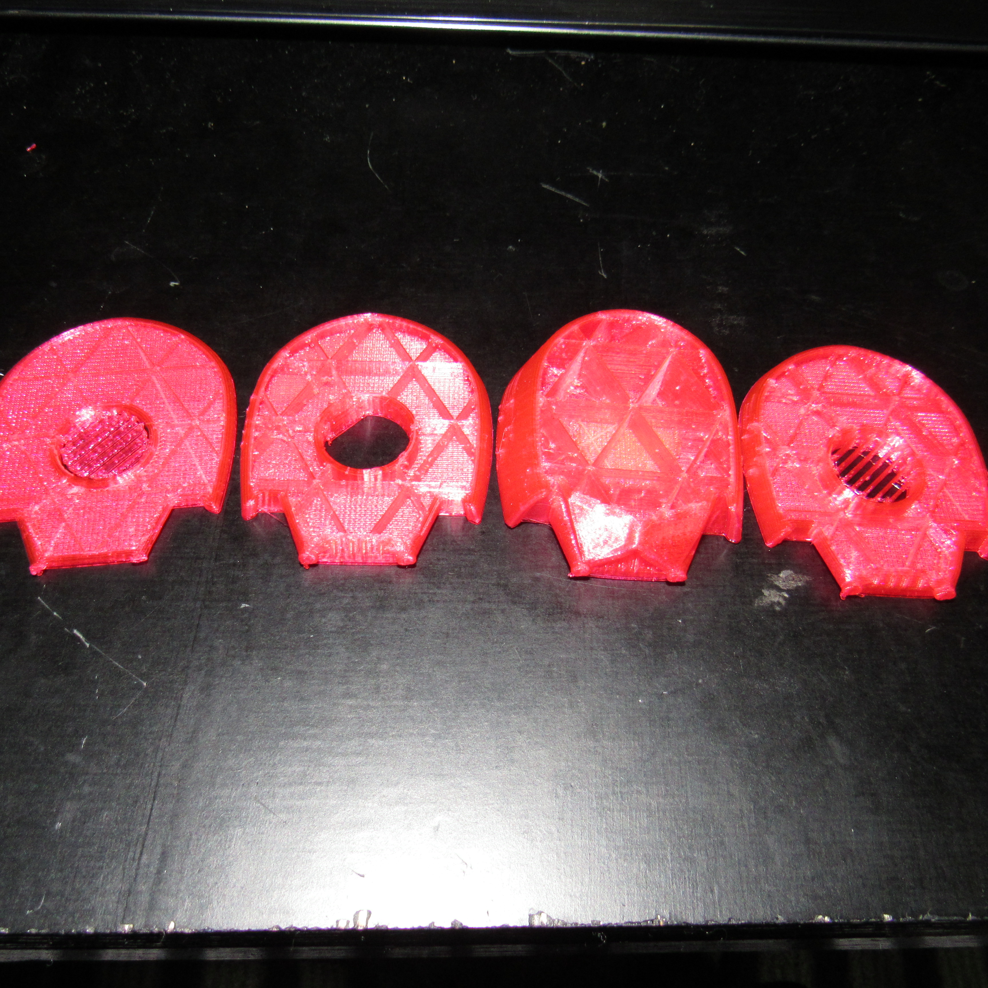

Hello All,
I am trying to calibrate to print my several PETG rolls. However I have an issue I cannot with random globbing in and on my prints. The following are several attempted prints with slightly tweaked settings to see if the globbing would go away with no luck.
Here are the settings I am currently using:
Hope someone has a golden tip on solving this issue.

I use a 255C hot end for PETG but you may not want to do that depending on what hot end you're running.
Re: PETG Calibration
Posted: Mon Oct 17, 2016 1:01 am
by javiercordero20
IMBoring25 wrote:I use a 255C hot end for PETG but you may not want to do that depending on what hot end you're running.
I tried playing with the temperature but that doesn't solve the zits/globbing.
Posted: Mon Oct 17, 2016 8:27 am
by mhackney
I can't tell if you are using MatteSlice or Cura, if MS switch to Cura. If Cura, seriously consider KISS. KISS has a "crossover" perimeter start/stop path that really cuts down on zits. It's the only slicer that does this.

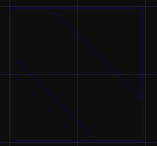

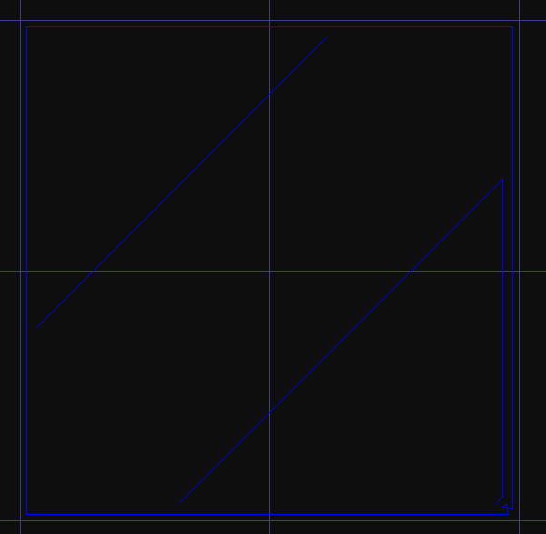

by javiercordero20
Hello,
Here is the test cube that I printed using KISSlicer. It has some weird artifacts on two of the four corners and the bottom layer looks bad due to not being primed enough. (the top of the image is actually the bottom layer)
In the slicer I noticed that when I look at the layers. I see the following which seem to line up with the weird artifacts I see in the cube.
Posted: Mon Oct 17, 2016 4:39 pm
by mhackney
Are you talking about the upper right corner on the top image and the lower right corner on the lower? That is KISS' method for preventing perimeter blobs. You can control that on the Style tab with the Depth and the Seam Hiding Gap settings. Jitter will randomize where seams are. The PDF manual file I've linked to show how to use these with examples. Page 15 in my copy of the manual. You can turn it off, make it bigger, smaller, etc.
You can also control the print speed with the Slider on this tab. It scales all of your speeds as you adjust it. The resulting speeds are displayed on the right lower corner of the window.
