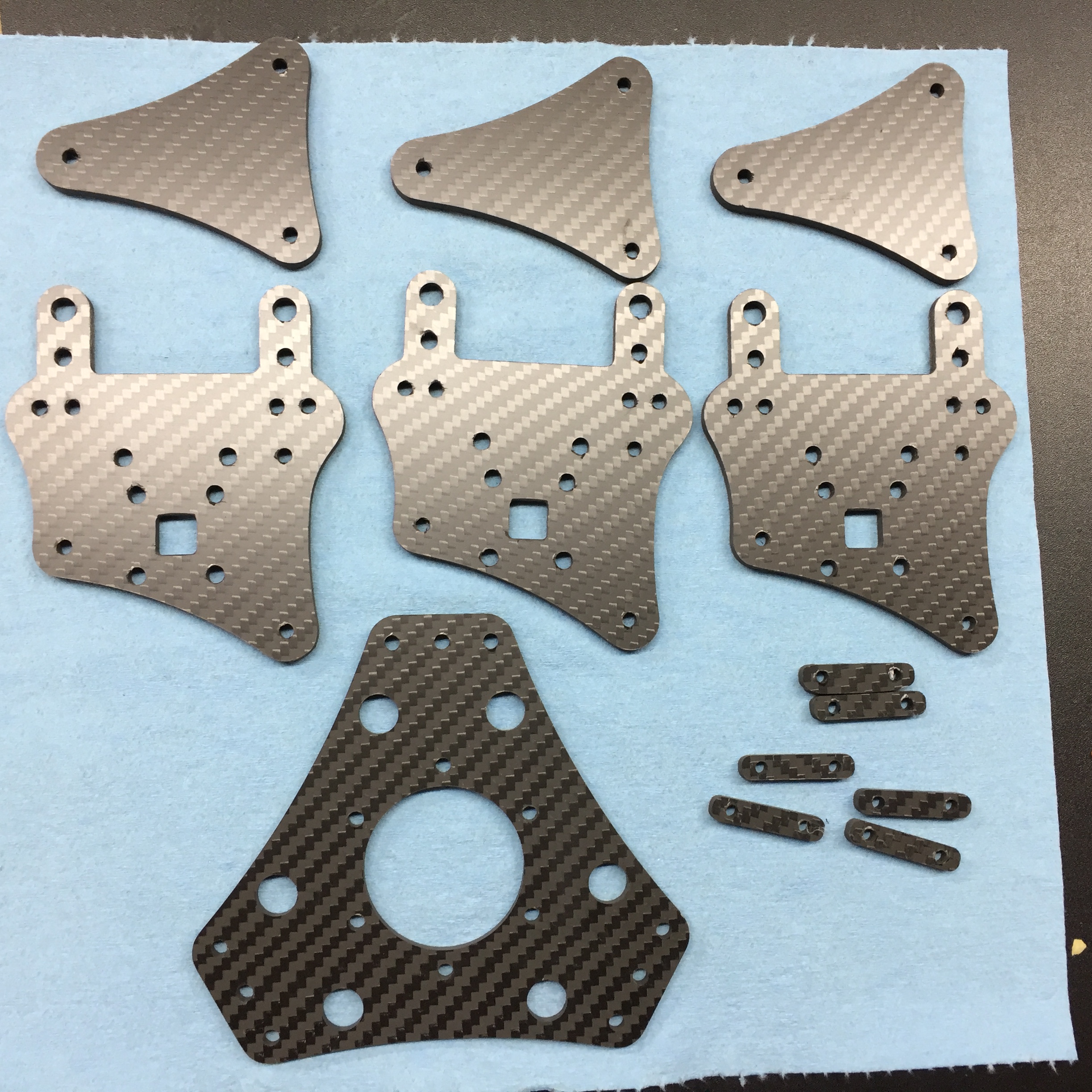

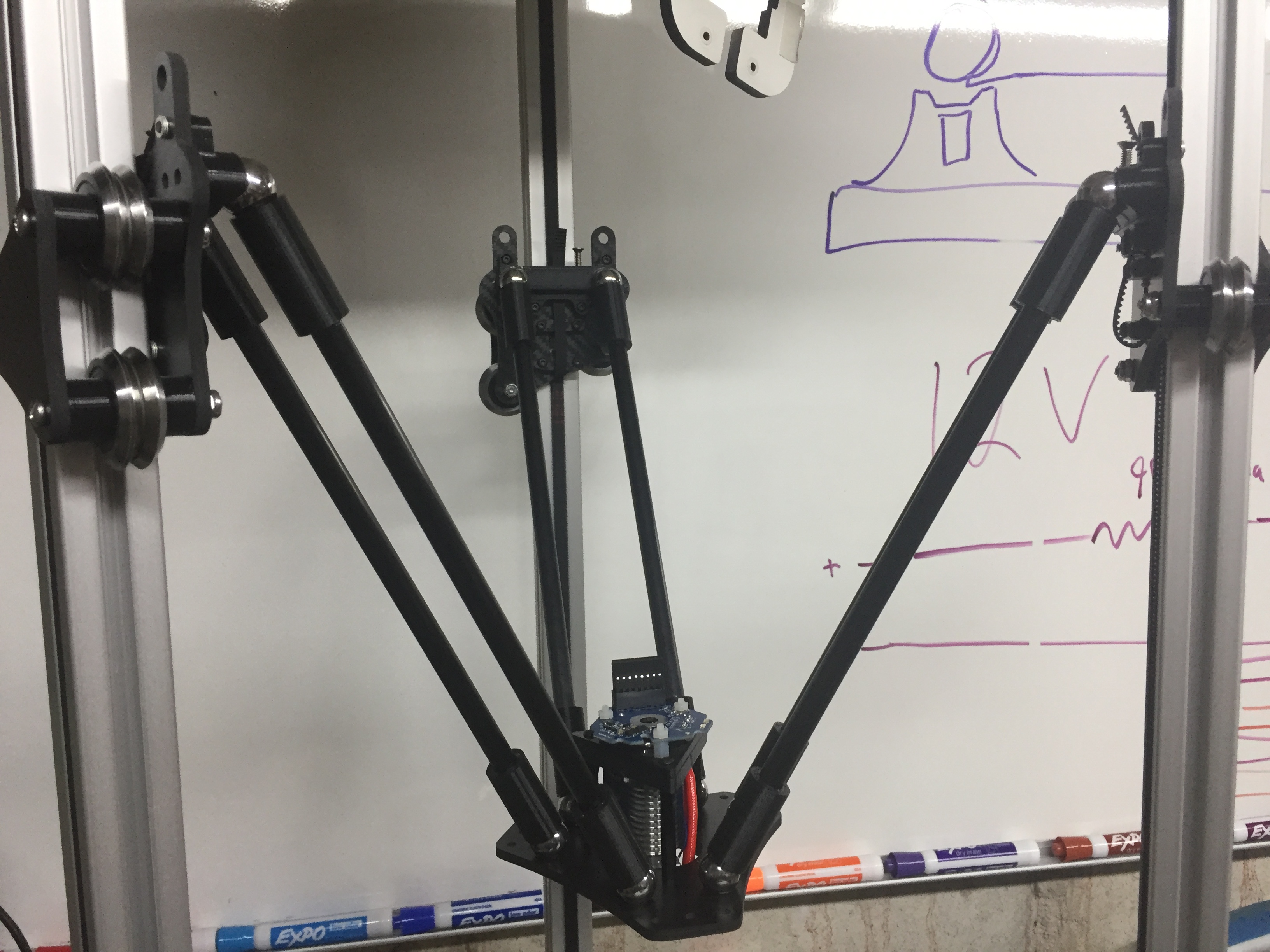

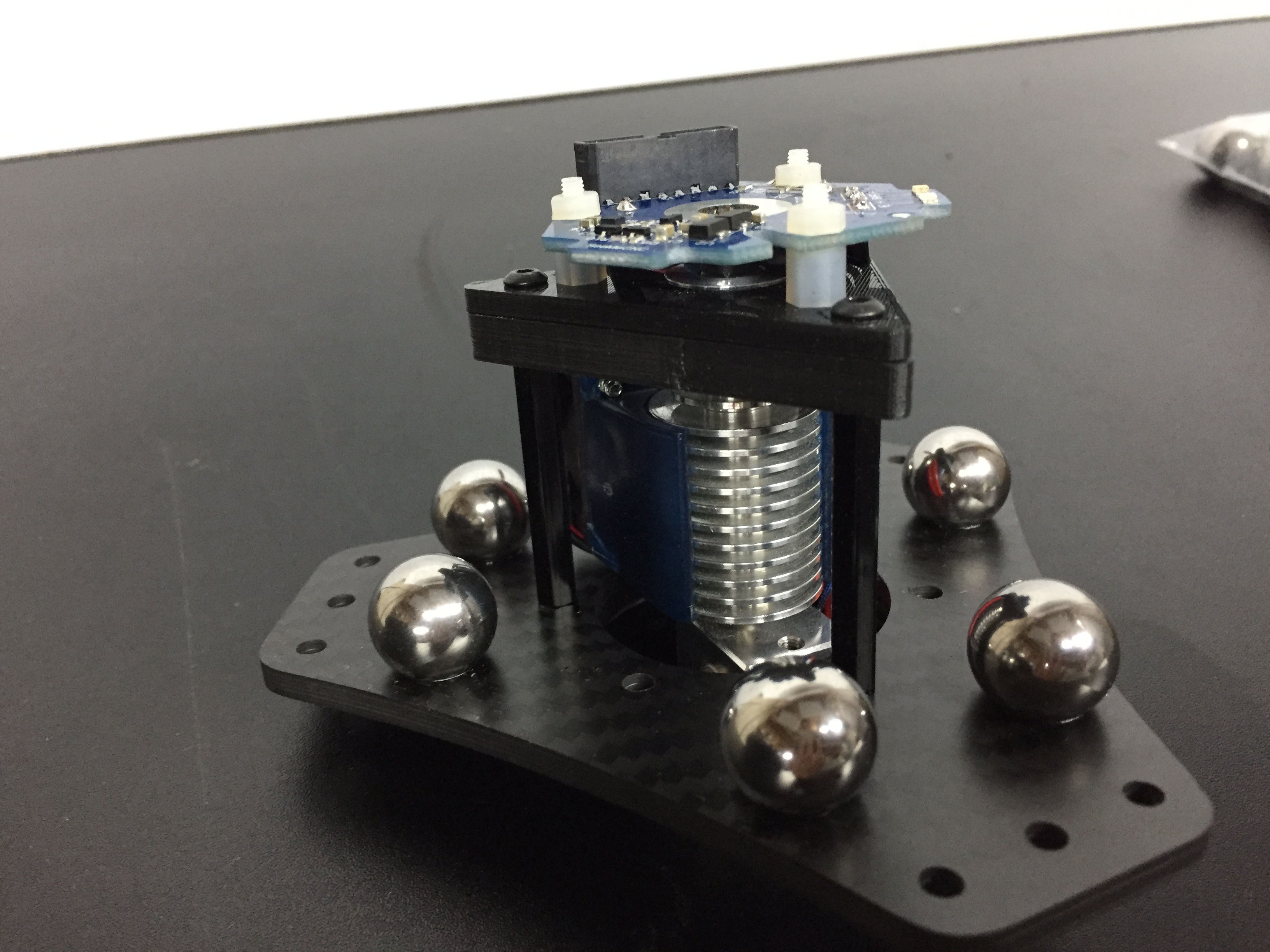

I've recently did a major overhaul on the Rostock v2 we had in the shop. The arms, carriage, effector, and extruder all got a pretty big upgrade.
Long story short, I created a bunch of parts to make the entire moving end of the printer very rigid to help with small detailed prints.
Sort of a long write up so I did it in PDF format. Browser kept losing my drafts :cry: You can download and see the whole process below.
Rostock V2 Mods.pdf
Lots of pictures, so file size is a little big
(21.44 MiB) Downloaded 539 times

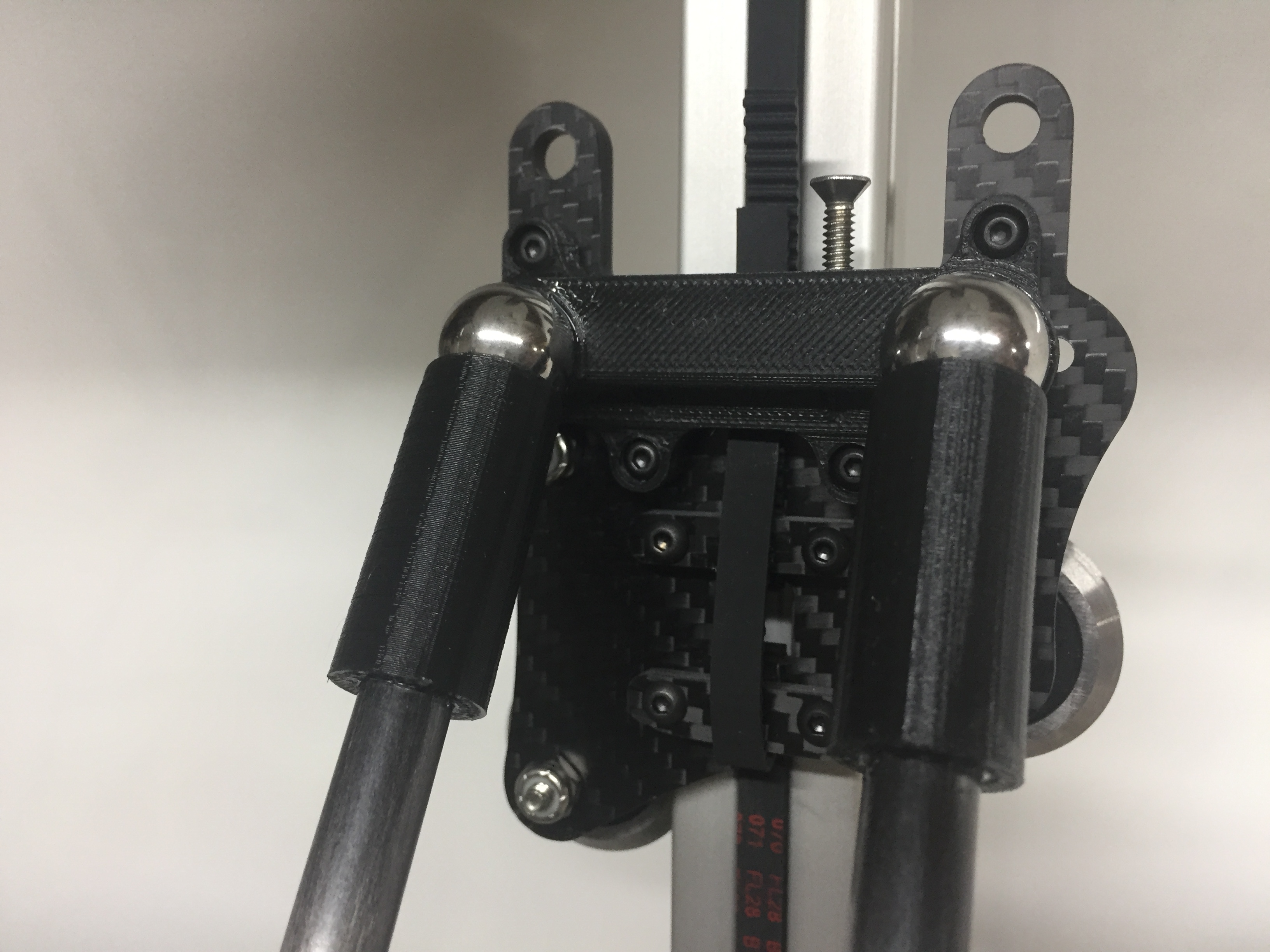

Just curious after seeing this and some other custom carriers(Skates)
Since the weight is pulling inward, wouldn't it make more sense to have the bearings on the rear and front of the towers vs. the sides?

TwoTone wrote:Just curious after seeing this and some other custom carriers(Skates)
The issue with having a bearing on the inside is that when you print at the base of the tower, the arms will hit the bearing. The arms will be 90º straight down at that point, which means everything under that pivot point needs to clear the moving arms.
So the inside bearing could be above the arm and the other two would be in the rear

by Hobby Creek
You'd then need to put the endstop screw above the bearing which cuts into your print height. And the single bearing would want to be positioned between the two opposing bearings. You could make it work but for that much effort, I'd almost rather just switch to linear rails.

I was originally just going to switch to carbon arms, then one thing led to the next and before you know it, I tore the whole printer apart :lol:
They definitely have some cool upgrades and I referred to them on some concepts. Kinda made it my own as I had the carbon and a router. Took about two weeks to design, cut, and reassemble. It was a big project but fun seeing everything come together.
