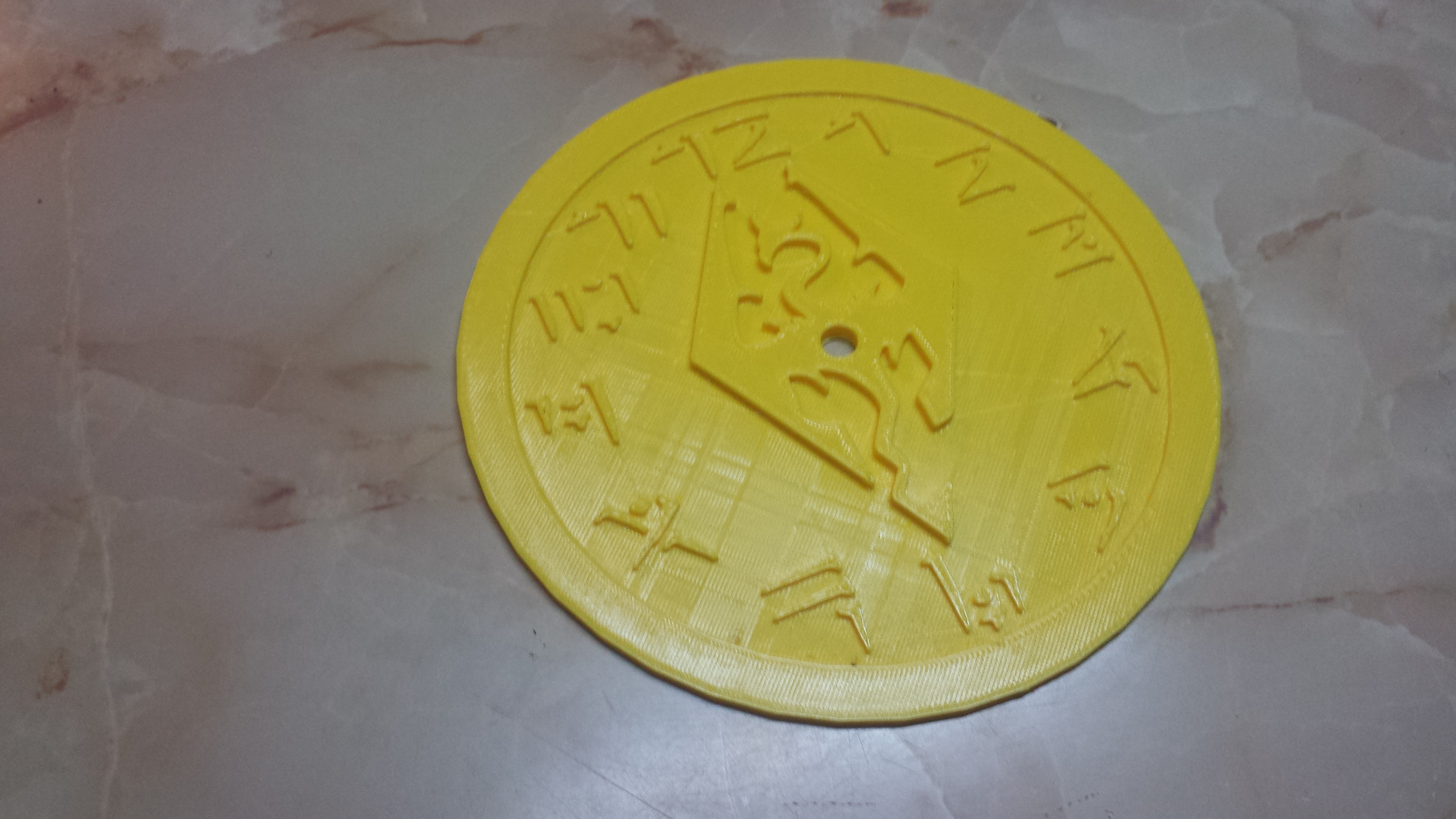

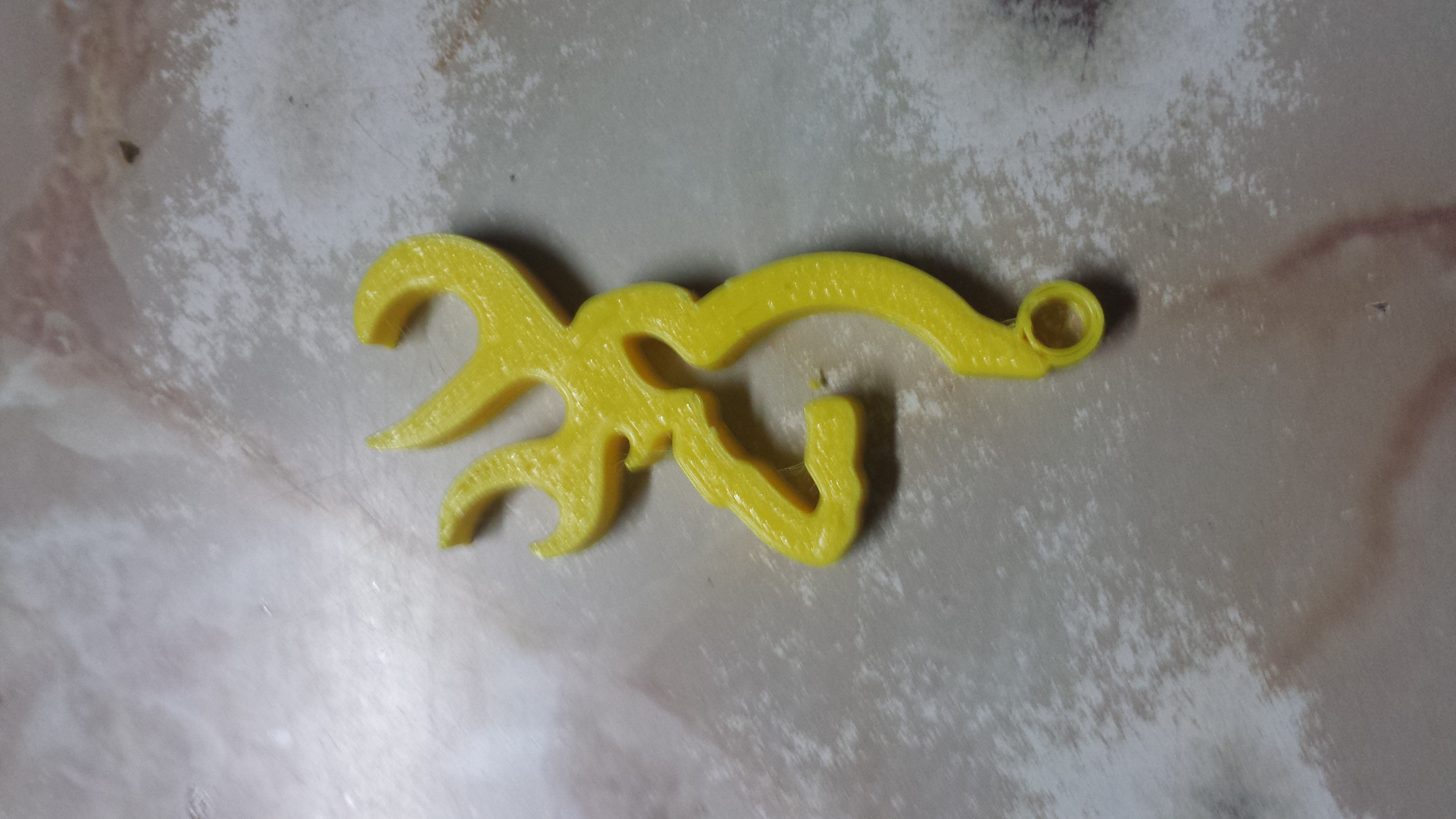

I been printing fine until yesterday I notice it wasn't printing well. I print about 60 hours or more into it and was working great. I clean Nozzle tip, Use thin wire to clean inside of it and check the wire . Seem like it having issue melting the abs filament. Is there some troubleshoot I can use or it is just the hotend need replacement. I try different filament but still does the same.
This is what I been printing and other things. This is what happening. I try different filaments.

Assuming you haven't made any setting changes, the most likely issue is something partially blocking the nozzle.
Most commonly this is an impurity that was in the plastic, or possibly some bur in the hotend itself that got dislodged.
You can sometimes fix these without having to disassemble, Nylon filament is commonly used for this, basically the procedure is to heat the hotend to say 240C insert the nylon by hand until it just extrudes, drop the temperature to the coldest point you can still pull it out (probably 150-180C ish) and pull the filament out of the hotend.
The idea is to trap the particulate or anything else in the filament and pull it out.
The harder way is to remove the nozzle, and inspect/clean manually
Without knowing exactly how the E3D clone you have is constructed it's hard to offer any other advise, I've seen them with and without PTFE liners, if it has a liner then if it's not correctly reporting temperature then the liner can get damaged and lead to the same thing.

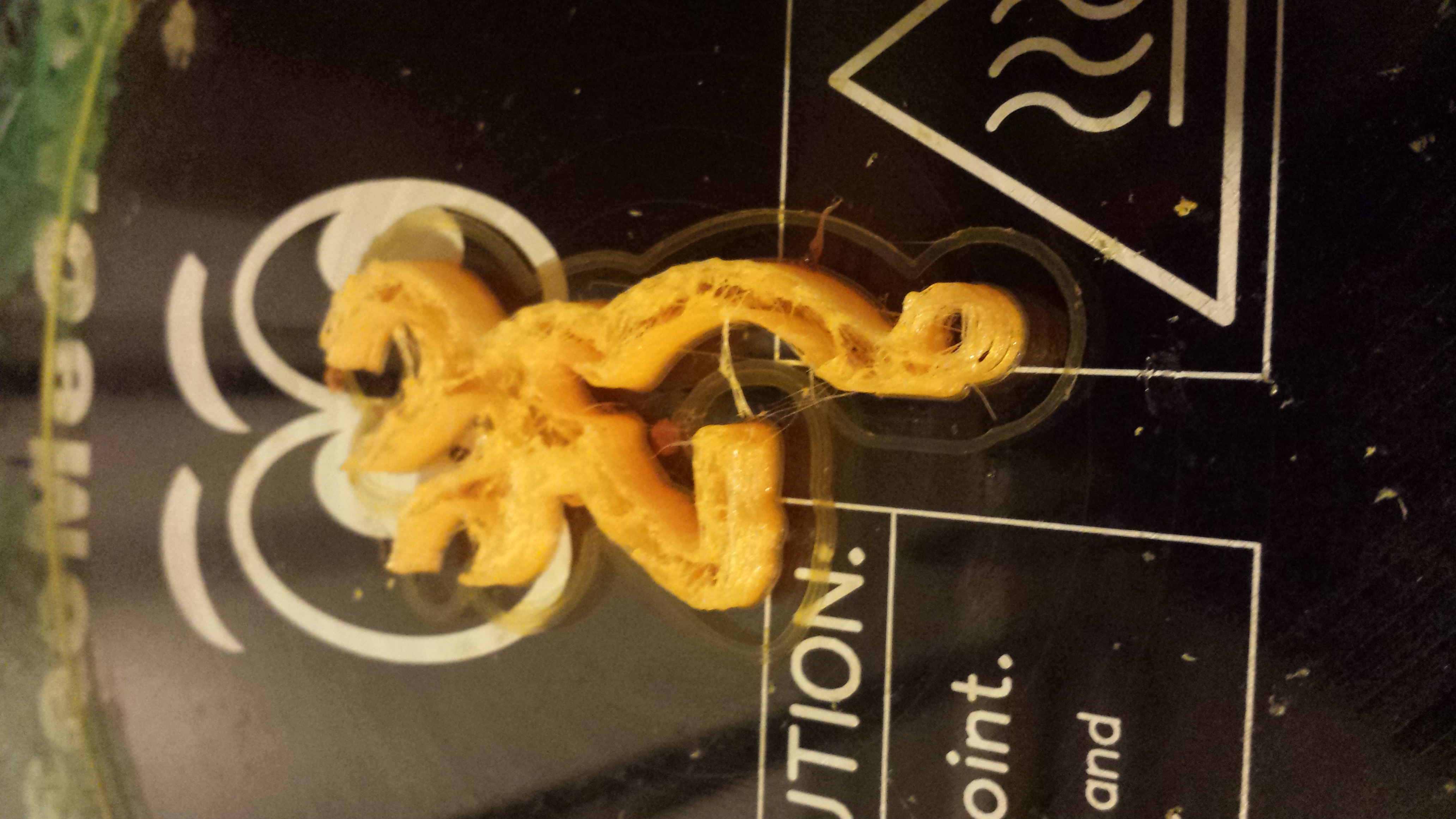

I try method I found online using Nylon Didn't work I disassemble it and put it jar and added actone for day. It clean inside. I put it back still have issues melting the filament. I remove hotend and install new one hotend. Look like it still have having issue melting the filament. Can it be wire or there not enough power feeding to the hotend.
Re: Issues with J-head V6 Hotend
This is with other hotend. It only printed the layer you see and than it stop. I try it with different models stl but does the same. It one of those bad days for me.
