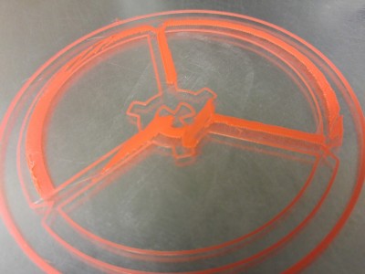

Seems like I have been exchanging one problem for another for about a year now... Getting time to get some descent prints now! What could be the cause of the behavior in this picture? The nozzle does some strange lifting even if still in the first layer. I have already checked the belts and tightened them from scratch when I was getting the towers aligned yesterday.
The bottom left leg of the ring is pointing to the X tower.
I was wondering what's the best way to check the gears slipping and how to tighten them without dismantling the whole thing (again).

You should be able to check the setscrews for the timing belt pulleys on the motor without having to disassemble much.

Is all that infill shifted itself over/away from the X tower?
It looks like theres some adhesion issues too?

Could be number of things, the set screws on the drive gears are certainly worth checking.
But it could just be too much speed/acceleration or jerk in the firmware, as you print at the edge of the build area, because of the delta kinematics the carriages have to move at almost 2x the commanded speed, that is makes axis much more likely to skip steps.
After you've checked the screws, if that isn't the issue I'd just try reducing the travel speeds and halving the acceleration and Jerk to see if that addresses it. Once you get a decent print, you can try edging them back up, I'd start with getting the Jerk back to default settings and go from there.

Mac The Knife wrote:You should be able to check the setscrews for the timing belt pulleys on the motor without having to disassemble much.
I was hoping so, but I think they cannot be reached without lifting the top baseplate, can they?
Turpinator wrote:Is all that infill shifted itself over/away from the X tower?
Yes you saw that right. It is not because of adhesion problems though, because I can see the the nozzle multiple layer thicknesses above the bed almost spraying the filament to the bed and it still sticks.
Polygonhell wrote:But it could just be too much speed/acceleration or jerk in the firmware, as you print at the edge of the build area, because of the delta kinematics the carriages have to move at almost 2x the commanded speed, that is makes axis much more likely to skip steps.
Yes I have thought of that too. But the printspeeds here are really low already like 30mm/s or so, and this is the small version of the calring so it not going near the edges, but halfway at most. But it is worth checking the jerk and acceleration values for sure. Happen to know the defaults for a V2?
This is happening after an attempt to get rid of tower lean, I also redid the belt tension, but I cannot say that it changed much compared to before. I might have touched the skatewheels tension to, because I noticed a few that were not rolling during movement. The skates go up and down as easy as before, except fot the Z tower that seems to drop a bit on its own weight when steppers disconnect. In the first attempt to print this the effect was a lot bigger, where the hotend swung into the air when going to the Z tower, and coming down again when travelling away from it.

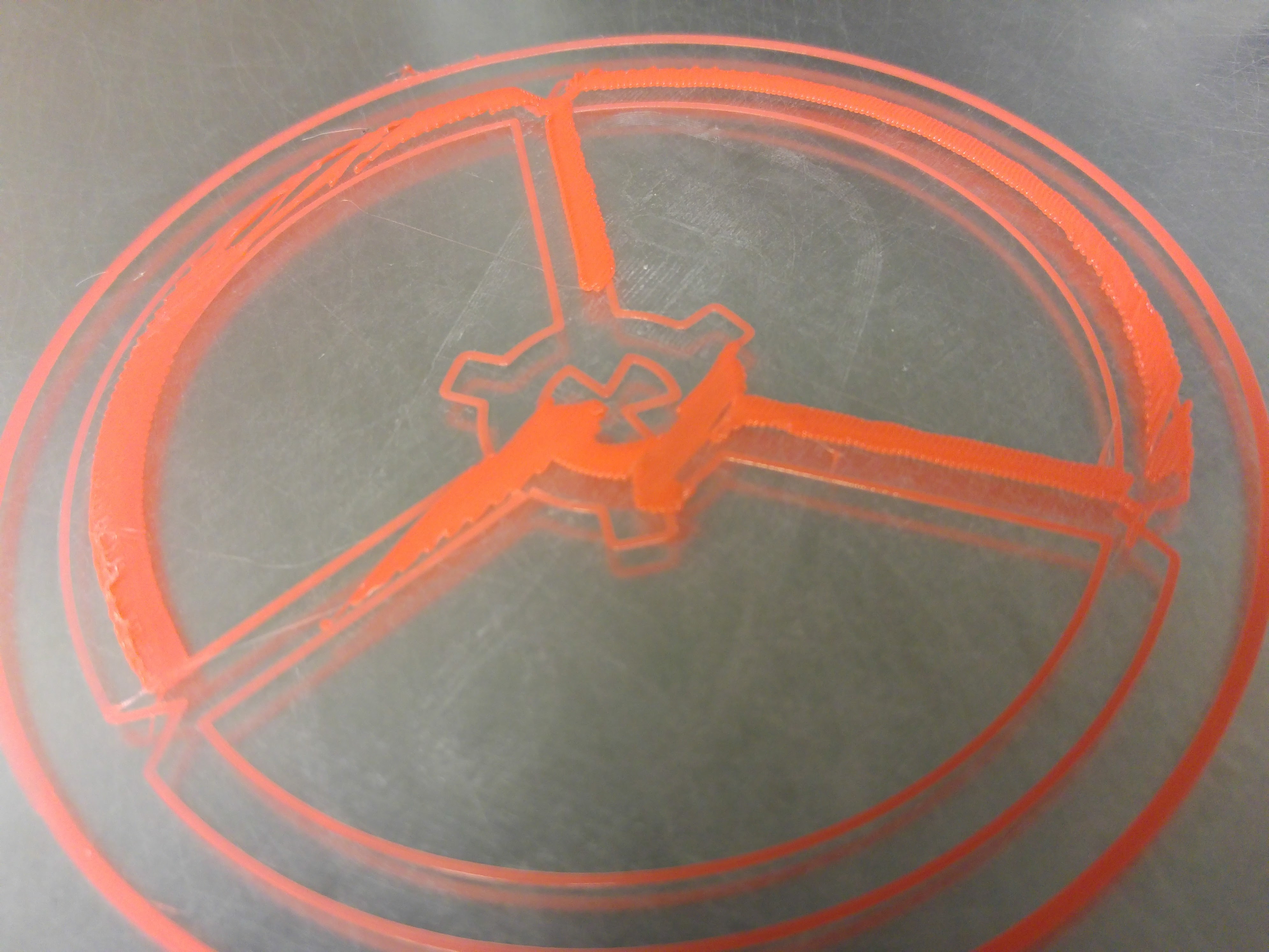

The issue already made printing impossible, but it seems to have gotten a lot worse overnight...
As in my previous post I checked the pulleys, and all setscrews were as tight as I dared turn them. There is certainly none of theme loose, so I think I can rule out slipping gears.
https://youtu.be/8guDPog42Gk
This shows exactly what is happening after I start a print. The next video shows proof of how my printer is behaving when manually moving around.
https://youtu.be/Nk0yIC4NGrQ
It shows that Z=0 gets set. I filmed that horizontal movements do go okay when done by hand sending gcode. Also I show prove that at z=0.3 (first layer height) the paper drags nicely below the hotend. I tried to film the teeths of the belt at 10 to 15cm below the hotend, because that's the position where they are at the gears when the hotend gets near z=0. As far as I can see (the movie is hard to get focussed) they look okay and not flattend by grinding or anything.
So... What did I forget to check? Why could the hotend dive into the bed? This is making me mad!

It seemed like it was attempting to do calibration at the beginning of the print. Would you mind posting a sample of the G code you're generating, say of the 20MM cube?

Its printing into the air on the first one because its ram jamming the head into the plate, causing the motors to skip steps, ie not move when the board thought they moved.
Figure out why its jamming itself into the plate (gcode/software issue, most likely, 99.99%).

Turpinator wrote:Its printing into the air on the first one because its ram jamming the head into the plate, causing the motors to skip steps, ie not move when the board thought they moved. Figure out why its jamming itself into the plate (gcode/software issue, most likely, 99.99%).
Yes I noticed that... ;-) I used the same gcode that was generated by repetier as in the picture I started the thread off with. The behavior is a whole lot different, but not good in both cases. I will slice a new file tonight. (CET+1)
Xenocrates wrote:It seemed like it was attempting to do calibration at the beginning of the print. Would you mind posting a sample of the G code you're generating, say of the 20MM cube?
Hmm, I see what you mean, the HE touches down on x0 y0 indeed, did not notice that before. Maybe there the first steps are lost and that causes the the head ramming and losing more steps. I have no idea why it touches the bed in that position, because the CalRing has an open center. No filament should be laid down there at all. I am definitely NOT doing any probing in my startscript. I will check the gcode and post it tonight (CET+1)

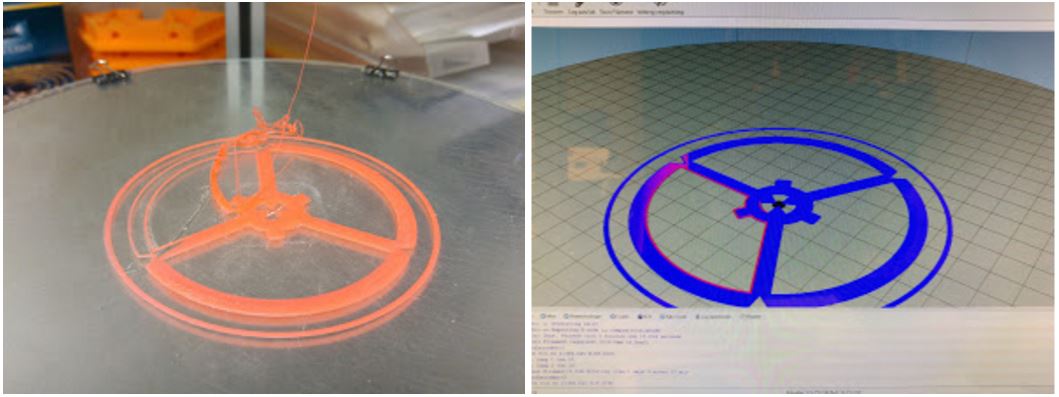

I also resliced the cal ring, and when printing it does not show the short head to bed move at x0 y0 anymore. But the shifting problem is still there. In this case there is an obvious lifting too, so not just horizontal shifting.
https://youtu.be/Ra1XzrKdtOU
If I put these pictues next to eachother, it gets clear where the problem starts (compare print path in repetier to the actual layer being laid down)

I started the Calibration ring a second time, and filmed it. At 1.40 minutes you can see just as the loops are finished it starts the perimeter (very slow because I told him so), it immediately starts doing the air-dance again, without any hammering or hearing the motors skip or anything.
https://youtu.be/7tWISUYGF1g
I am curious as to why the symptoms are so different each time. The problem does not start at the same spots every time, not geometrical and not in time or in printing positions. I don't think it is the gcode (see previous post).
