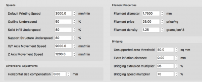

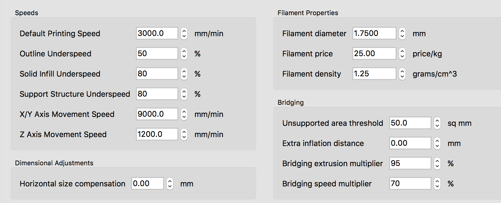

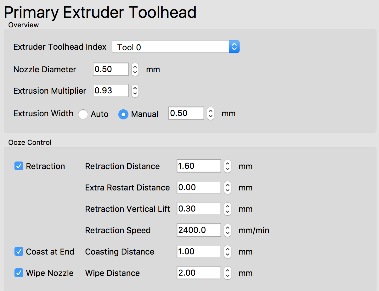

Hey everyone,
Since I have upgraded to the HE280 on my V2, I have had an issue with lots of stringing. I have tried tweaking my slicer settings but it seems that no matter what I do they are still there. I have attached some of my slicer settings below. I am printing with eSun Pla Pro. Their recommended temp is 205-225 but I have even lowered it to 195 and still get stringing. Any tips would be helpful.

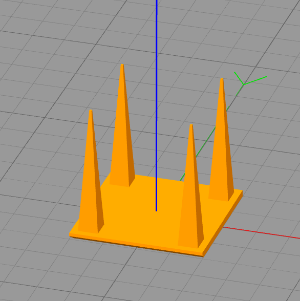

This is one of the tests I have tried to print and there are strings on all sides from top to bottom.

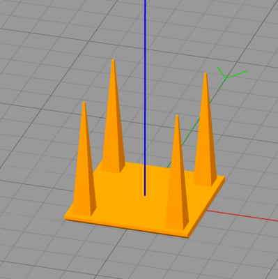

Retraction Vertical Lift, is that the Z height it moves when going between sections?
If so, I run that at 0, as well as 6mm retract and have 0 stringing, ever. The perimeters help to wipe the nozzle off.
After changing the Z hop setting (repetier host's name for it) to anything other than 0, i got stringing, everywhere. They werent big strings or anything, just spiderweb like, which are harder to get off than big ones (cause they just break).
Actually, correction. When doing a bridging test recently, I did get some minor stringing/ooze between the 2 towers.
In this case, it strings because there is no infill, so it does the perimeter and immediately moves to the other side, not giving itself anywhere to wipe any bit of ooze off.

6mm retracts on the HE280 and PLA is a recipe for disaster. It may work for a short time, but will eventually jam the hot end. For the purposes of retraction, the HE280 should be treated like an all-metal E3D.
Try moving your Z-lift to 4mm. Also make sure you set your Z axis speed to 200mm/sec. Set the retraction speed to about 35mm/sec.

Start with 1mm @ 20mm/s.
I would not exceed 2mm.
