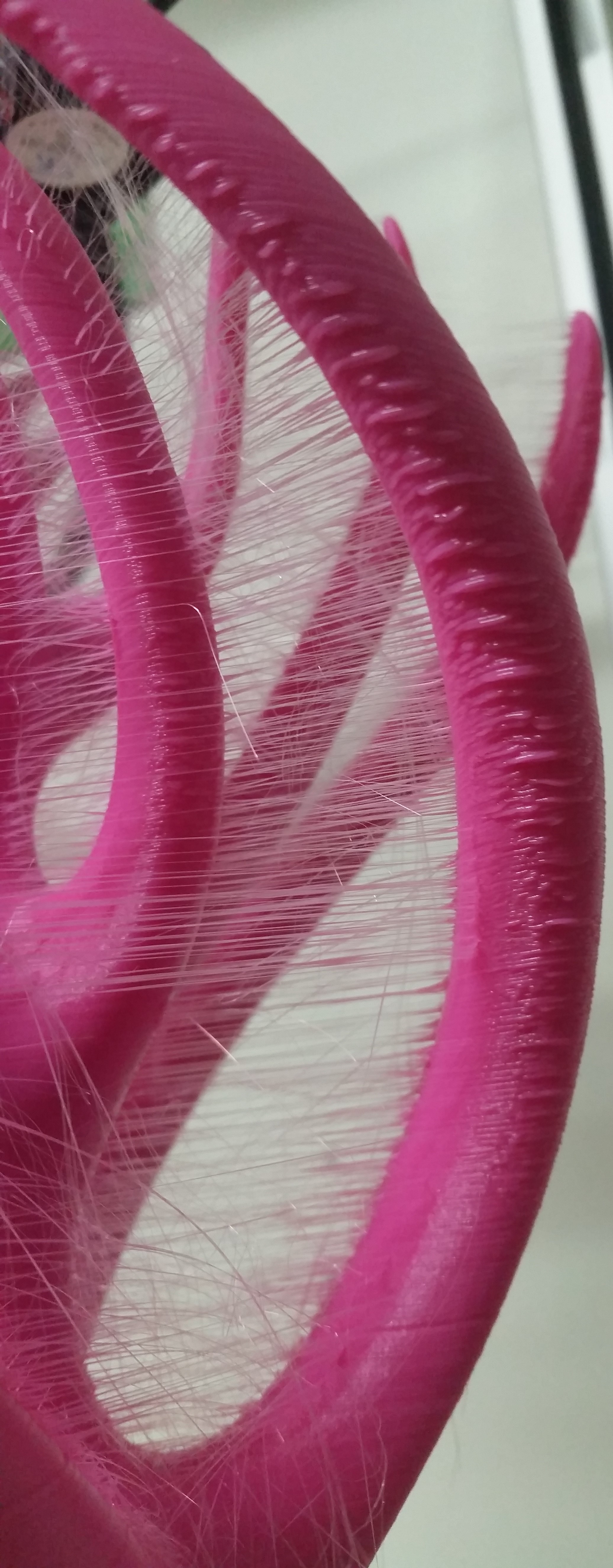

Hello everyone,
I just finished printing a pretty large "tree" and it came out ok, minus tons of stringing and misaligned layers on the underside (no supports used). My question is, how would you go about cleaning up the mess? I'll use a scalpel for the strings, but for the wavy bottom side, what is a good method? Sand and XTC-3d? I'm open to ideas.

I have a bit of experience with XTC-3D... It's great stuff, but more intended to fill in striations between print layers, smoothing out your print (it's pretty runny, so it really can't do more than that). If you go that route, be mindful of pooling in depressions and at the bottom of your print. For armor pieces I've done, I usually prepare the print by giving it a rough sanding, then hit it with XTC (more sanding), then hit it with automotive primer (and a final sanding) prior to painting. This is time consuming, but the finished result looks awesome. Having said that - nothing cuts down more on post-processing more than a great base print... Have you played with your hot-end temperature and retraction settings? I'm no expert, but It looks to me like your printing too hot and/or don't have enough fan cooling. I usually print my PLA at around 200c (+/- based on the filament).

Thanks RichWP. I printed this particular piece at 210. I tried to go lower in 5 degree increments and when I got to 205, the filament started to break apart out of the nozzle so I had to turn it back up to 210. Fans were on 100%. I have my retraction distance set at 6mm (very high), vertical lift .30mm, retraction speed 110mm/s, coasting and wipe nozzle are both on as well, so I am clueless at this point. I asked S3d support and those were the settings they told me to try...and you see what I got with that.

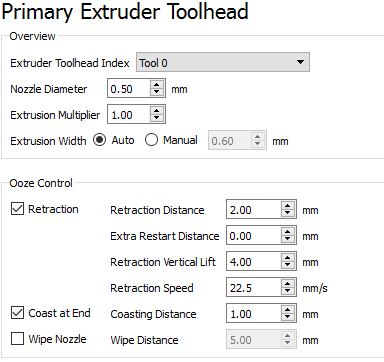

...are you simply ignoring what people have been telling you? I've seen more than reply stating that you need to treat the HE280 like an E3D v6. Small retract distances (~2mm), SLOW retracts (~25-40mm/sec) and ~4mm vertical lift, otherwise you're going to have a mess (or a jam) on your hands.
Below are my retraction settings for S3D and PLA....works great.
s3d pla settings.JPG (33.63 KiB) Viewed 16138 times

As RichWP says, XTC-3D are more for smoothing out your print. In your case, sand your part is probably the best option before the XTC-3D
But the key is to work on your printer/slicer settings. Because with less stringing and more beautiful surface it's always easier to do the finishing.

Re: Anyone know how to "clean up" rough prints?
I suspect their "factory" v3 settings are assuming the older, PEEK equipped hot end. That hot end could take really long and fast retracts without any problems since 98% of the filament path was PTFE tubing and didn't hit metal until the nozzle orifice itself.

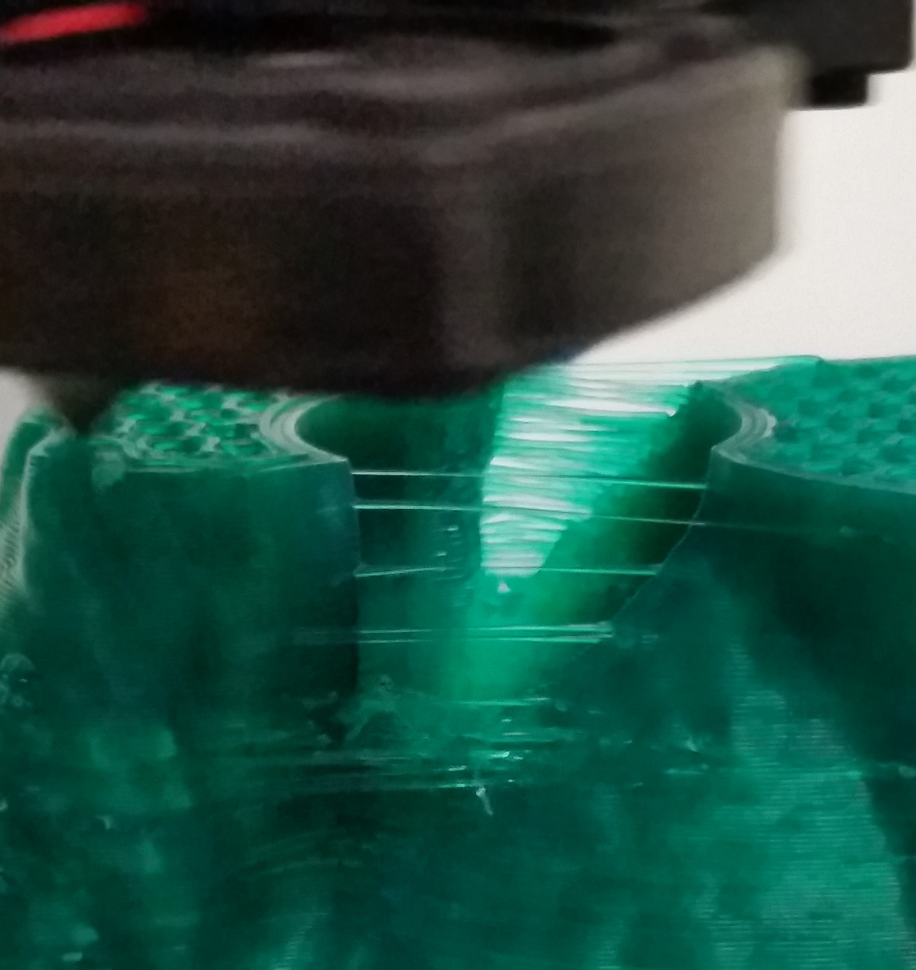

Geneb, this is using the EXACT numbers you posted. The stringing is still pretty bad. I'm thinking it might be something mechanical at this point, but I don't know what I should check.
Posts: 5359
Is that with a 4mm z-lift? Those strands look really thick - printing too hot maybe.
Your best object for dialing in retract is a cylinder. Print two at once and adjust until there's no strings between the two parts.

Post by skyjuice »
Yes, it's w/4mm Z lift. I'll try the cylinders now. I'm really starting to lose hope in this machine.
Posts: 5359
It's not the machine, it's the slicer settings.

I wish I had someone local here that could come and help me get this right. Like you said, I don't want aggressive settings that will destroy the filament. Do you have any other settings I should check? I set my multiplier like you had yours at 1.00, nozzle dia at 5.00 and extrusion width at .60.

Well, I just printed with Mattercontrol instead of S3d and so for there is absolutely ZERO stringing happening! Settings. You are correct gene

the ONLY setting I changed was the multiplier. I set mine to .95 and that seemed to do the trick. In s3d I had .95, but I probably had a messy formula with the rest of my settings. Try that.
