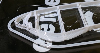

I just finished building a Rostock Max V3. I'm am new to 3d printing. I was thinking I had it dialed in fairly well.
Then I tried to print a 3dlabprint aircraft and I have voids in the print after a filament retract. I've spent all day tinkering with retract distance, extra distance, speeds and temps but I cant' get the void to close without having loads of strings and globbing.
A layer finishes at the trailing edge of the wing, retracts the filament and flies back to the leading edge. The PLA doesn't appear for the first 10 to 15mm of extrusion on the leading edge.
So, any tips on how to get the extruder to start on dime?
Anyone with a V2 or V3 able to print an aircraft? What settings did you use?
Also, is there any way to control the G-Code produced in the slicing? I would be good to have it work the perimeter then alternate through ribs, keeping all the retract hops short, and alternate back to the start again. You could almost avoid retracting if you did that.

Dewey, what do you have your retract distance, retract speed and hot end temp set to? One thing that's recommended with the HE280 hot end is keeping the retracts short and slow. A high and fast Z-lift is also beneficial (4mm/sec @ 250mm/sec).

I've tried a wide range of settings. The default started at:
Retract 2.5mm, Extra 0, Retract speed 100 -- that does the Retract Cubes test really well but doesn't do the wing well at all (major void after the long flyback).
I've tried(showing just the extremes, I did a sweep through the values):
Retract 1mm, Extra 0, Speed 100 -- stringy, still has the void
Retract 3mm, Extra 1.5mm, Speed 100 -- not stringy but blobby, still has the void
Retract 2.5mm, Extra 1.2mm, Speed 25 -- stringy and blobby
I tried temps 210, 215, and 220 (using PLA) - 220 looks a little glassy but other than that no change I noticed.
So would you recommend high and fast z-lift and a short, slow retract with a little extra un-retract?

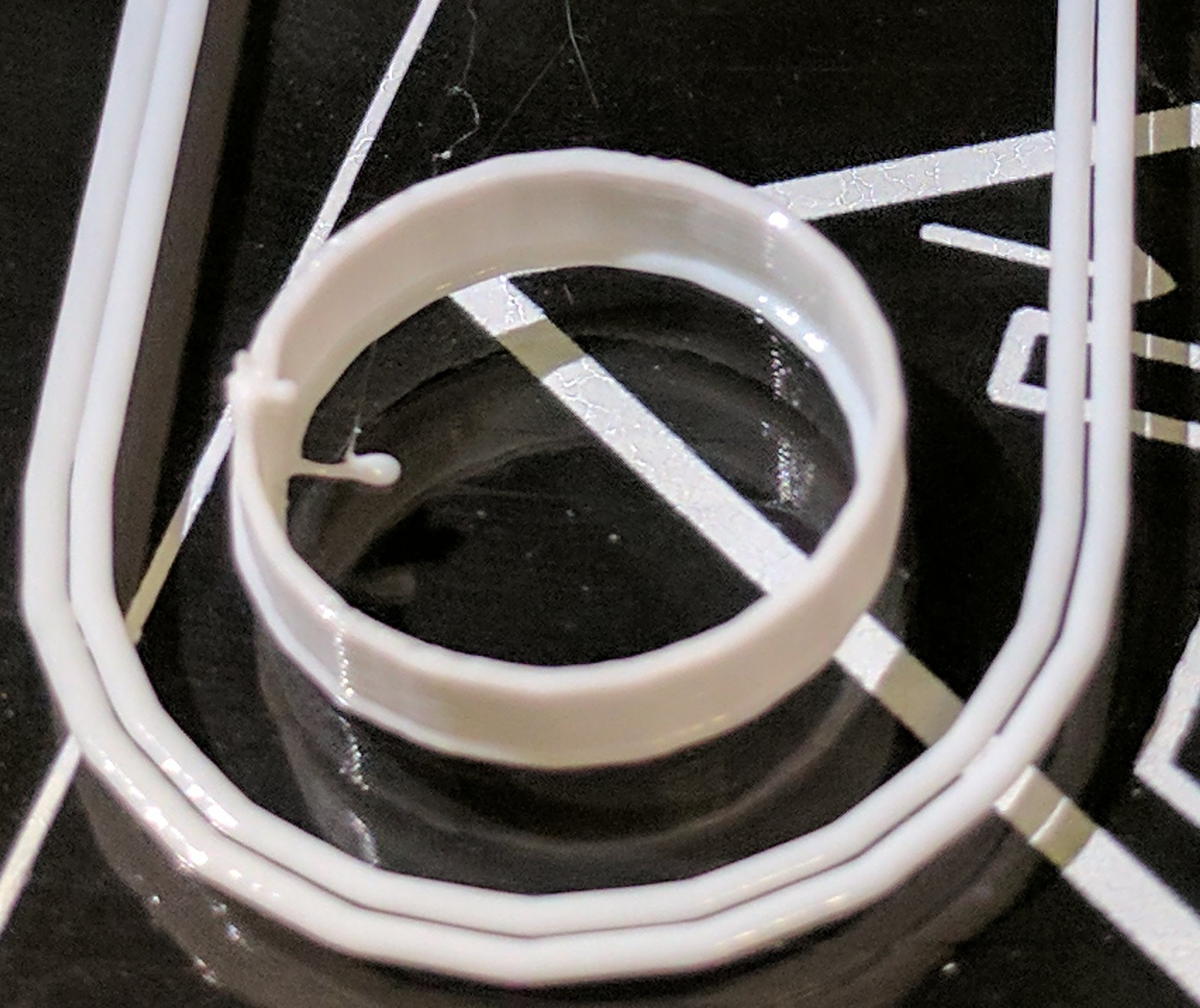

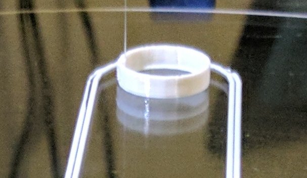

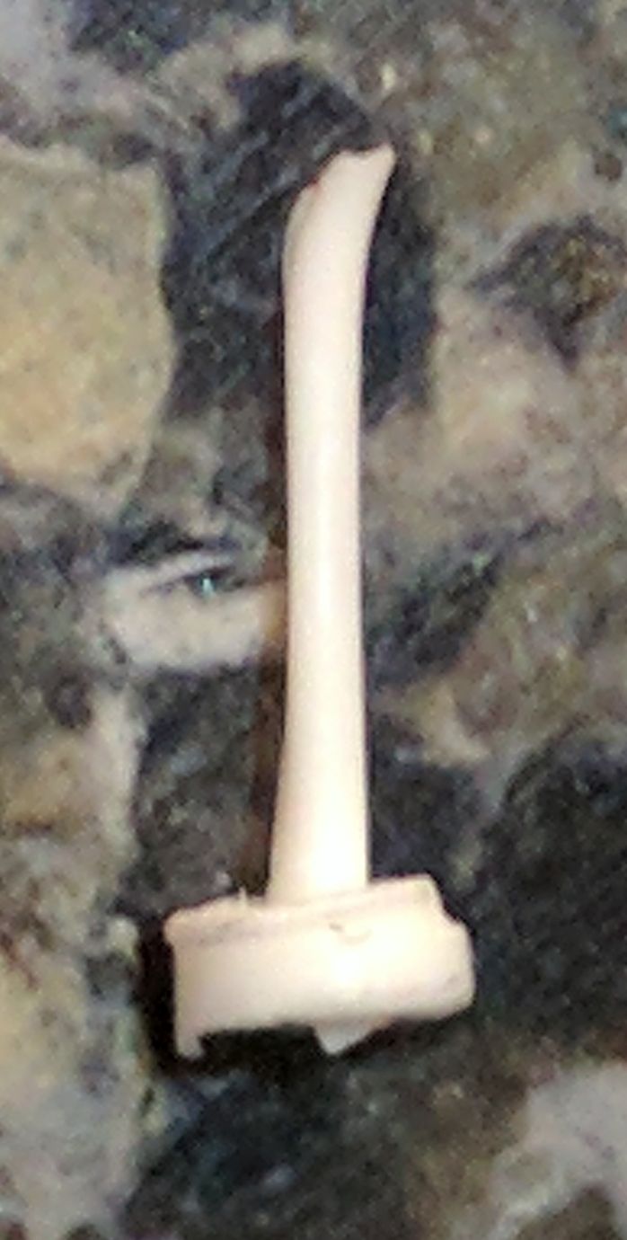

As an additional test (to save time and plastic) I created two cylinders 200mm apart and 15mm dia x 3mm tall (that re-creates LE to TE distance). Same settings as above. They look fairly good to me (the photos show the near and far cylinders). The only blobbing I'm getting is at the "fly in" point as it alternates between the cylinders. Could matter control have a bug in the g-code? This seems like something specific to the wing g-code.

I wondered if tool path ordering is contributing to this problem. So I rotated the wing 180 on the bed (guessing that would generate a very different tool path). The first 10 layers drew very differently and worked great. I thought I had it licked. Then it "reverted" to "fly off half way through the LE and fly back later" and it was messed up again. This is really strange. I wonder if the filament is binding when the arms are near the extreme edge of the table.

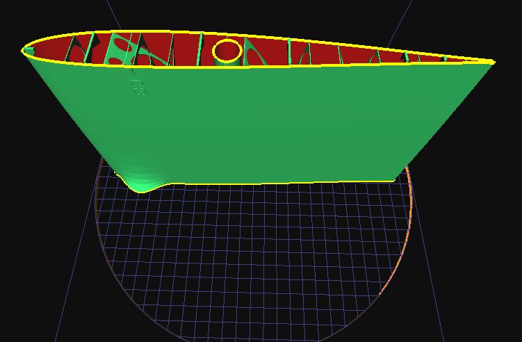

Here is what a mean; from Kisslicer it doesn't seem to know about the interior ribs/spars. When it generates the G-code it creates a segmented perimeter with loads of retracts on the filament and nothing on the interior. I can't figure out what I'm doing wrong.

If Kiss is omitting the ribs, I'd run the model through netfabb, it's probably bad geometry in the original model. Slicers vary a lot on how well they deal with various errors in the original mesh.
IMBoring25
Posts: 616
Re: Print 3dlabprint Airplanes and Rostock Max - any success?
Post by IMBoring25 »
Slicers also vary in how well they deal with extremely thin features. I don't know how thick the internal structure is, but it certainly could be thin enough to be problematic.
