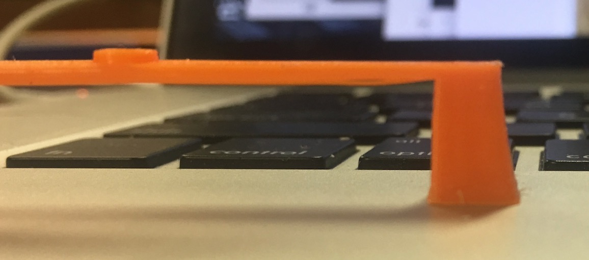

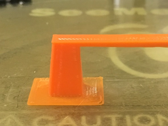

So, it's late and I'm kinda tired of working this out, so I thought I'd ask here for some help.
I've attached some pictures, but they don't show it very well since I couldn't get a good shot of it.
Basically, after a few layers the print evens out and stops shifting slightly to the X.
The easiest to see is in the bridge test: thingiverse link The towers angle in on all sides equally, yet it looks like it is straight up on one side.
I lowered the bed temp to 35 and did a retraction cube test (couldn't find a single cube on my laptop for some reason). This cube shows a wave in going back and forth actually.
(preview is swapping the images in preview, hopefully they are correct for real)
I've used many slicers and firmware versions, but it's been like this for a month now.
Rostock Max V2 w/ E3d V6
Hot end: 200-210
Bed: 35-65
Speed: 50-100mm/s
All give about the same results. So, I think it's missing steps or something. I've taken apart the machine a few times to try to check on the geared pullies on the motors and such, but it's not changed anything.
Heh, as I write this, I printed out a bridge test at 150% size and it's not nearly as bad looking. But it's really just the first 3 layers that shift in every print. Anyway, if you've every had to deal with this, I'd love some tips.
I'm currently printing out these to try to make my belt tension more consistent.

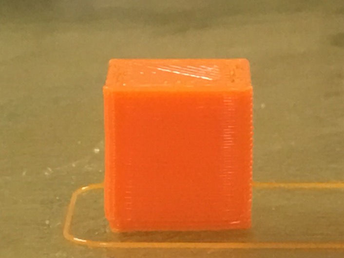

I am trying to print a simple calibration cube and am experiencing the same thing. After the first 4 layers the entire print shifts to the right, prints great, then the top 4 layers shift BACK to the original spot. Is it...leaning or something? Like maybe my bed isn't level to the floor and everything is sliding? Unlikely. If I figure it out I'll come back and let you know.

I think I figured it out. I was curious about belt tensions and tried looking up tension guidelines but couldn't find definitive rules to follow. One person said to make all the belts play the same tone, while another said to pull the belt with 6 pounds of force and get it to deflect between 1/8th and 1/2 inch.
So, I made them give a note, and used my thumb to measure tightness.
I guess I was too tight. After I printed the tensioners I mentioned I looked up those posts again and decided I would try it loose, pretty darn loose compared to before. And now no early shift in my bridge test. I'll test with some other models next to see if only that model is changed.

Nevermind. Still shifts the first few layers in the -X direction but only on the -X side of the model.

OK. I'm going to call this mostly solved. Now only the first layer is only ever-so-slightly off.
I was sitting here watching it fail yet again while sitting next to an old ramps board. The steppers have heat sinks on them. My rambo doesn't. It never did. For giggles I stopped the print, added some spare sinks with some thermal paste.
OK, so here's the question I have now. Why now? Is my rambo actually stressed almost to hell and these heat sinks are just a bandaid?
