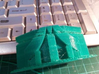

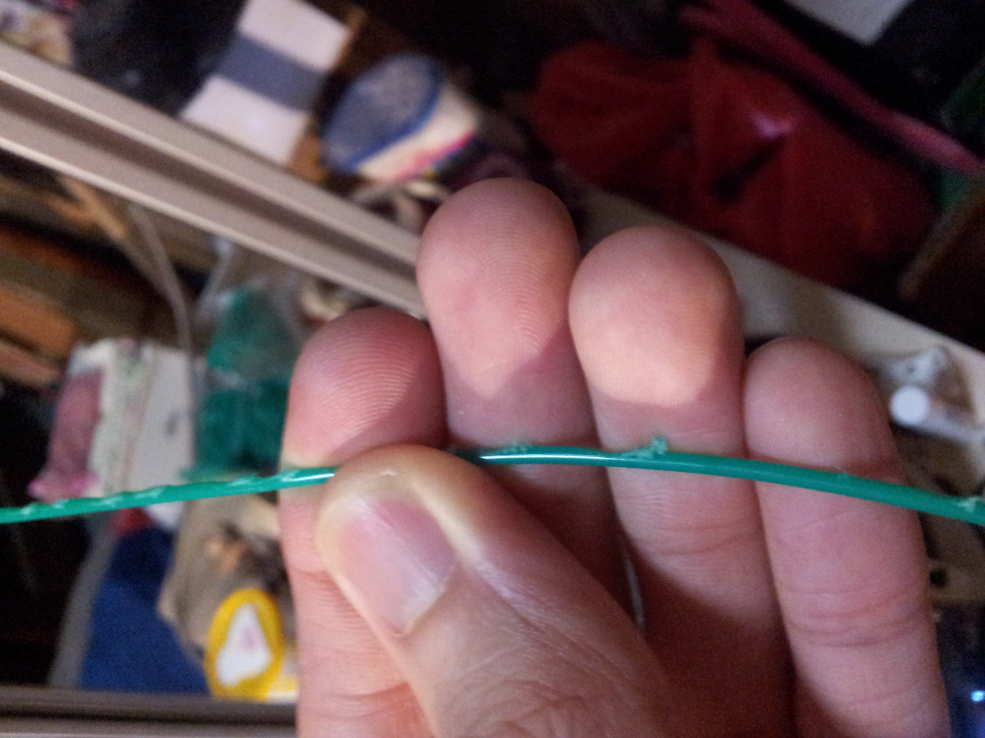

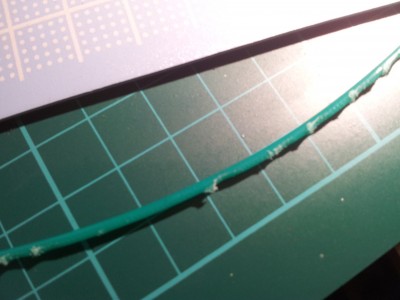

Rostock Max v2. At seemingly random intervals I get this issue where the hobbed gear grinds into PLA filament and forms large burrs. The larger burrs then get stuck in the 4mm Quick Connect PTC Fitting connectors. Once this starts happening on a print it tends to recur,the burr gets stuck on one or both of the PTC brass connectors, leading to the filament getting slowed down or stuck at the cold end too, causing even more burrs. The choke causes extremely under-extruded portions or even entire layers with nothing more than wisps of plastic in between. Occasionally, after a while, the burr gets pushed through and the print can resume, but with extremely weak layers in between, the part integrity is severely compromised.
In extreme cases the hobbed drive roller can even eat through so much filament that it simply cannot grip any more and the printer just airprints the rest of the job, or the part becomes so weak it snaps from just the movement of the hot end. Other times the shredded filament bits get forced into the bowden tube and contribute to the jam near the PTC connectors.
At first I tried cleaning the hobbed roller but the amount of shredded filament around it is quite little, if anything most of the shreds drop into the bowden tube anyway.

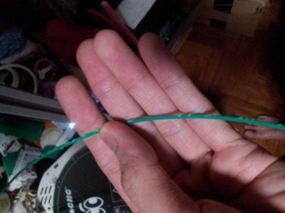

If it was just 1 or 2 burrs it probably wouldn't be an issue but once it starts happening the frequency rapidly rises, practically the entire length of filament is covered in burrs.
Huge burr. The thickness is easily 2mm if not 2.5mm.
Part ruined due to underextrusion from burr. First, small parts start being underextruded. Then entire layers become wisps of plastic. Finally the part simply broke due to not enough strength.

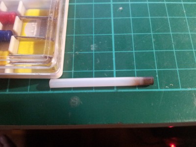

I am using a V2, with the EZstruder instead of EZR. The hot end is using the older PTFE liner and PEEK section. I did dig the PTFE out today and the bottom portion(around 1cm or so) was somewhat burnt, covered in soot and/or discoloured, and some melted filament in there but otherwise there wasn't any filament stuck under the liner itself. How do you ensure the liner is properly seated? Could it be the case that 230 is too high for PLA?
Re: Hobbed Drive Roller Causing Rose Thorn Filament, Failed Prints
And that's your problem. :) When PTFE is over-temped for a long period of time, it will shrink. What's happening is that the interior diameter of the tubing has shrunk, and is now making the extruder work very hard to push through that restriction. Just replace the PTFE tubing and you'll be fine.
230C is WAY too hot for typical PLA material. 230 is more commonly seen with ABS. At 230C, PLA should practically pour out of the hot end like water.
