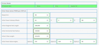

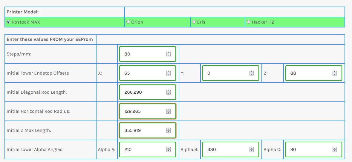

I'm trying to use the Delta Calibration wizard with my printer. It's a bit of a mixed bag, Version 1 with early version 2 arms, rail power supply, and HE280.
I messed around a bit in the firmware with getting the lengths to match the old style cheep skates it has.
The G-code for probing runs the first point fine, but after that it gives me this error:
10:28:52.666 : Error:Apos x square
10:28:52.670 : Warning:Invalid delta coordinate - move ignored x:9334 y:5812 z:800
10:28:52.670 : Warning:in queueDeltaMove to calculateDeltaSubSegments returns error.
10:28:52.674 : Warning:executeGCode / queueDeltaMove returns error
Here are my EEPROM initial values:
Delta Calibration Wizard Issue
