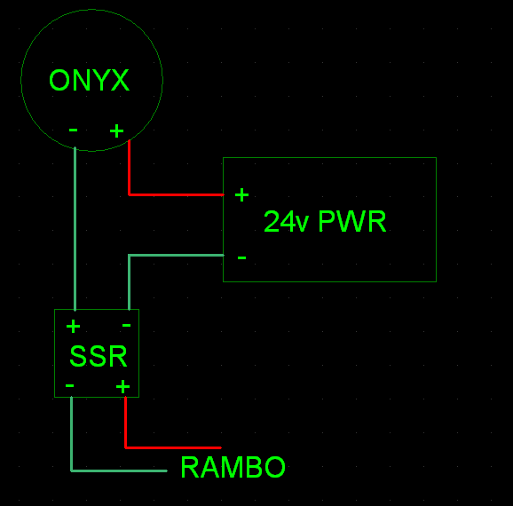

Since this much heat (500W) could start a fire I chose to spend the extra $$$ on the Crydom from Digikey. I also built a safety circuit using a normally open 24V relay and thermal fuses. The circuit is below. I run 24V through a chain of 150C thermal fuses to power the NO safety relay coil. If any of the fuses blow due to an over-temp then the relay shuts off and opens the circuit to the SSR and bed. I sleep MUCH better knowing there are thermal fuses on the bed (two on the bed in series) and one on the SSR. I used Permatex Ultra-Copper high temperature silicone to glue the thermal fuses in place.
http://www.digikey.com
Thermal fuse: 317-1136-ND
Safety relay: PB1012-ND
SSR: CC2158-ND
The SSR can go on the 'high' or 'low' side and I chose the 'high' side. It isn't supposed to matter which side you use, but with cheap imitation SSRs out there they may not like one type and fail. I also added a 1k-ohm resister between the control inputs on the SSR to make sure the input is pulled low when the RAMBO signal is off. This may be overkill but it doesn't hurt.
I also found that the switching speed of the RAMBO to the heated bed is very fast, about 2 kilohertz. The Crydom just barely reaches this speed even though the rated frequency is 0.9 kilohertz. It works for me using the stock RAMBO firmware, but it may not work well on other brands of SSRs. I agree that bang-bang would be the place to start with other brands of SSRs.
[img]https://c1.staticflickr.com/3/2892/33475126631_62589bde2b.jpg[/img]
