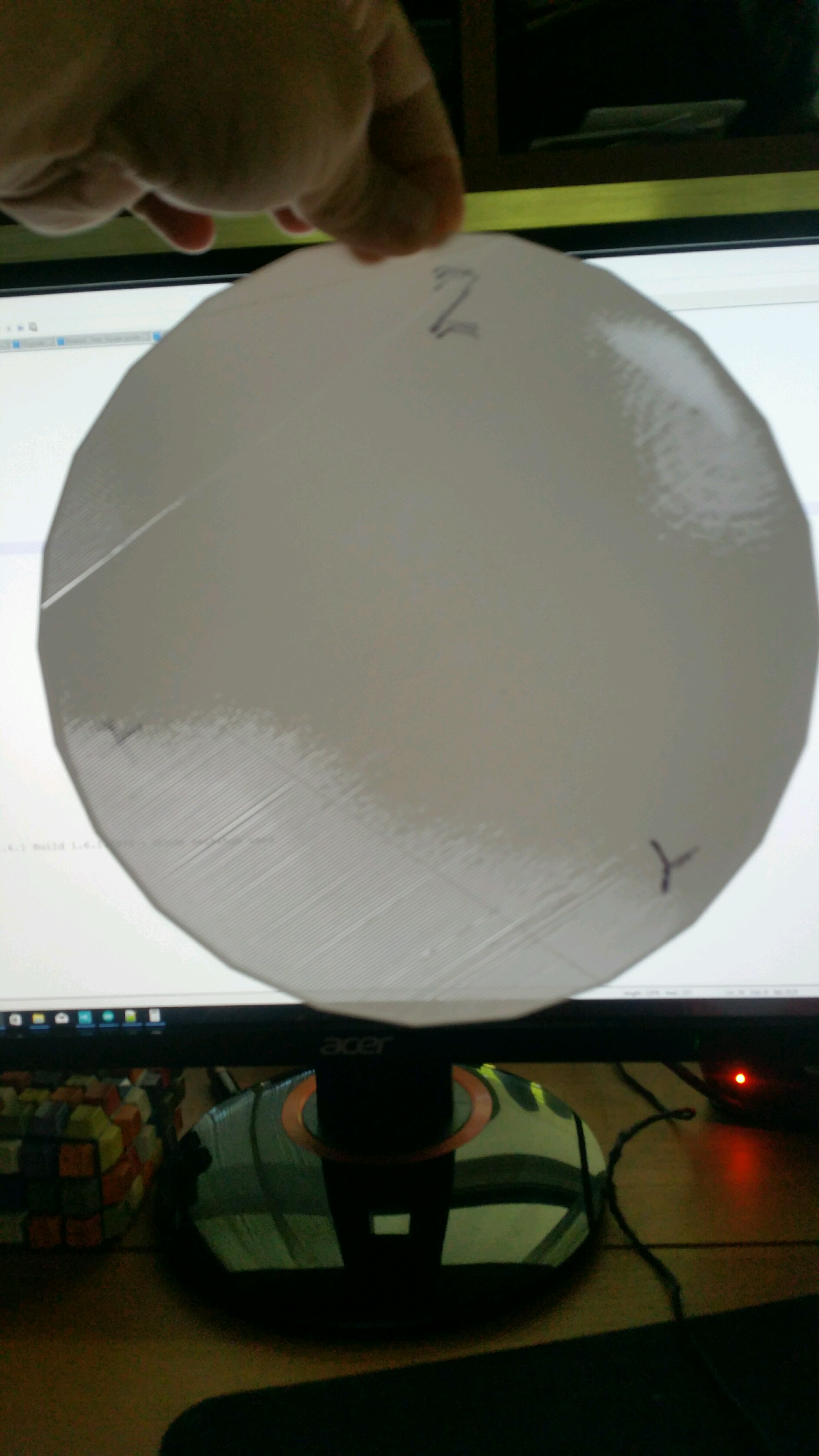

Hello
I have a Rostock Max V3 that i finally finished building. I have been struggling to get it calibrated. I have used the G29 command in conjunction with both the https://www.seemecnc.com/pages/delta-calibration-wizard and / or http://www.escher3d.com/pages/wizards/wizarddelta.php. This however never seems to end with a proper calibration. I seem to be level at the 3 tower locations as well as bed center, but all 3 spots opposite of each tower are high. I have checked numerous items on my printer by disassembling and reassembling but I have yet to find the reason I get high spots between towers but level at each tower and bed center. I've made sure towers are as square as i can make them. What makes it seem odd is the glass seems to be more flush at each tower with the melamime, but seems to sit .5mm or higher than the melamine opposite of each tower yet the nozzle rides high here. The other odd item is my z tower always needs more off set than the x and y tower, currently after G29 command, the z tower is 130 and the Y tower is 0 and the x tower is 34. I have double checked multiple times that the towers are sitting fully seated and even checked the z tower switch but I can find no issues. I manually adjusted the z tower endstop screw to bring all the offsets within a few digits but after running G29, the high spots still remain. I have checked belts, tension, servo pullys for the belts, checked for missing teeth on the belts...everything I can think of. Can someone please advise what steps I should take next?

Well, shockingly filament jamming was the one issue I was actually able to solve. It ended up being that my bowden tube was not seated correctly and there was a huge puck of melted filament. The bowden tube was not going to seat correctly till I removed the puck. I ended up using the timskloss method http://forum.seemecnc.com/viewtopic.php?t=11457. Once that was corrected I was able to repeatedly print with no jams as low as 200degC. Before that, I couldn't print at anything less than 215 with out jamming. I have hardly any dust or shavings built up on the extruder gear either. I have my retractions set to 2mm and speed set to about 30 or 40mm with zero issue now since getting the tube seated correctly.
One other item I find odd, is when setting the Z height with the either the knob on the lcd screen, I have to do it multiple times till it is actually set correctly. Each iteration will seem to leave it too high after checking pinch, but it seems to take at least 2 to 3 iterations to have the perfect pinch on the paper. At one point I thought I might be losing steps, so I bumped up the current settings in firmware but this did not solve my calibration issue and only made the servos run hotter, so I set these back to standard settings. I then marked starting and stopping points on all 3 towers for 100mm travel. After running each tower down by 100mm, they were spot on. So no issue there.
One question though, what does Harblar mean by "I then checked the width of the washers under the spider plate. 4 were right at 4mm and 2 were right at 3.87. I spread the 4mm ones across from each other and put the spider plate and heatbed back on." ?

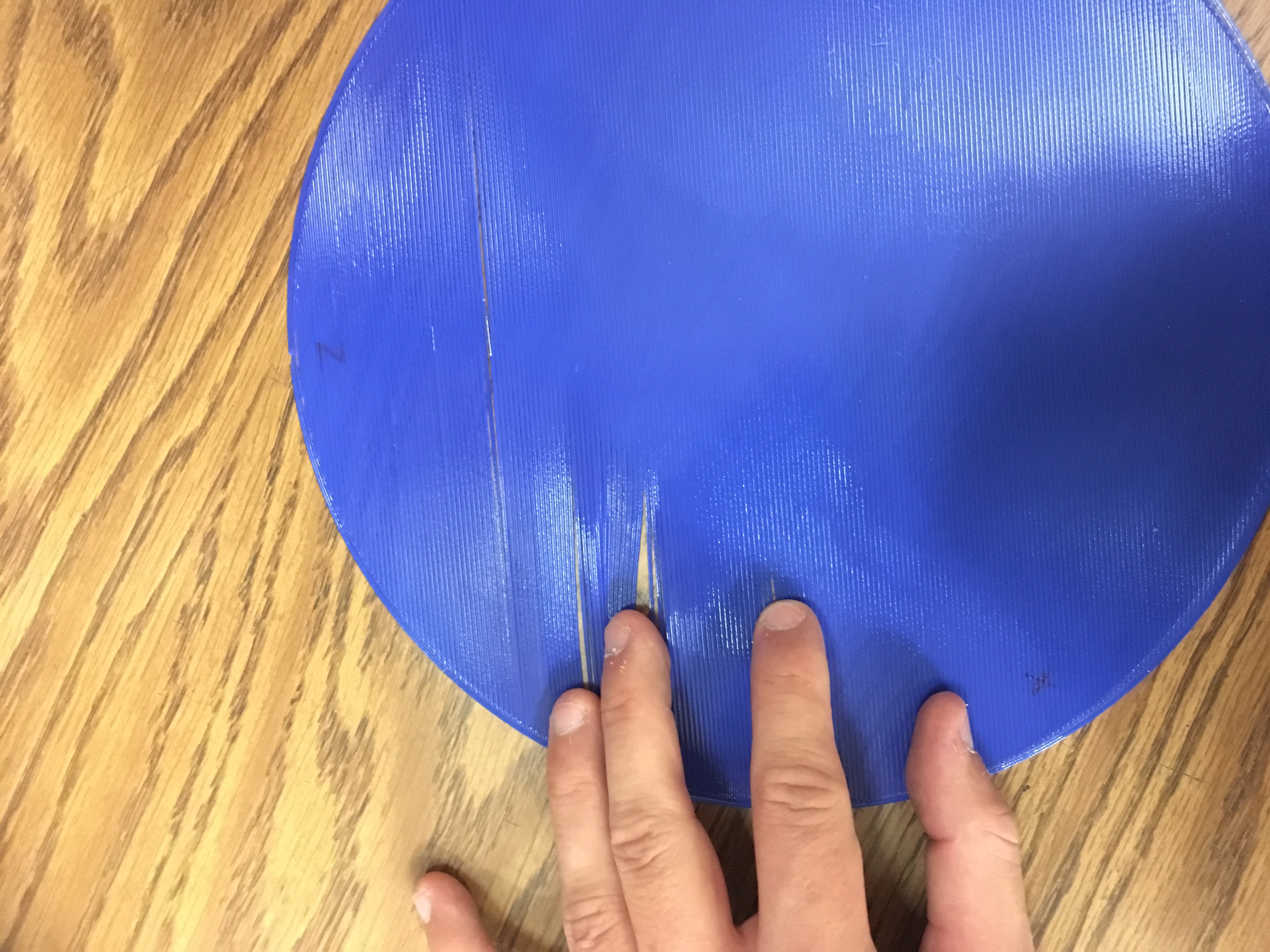

I have checked and rechecked the spacers that hold the insulator bed up and I always make sure the dimples / circles are facing down.
Ok, so some interesting developments though , I always thought it was odd that the z tower offset was always 130 points higher than the x / Y towers. I kept putting paper shims on the bed mounts on either side of the z tower till G29 produced a Z tower offset within 10 digits of the x / Y towers. Then I used the escher3d calibration tool. It came up with some weird negative offsets for the x and Y but I ran with it. My first test print showed various squished areas and high spots, so I began to adjust offsets in the eeprom. I adjusted back and forth when I finally became frustrated enough that I reran G29 while the bed / nozzle were still warm. The negative offsets were gone.After a small tweak to the X tower angle and a small adjustment to one of the endstops, the entire print looked to have fairly the same squish in all areas. Then, being tired, lazy and frustrated, I adjust the paper pinch test with the Z max height in the eeprom. I ran my test print and it was the first time I ever got it to print completely with no gaps or over squishes. But...after it got done with the first layer and went to print the next layer the nozzle jammed.........
. I am hoping I just have too much squish still and need to bring the nozzle up a hair. The odd thing is that the bed around the Z tower is shimmed so high now that it was hard to roll the blue clamps over the glass, yet the Z tower offset is close now to the X / Y. When I put a 6 inch level on the glass though, it is level front to back and left to right just like the top 2 melamine pieces. I cant help but think that something is warped somewhere or one of the towers are longer / shorter than the others.
Re: High spots between towers.
Well I got rid of my paper shims and ran the G29 calibration routine with the hotend and bed warmed up to operating temps, turning them off just before running the calibration of course. Then I even ran the least squares calibration with 10 points and 6 factors with the bed and hotend warmed up. This by far has made the biggest impact on getting me close to a good calibration. It seems I have a warped bed that gets worse once its warmed up to operating temps. I think I will take the bottom half of the printer apart and replace the bed insulator plate and take a good look at the 2 bottom melamine boards for warpage.

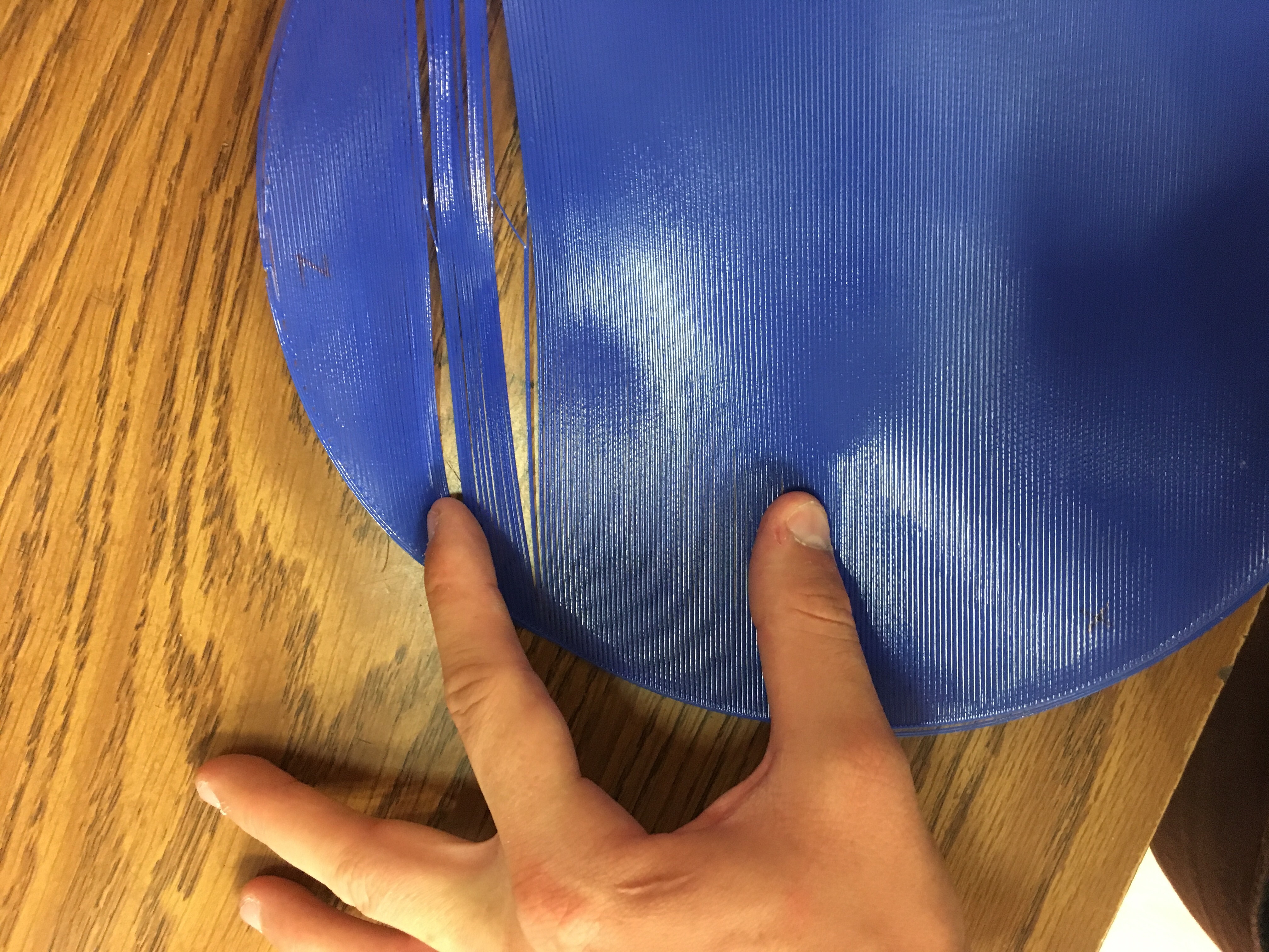

So, I have found by bed insulator to have some warpage to it and I have consistent high spots between my towers. I have a question though, when I run the calibration wizard, the z offset measured at the towers and center of the bed are always in the -.02 to .04 range, give or take, but at the points between the towers the z offset measured is always in the .30 +/- range. I never get below a .11 or so deviation. So today I tried randomly changing my delta rod length from 291.06 to 292, 293 ,294.06. When I got as high as 294.06 and ran G29 then the calibration wizard, low and behold, all the z offsets were pretty close to each other (-.02 to .04), at the towers and in between them. I was also able to get all the way down to .01 deviation when done. When doing the paper test at the outer perimeters, it had close to the same gap now as the center. Can anyone enlighten me on what exactly it is I have going one with this printer as far calibration?
Also, to add to my last post(if anyone is reading
). I reset my diagonal length to 291.06 and set my steps from 80 to 81 and was able to get a .02 deviation after one iteration of the delta wizard calibration using only 6 factors. So I guess I'm asking, does this info and my previous post shed any light on the actual issues is with my printer, because I know these 2 values are pretty much constant values? It's like there is some strange computational error with my printer.

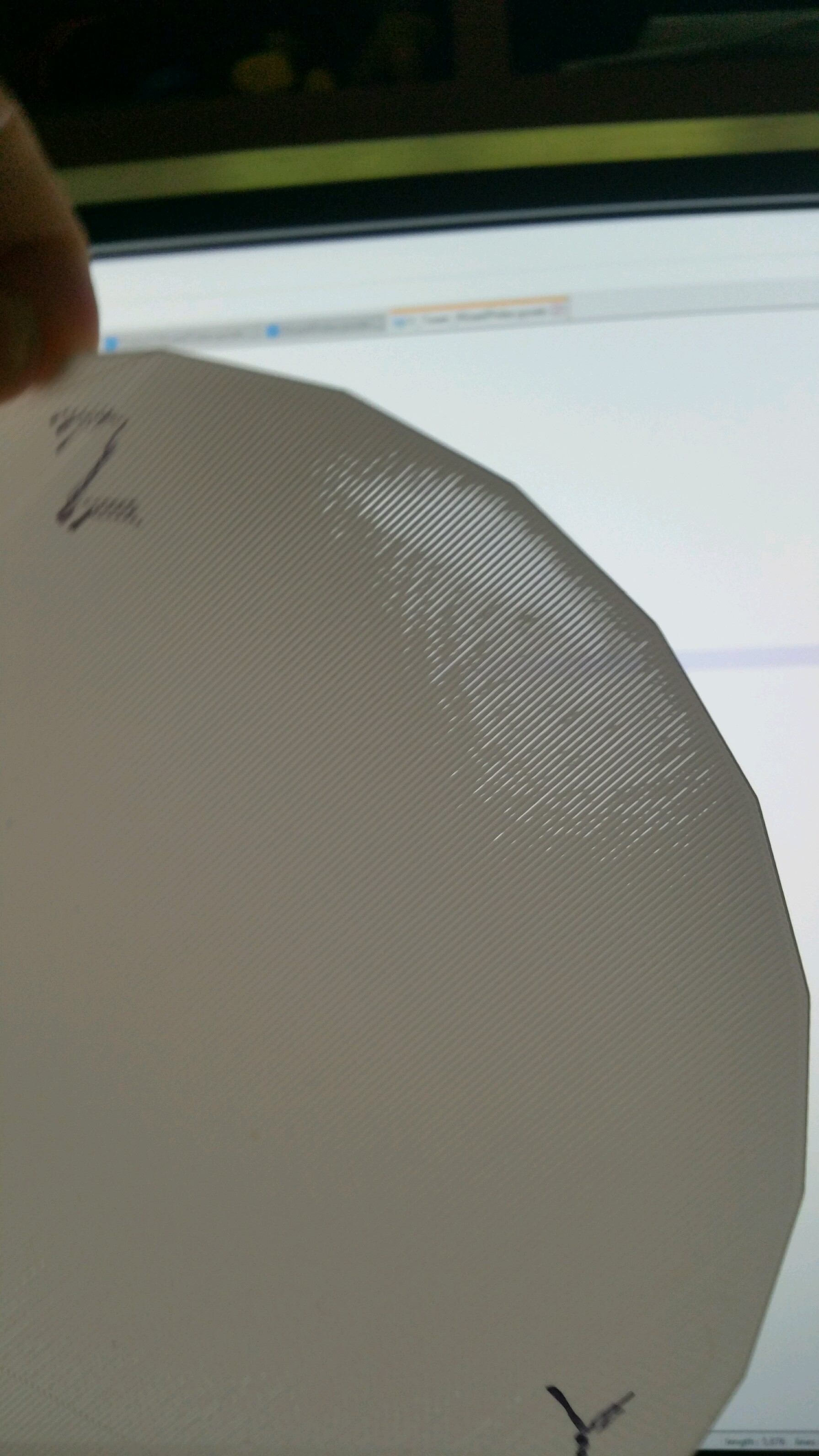

I look forward to seeing your dimension results. I was having roughly the same issue with my prints, so I took your advice and adjusted my setups/mm and when I arrived to 82.25 with a zprobe offset of -.2 my print was finally looking normal. I immediately printed a single layered 250mm disk and got these results... The print certainly looks level but between the x and z towers the lines didn't fuse together much. Did this happen to you ever?
I can see the rough spot, it looks to be an area on your glass that maybe wasn't clean enough. I've noticed when that happens the plastic tends to bubble up in that area due to bad adhesion to the glass. Not sure though. All in all, your test print looks really good from what I can see from the picture. A question though, I think I remember you from another post, weren't you just having an issue where you were too low just between the Y and Z tower at the outer perimeter but fine between the other towers? Seems like that would just be fixed with the proper tower rotation. either way I'm curious to compare dimensions between us for standard steps and poor calibration and modified steps and low deviation calibration. ***EDIT*** I see you updated your photos. That looks like your nozzle was too high in those areas.

*Sorry to piggyback off your post here, but I think this would be helpful to other people who may be having similar issues as us*
I agree that the nozzle is too high on that side, but now my issue is how to fix that without lowering the nozzle on the opposite side as well (causing my initial problem of the nozzle being to close to the bed near the y tower)
Are there any tips anyone can give about this problem?

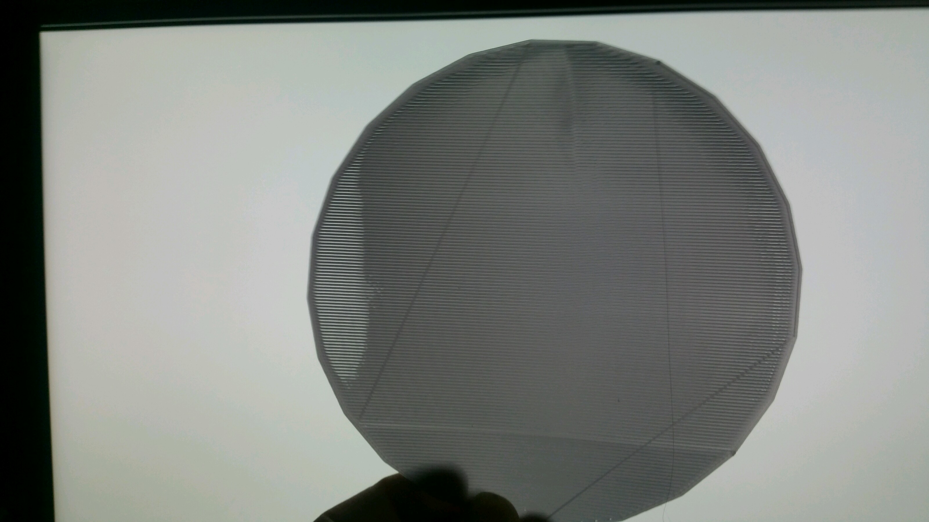

So, my measured 50mm test piece was 50.2mm give or take. So doing the calculations I ended up with a new 292.2 DR length. However this through off my deviation. So I slowly turned down my steps/mm till I ended up at 80.5 steps/mm. This gave me the lowest deviation(.02946) with my new DR length. I printed another test piece and I was getting around 50.08mm to 50.02mm. So I decided to try my full bed test print circle and it was a huge failure..... (See attachments). I had always thought I could see a little nozzle life going away from the X tower as opposed to approaching the x tower. I modified the Rostock probing code to test from bed center to incremental spots in a straight line to the X tower and back to the center through those same spots. This is what I was getting: -.01,-.03,-.02,-.02,.01,-.01,-.02,(first step heading away from X tower).20,.12,.06,.04,0,-.01. Sure enough, every time I test, the nozzle is lifting when it returns back and then gradually drops back to normal offset as it moves. I reset everything back to stock setting in firmware and after 3 iterations of G29, its still the same, so it has nothing to do with modified DR or steps. I will test all 3 towers, but I seem to have some backlash or something else wrong. Not sure what though. Also, I tested by cutting the distance to halfway to the x tower and returning. The lift seems to be greatly reduced but somewhat still there (-.01,-.01,.01,.01,.04,.06,.03,.01,0).
Well, checked belt tension and adjusted, checked pulley alignment and adjusted, tried higher current settings in firmware, ...no luck. I even swapped out the x tower servo since I had a spare from another project....no luck. Every time the z offset is fairly close from bed center to X tower ,then going from x tower back to bed center, it jumps up by as much as .12 and then settles back down by the time it gets to bed center. -.01,-.02,-.03,-.03,-.01,-.01,-.03,-.07,.15,.12,.08,.04,.02,0,0.
At a loss.....
