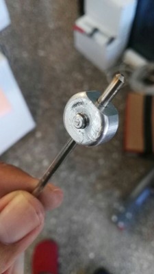

I've been fighting with this printer for over 5 weeks. I upgraded to the latest FW and tweaked settings, re-squared the towers and their distances, re-measured all the off-sets and dimensions, followed multiple calibration guides but I just can not get a good first layer. Today I set out to check all the delta arm joints and lo and behold... a bind of the tightest kind!
The actuall axle in one tower was rotating in the injection molded part! Once removed the carriage moves so much better, I'm amazed! It affected all carriages...
Anyway. I'm not sure if to upgrade the carriages to the injection molded ones (SKU: 70849) and the new ball cup arms (SKU: 70861) or if I should go with something else like TrickLasers carbon fiber rods? What else would I need if I went with carbon fiber rods? I have a V1 Rostock Max.
I cannot separete the U-joint from the axle so I have no other options I think. BTW, if I can get parts from Europe that would be a nice alternative as I live over here :lol:

I'd go with the injection molded carriages & ball-cup arms. I've got them on both my V1s. Works great.

For now I've sanded the plastic part that holds the axle in place with the 4 screws and loosend them a tiny bit. Now I can rotate it with just one finger instead of needing pliers, what a difference! So much better when doing the first layer. I need to redo all the calibrations (again, arg....) and I'll see how far I can get it for a good first layer.

In the end I just went and bought it from the shop. Seems to be stuck somewhere (hopefully on a plane :lol:). I dismantled the whole end effector and arms and found quite a few rough spots. Polished the rods, cleaned the U joints, sanded the end effector, losened some screws and I can now print in a much bigger area at the cost of platform stability.
